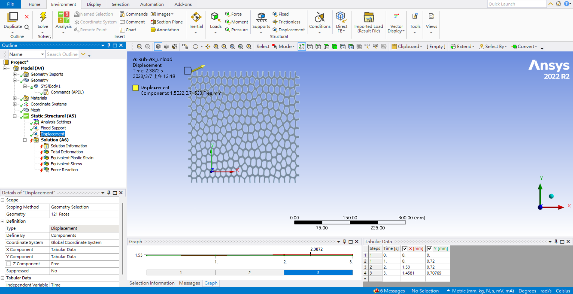

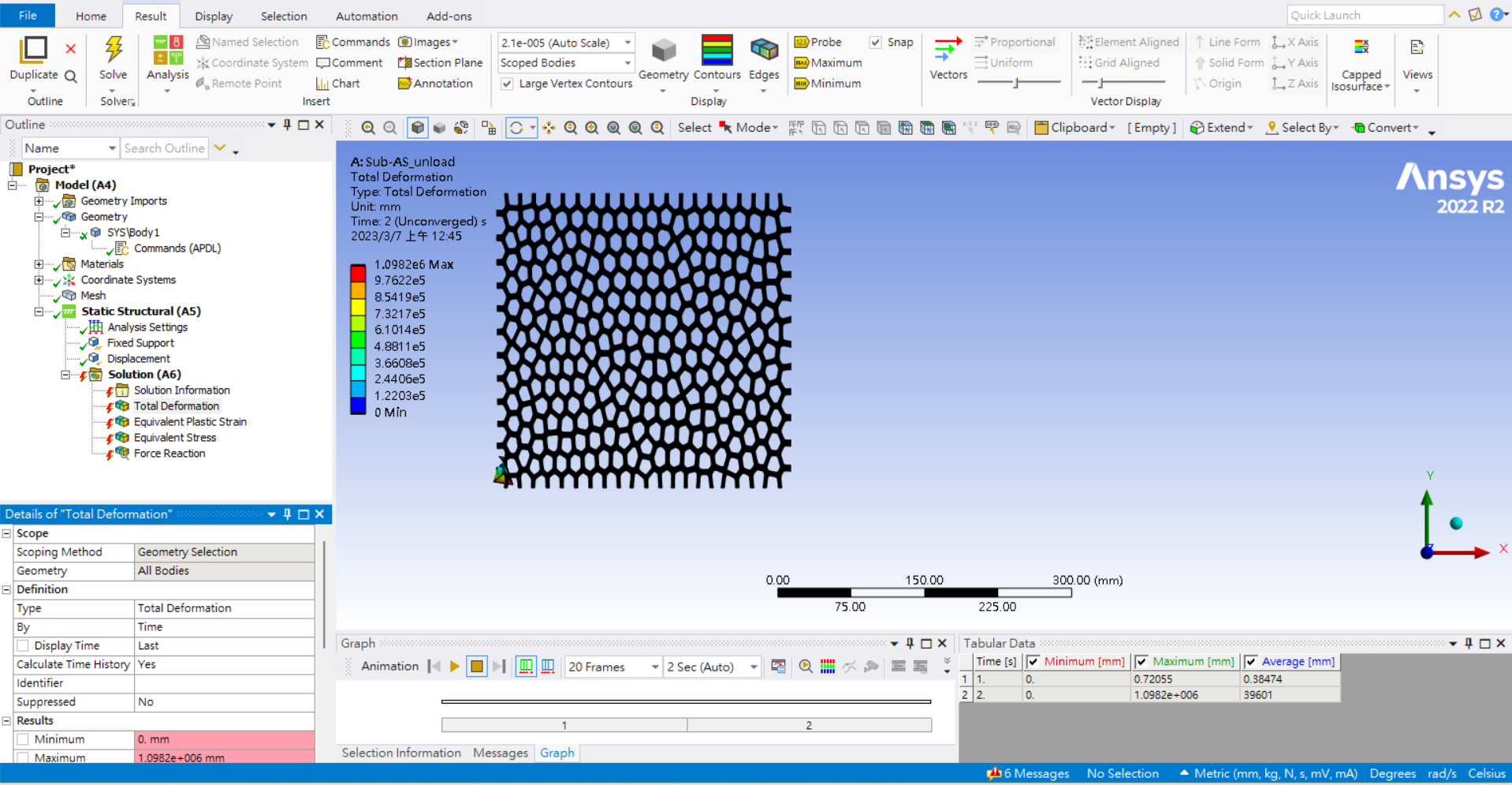

SubscriberHello, I'm trying to simulate a Voronoi honeycomb plate's static structual analysis, I setting the displacement control for top boundary and fixed support for bottom control, but my simulation occur the error "The value of UY at node 385110 is 1010041.81.  It is greater than the  Â
 current limit of 1000000 (which can be reset on the NCNV command).   Â
 This generally indicates rigid body motion as a result of an      Â

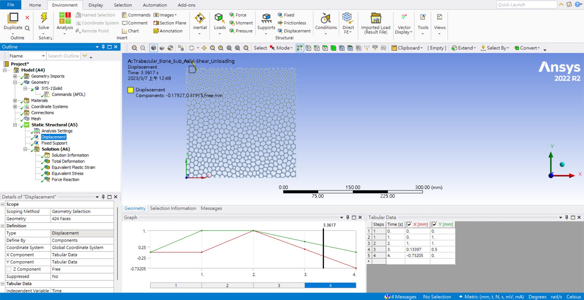

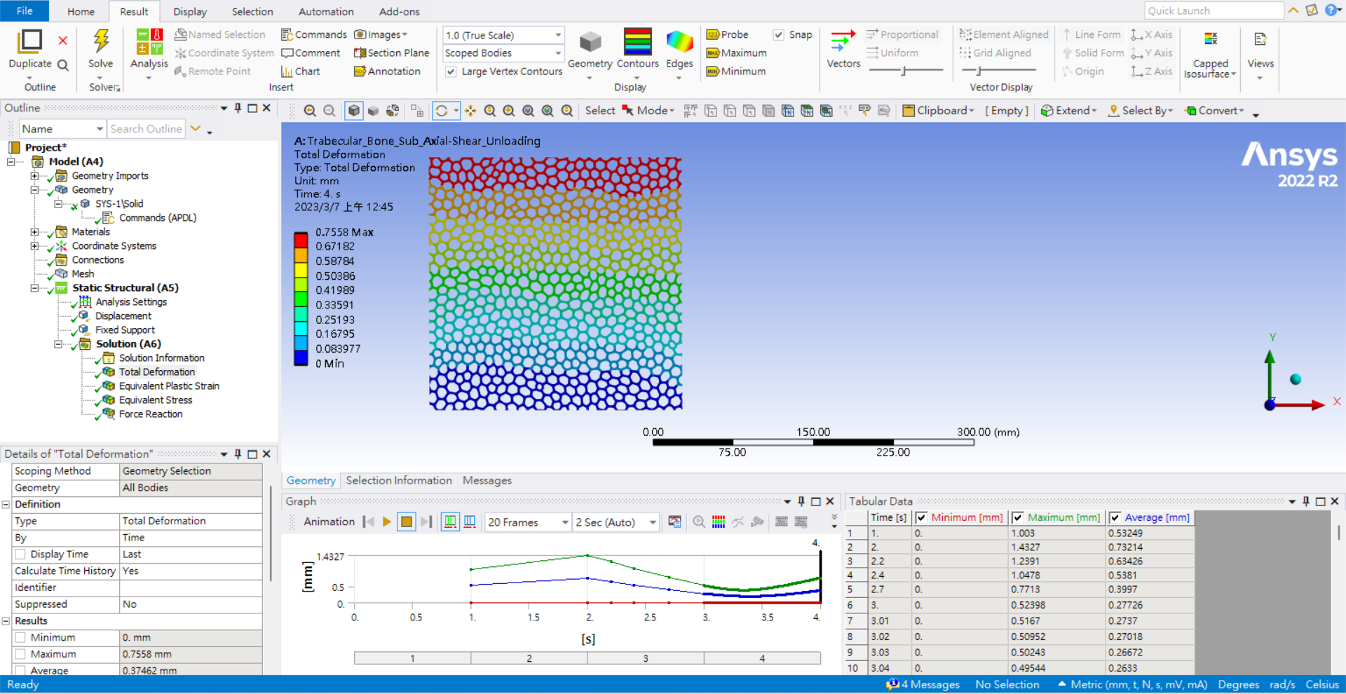

 unconstrained model.  Verify that your model is properly constrained."I have been refer another Voronoi honeycomb plate's simulation, it's not occur above error, the material of two simulations are same, I'm posting some pictures to represent the situation.
Kindly help me out with this issue, thanks.
