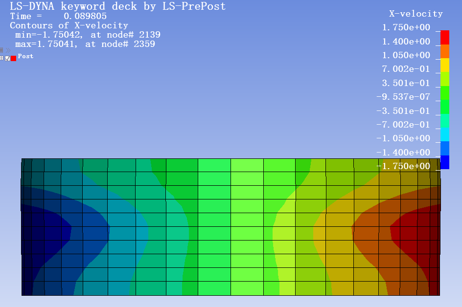

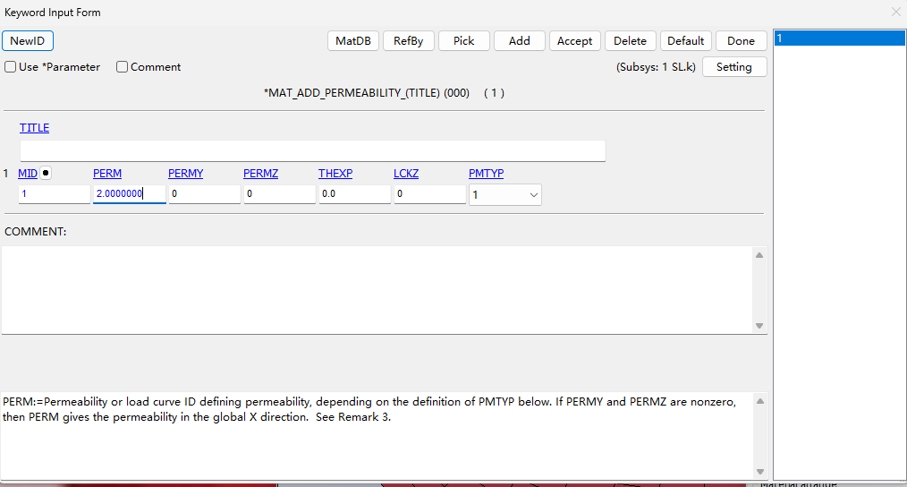

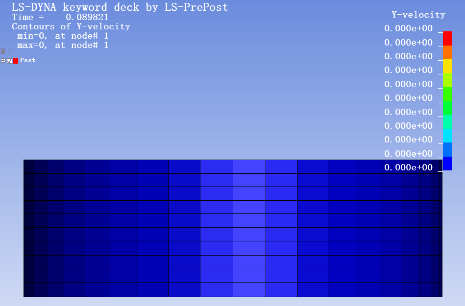

SubscriberHello, everyone. I am using MAT63 to model water seepage in porous media with the *MAT_ADD_PERMEABILITY keyword. According to the manual, this permeability model can incorporate a permeability vs. volume ratio curve. However, when I use a volume ratio dependent curve (PMTYP=1), the simulation yields no seepage velocity, and the pore pressure distribution does not obey Darcy's law. If I set a constant permeability (PMTYP=0), everything works fine.
Why might this happen? Is MAT63 not able to compute the volume ratio correctly, or am I misusing *ADD_PERMEABILITY?
Any insights or debugging advice would be greatly appreciated!

1819614500
SubscriberHi Ram,
Thank you for your reply. Your suggestions have been very helpful for my learning. The parts you mentioned should be properly set up, and I am able to view the pore pressure through the extra variables.
However, I encountered an issue when trying to use a variable permeability (e.g., PMTYP = 1, 2, 3). In this case, the pore pressure and seepage velocity becomes much lower than when using a constant permeability (almost three orders of magnitude)— even when the permeability curve keeps the value constant. Apart from changing the permeability type, all other keywords remain exactly the same.
I wonder if you have any insights into this phenomenon.
Regardless, thank you again for your reply.
