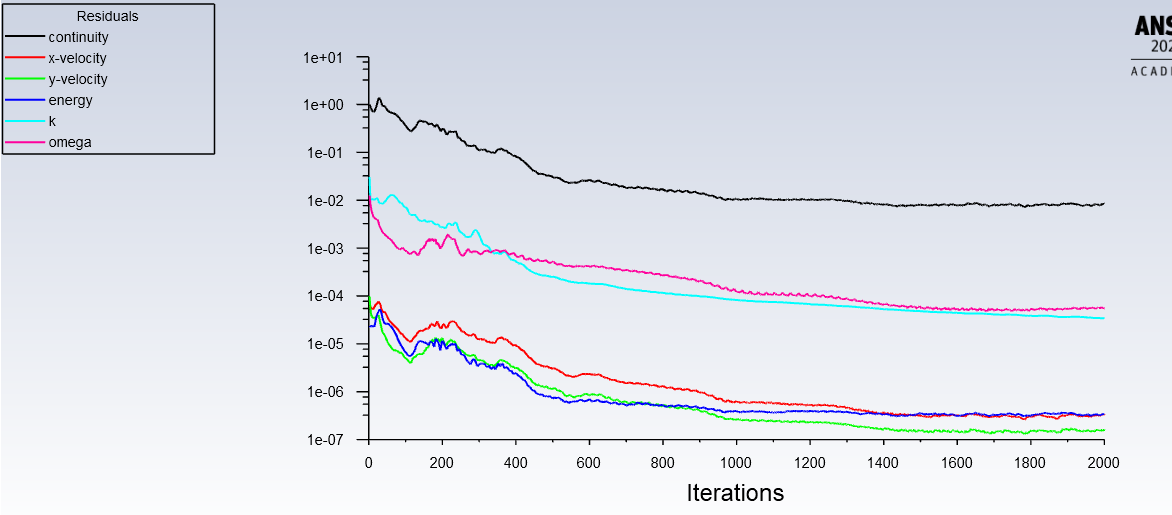

SubscriberHello ! Recently I've been trying to simulate a flow around a sphere in order to calculate all the aerodynamic coefficients. But my simulation isn't converging at all because my residuals aren't decreasing (picture below), and I can't seem to find the problem, so I was wondering if anyone can help me out.
May 24, 2021 at 8:21 amRob
Forum ModeratorFor Mach 0.9 I'd use the pressure based solver as it's much easier to converge. How does the velocity field look?

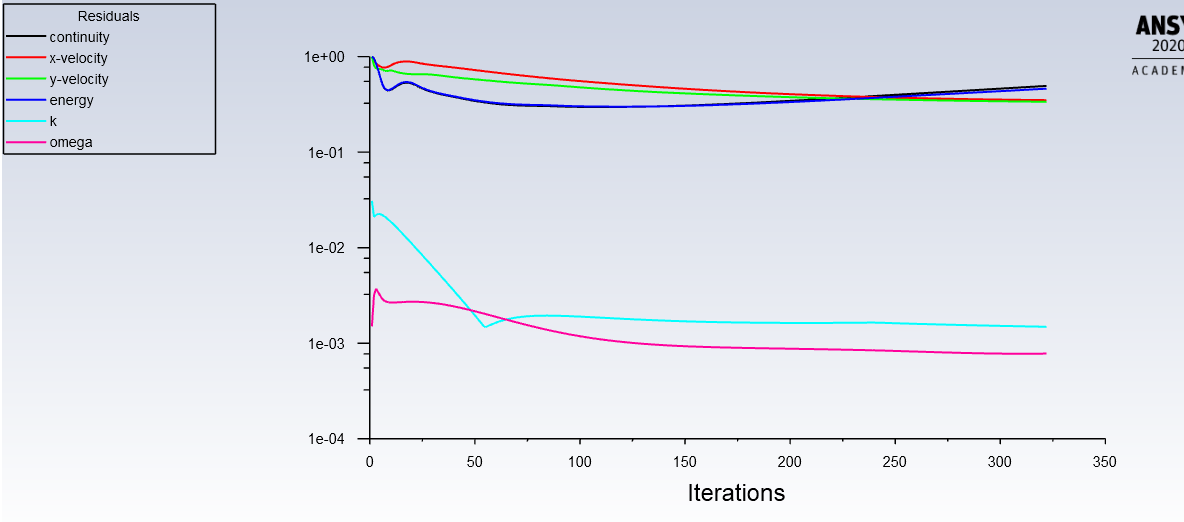

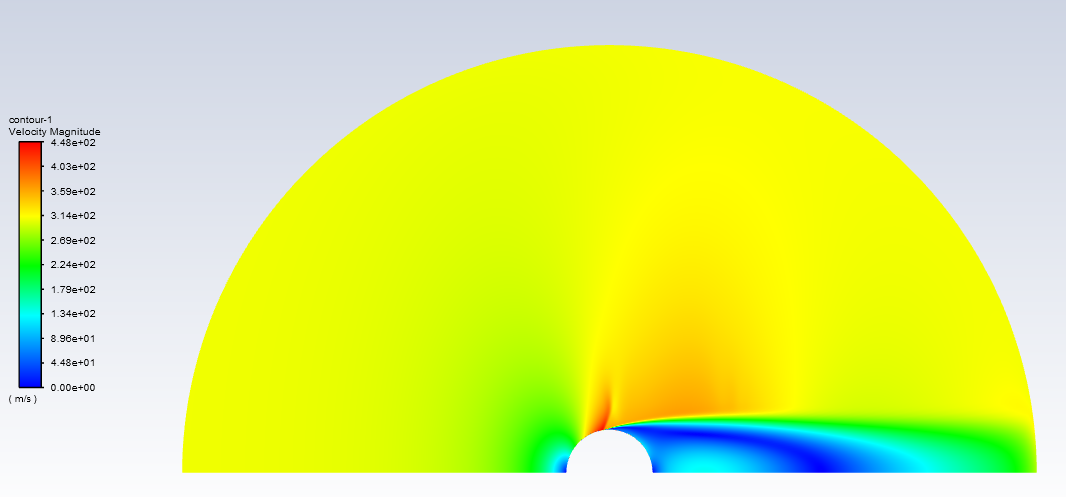

Thank you so much for answering my question, using the density based solver the velocity field doesn't look like much, so this morning I took your advice and ran a quick simulation using the pressure based solver the convergence is better but I don't believe it is sufficient , you will find below the screenshots of the residuals and the velocity field.
May 24, 2021 at 1:23 pmTouf_CFD
SubscriberAnother issue I forgot to mention is that the next step is to start supersonic simulations, is it possible to do so using the pressure based solver ? Thank you
May 24, 2021 at 1:34 pmRob
Forum ModeratorThat looks supersonic as it is: check as speed of sound in air is about 330m/s from memory. You will want a longer domain downstream to let the wake develop. In answer to the question, the pressure based solver is good to Mach 2-3 and using the pressure based coupled solver will go higher than that.

May 25, 2021 at 7:06 amaitor.amatriain
SubscriberIt seems strange that the problem is axisymmetric. You have a flow in the negative radial direction? If not, the problem is not axisymmetric
May 25, 2021 at 9:48 amRob
Forum ModeratorLooks OK, for axi-symmetric the axis is on y=0 The only bit that'll be missed is if the wake is unsteady as the oscillations won't be picked up as that's a 3d phenomena.
May 25, 2021 at 2:07 pmaitor.amatriain
SubscriberVelocity contour looks okay, but that is not an axisymmetric problem. It is a symmetric problem.
I also agree with the comment about the 3D model. In this particular problem 2D approach is reasonable for Re<10, specially taking into account the presence of shock waves.
In any case, I would increase the outer radius of the spherical shell even in the 2D model.
