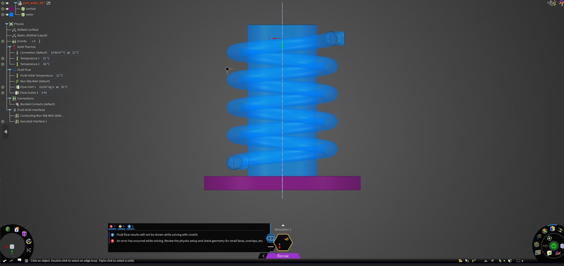

SubscriberHello, I hope you're doing well. I want to perform a CHT (Conjugate Heat Transfer) analysis. I've defined the solid and liquid regions. I've entered the inlet and outlet conditions and surface temperatures. However, I'm receiving the following warning. How can I fix this? Heat transfer cannot occur between the fluid and the solid with a hot surface.

Are you able to capture the geoemtry correctly? Make sure the fidelity is set correctly to capture the thin features if there are any in the geometry?
Fluids Simulation, Local fidelity|Ansys Course you can refer to this course. Let me know if this helps.

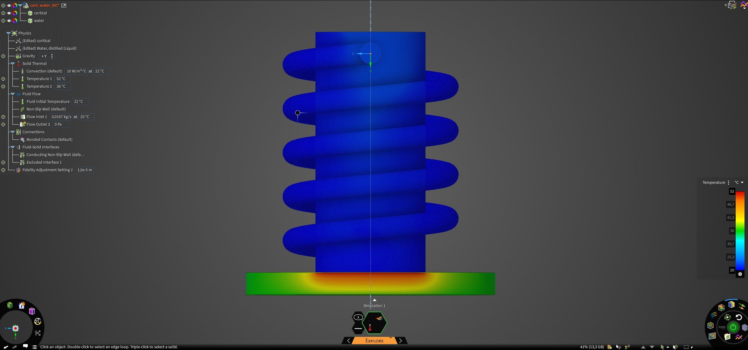

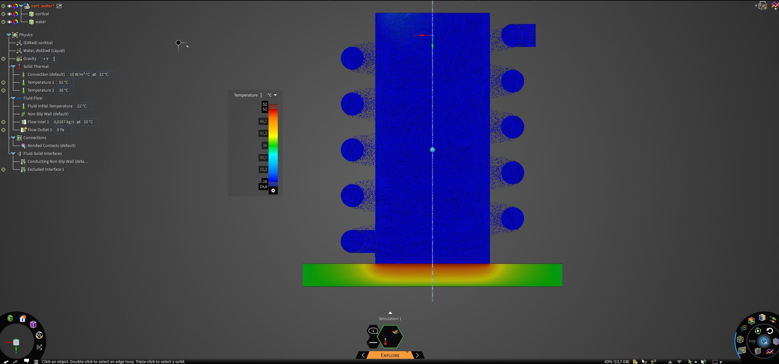

SubscriberI defined a local mesh between the fluid and solid surfaces. It had some effect; the heat transfer increased slightly. However, even with an RTX 5090 graphics card, I wasn't allowed to go down to very small values. I received a "GPU memory exceed..." warning. I realized it couldn't solve the problem because the geometry was too small. It seems like continuing with Fluent would be a better option.

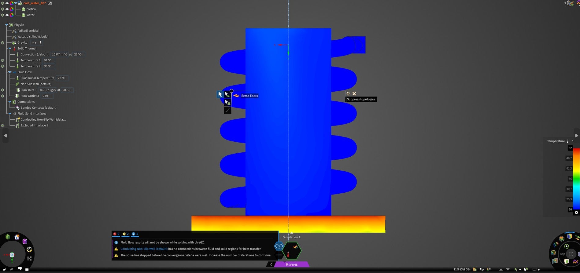

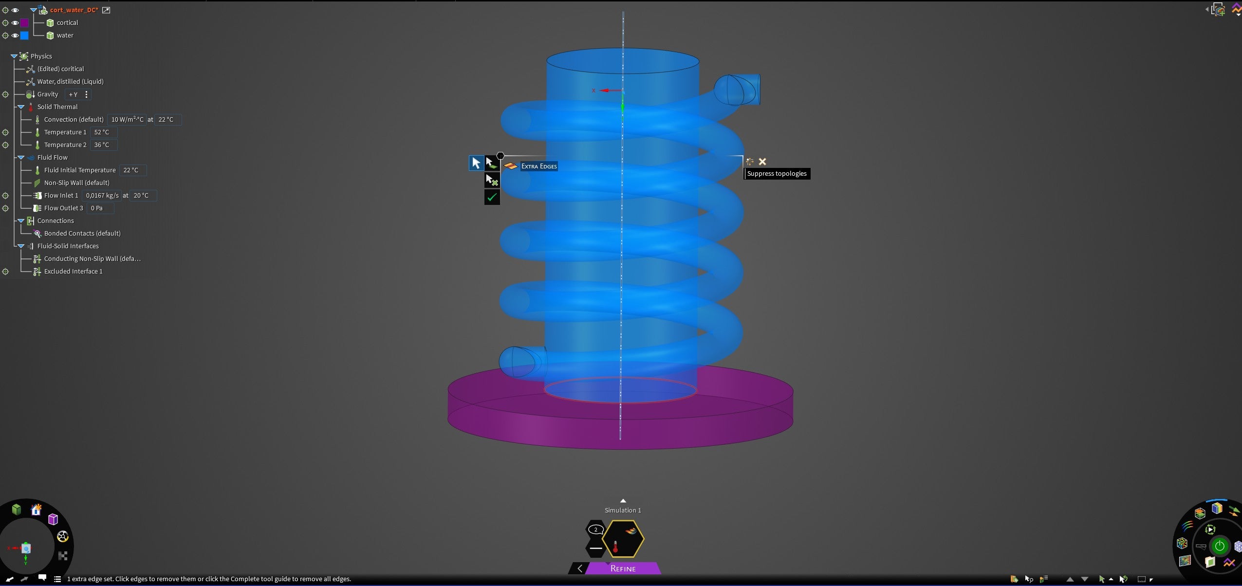

Forum ModeratorFrom what I can see the warning says there is no fluid solid interface. That can result in inaccuracy if not desired. You can check if the connections and interfaces are proper.
Also there is one excluded interface, can you try removing that and see if that helps.
