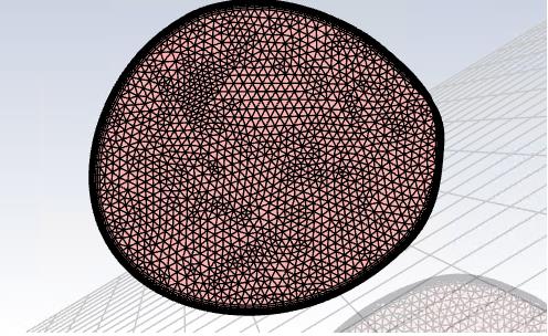

      1) The xy plane is displayed in the Fluent graphical interface, which is unconvenient when I want to save a picture - it obstures the body surfaces that Im interested

      Are you looking to hide the XY plane or are you talking about the shadows in Fluent GUI?

      "Are you looking to hide the XY plane or are you talking about the shadows in Fluent GUI?" - both

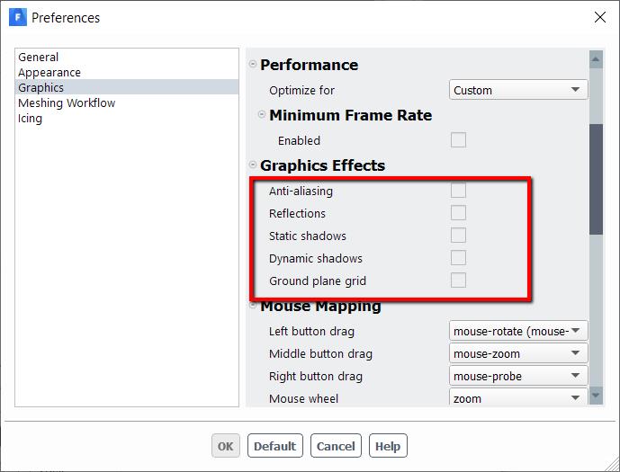

      To hide the XY plane, please use the 'Display' dialog box and turn off the 'XY plane' of interest.
      To change the shadows and other new GUI features, please go to 'File' -> 'Preferences' -> 'Graphics' and turn off the following options.
      If this answers your question, please mark this as 'Is Solution' so this might benefit others.
