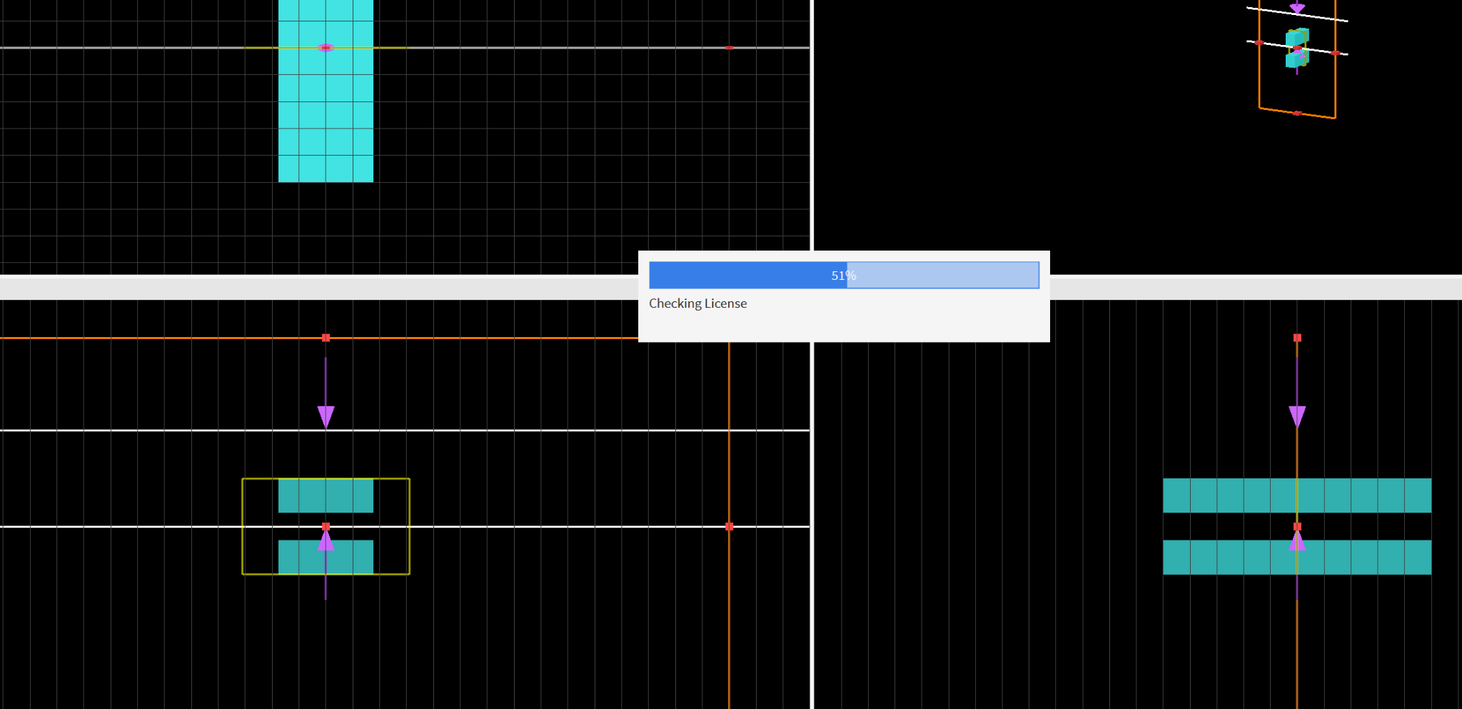

    • hammam.albustami
      I tried what you suggest but it seeams that the checking license every time the rcwa ran.
      How to overcome this issue ??
      Uploaded image

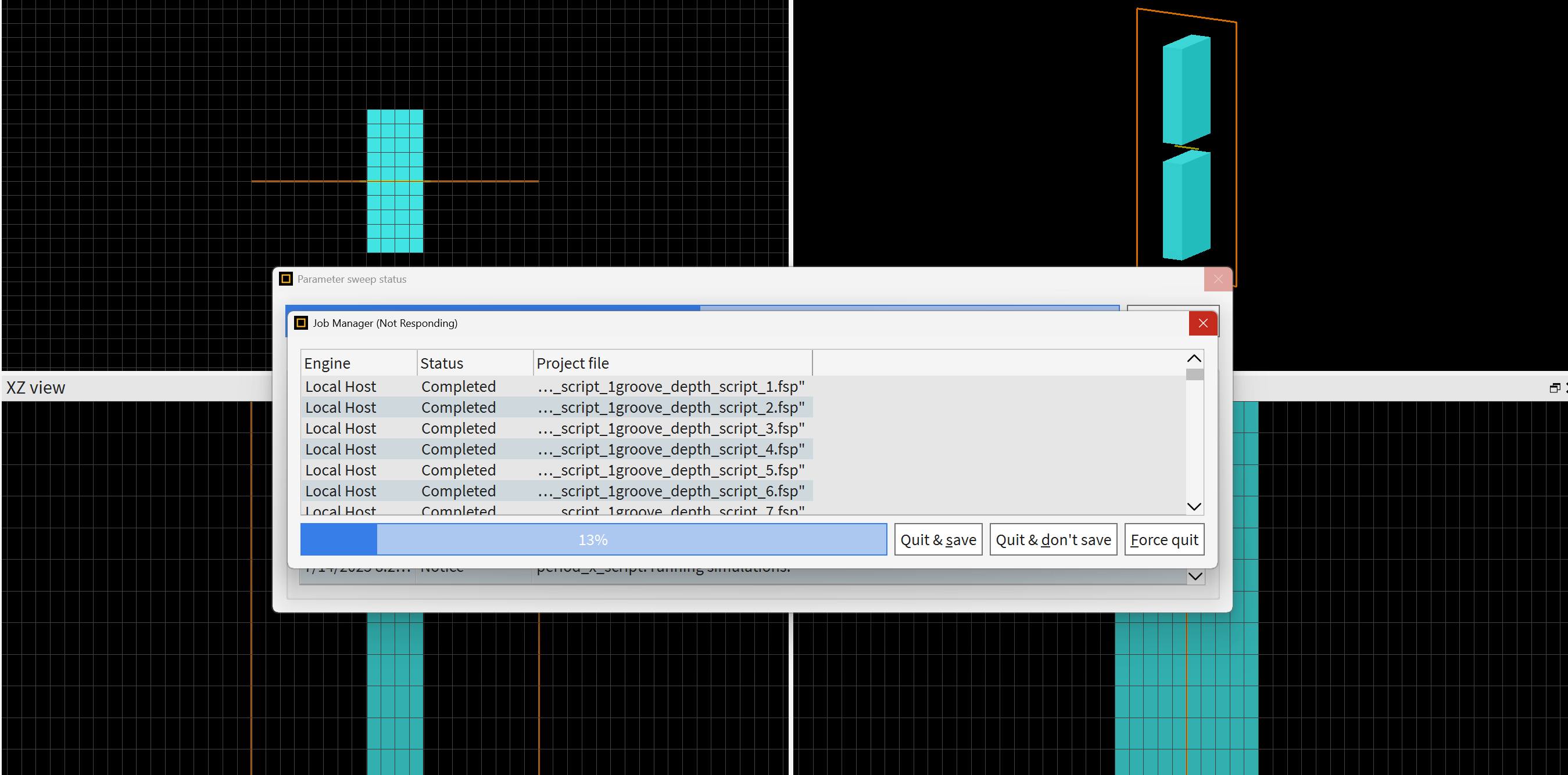

    • hammam.albustami

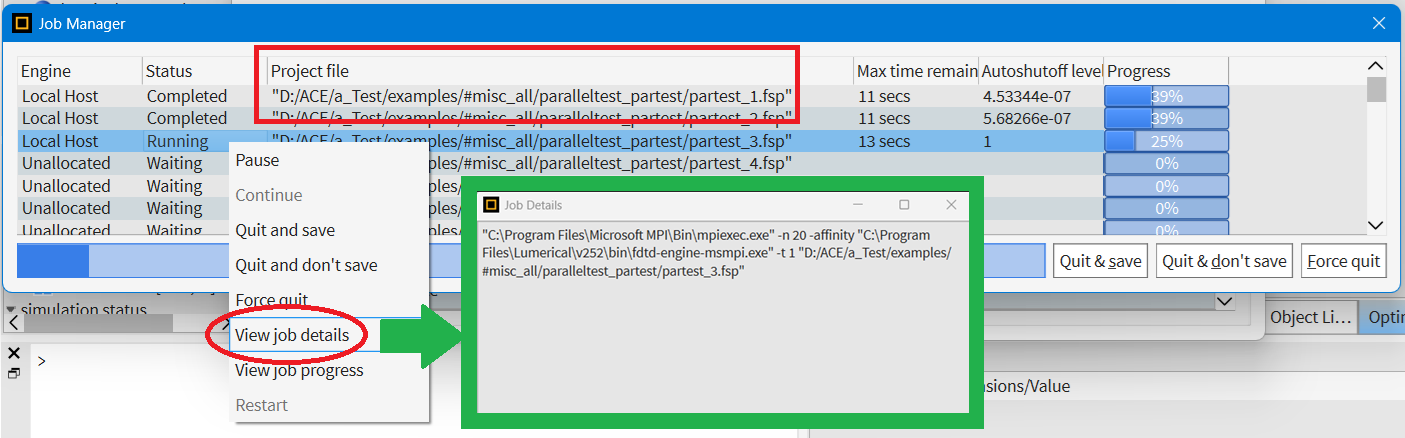

    • Lito
      @hammam.albustami,
      You mentioned in your initial post that the RCWA sweep is taking a long time to complete. And its stuck at 13%.
      1. Try checking the sweeps’ job details – e.g. scroll down to the stuck/affected sweep and right click on it to check the job details. Similar to this image
      2. Where is the simulation/sweeps stored? Ensure that the files are stored on a local SSD drive and not on a network or online/cloud storage

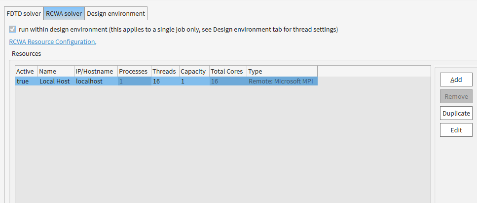

      3. Are you running RCWA simulations using the design environment / CAD/GUI

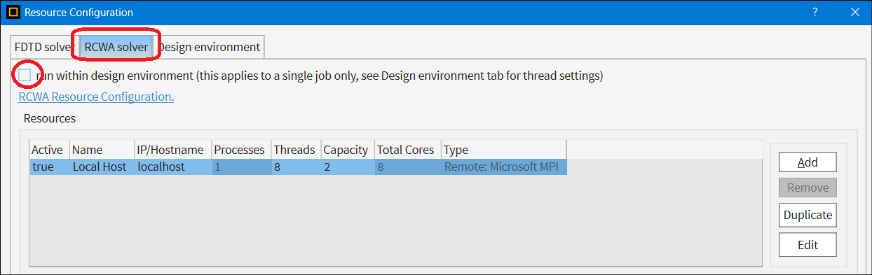

      4. Please send a screenshot of your RCWA > Resource configuration, similar to the image below (see this KB for more info).
      5. Also, are you running the Ansys license manager on the same machine where you are running Lumerical simulations?
        Or you are accessing the license via local network (LAN) or via Internet connection (WAN)?
    • hammam.albustami
      1- there is no error in the in the job details. But it stucks means takes very long time to finish the simulation (i think because of saving fsp files).
      2- My simulation fsp files saved in folder exists in desktop.
      3 - I run the simulation using python integration Api that call the lumerical and doing the simuysis take place using python.
      4 - the image attachced.

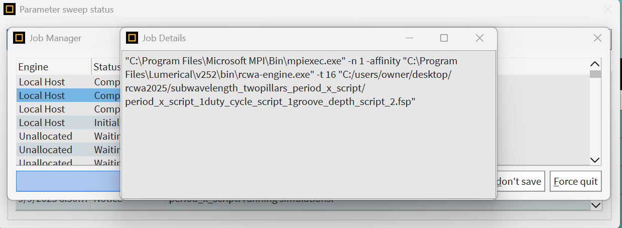

      5- the license manger ran on different machine where the simulation ran.
      Thanks
    • Lito
      Please check the full path shown on the Job manager window for your sweeps/simulations. Also Right Click on the stucked simulation/sweep and send us the screenshot of the job manager -- showing the full path of the simulation/sweeps are shown and the "status" and "job details" of the stuck sweep/simulation. (similar to the image below)
    • hammam.albustami
    • Lito
      This will be difficult for us to debug and fix since we are unable to reproduce the issue.

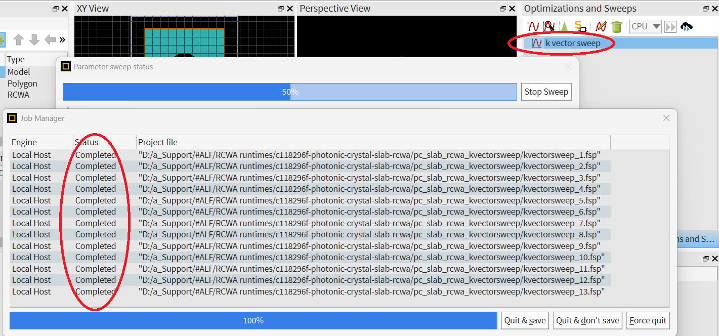

      1. Try the sweep/simulation example here >> Photonic Crystal Slab (RCWA) – Ansys Optics
      2. Reset the Lumerical configuration/settings >> Ansys Lumerical product preference files – Ansys Optics
        • e.g. Delete the "FDTD Solutions.ini" file
          • del %AppData%\Lumerical\"FDTD Solutions.ini"
        • Reboot the machine
      3. Then open and run the sweep using the default settings/resource configuration
        • Do not change anything on the Resources configuration

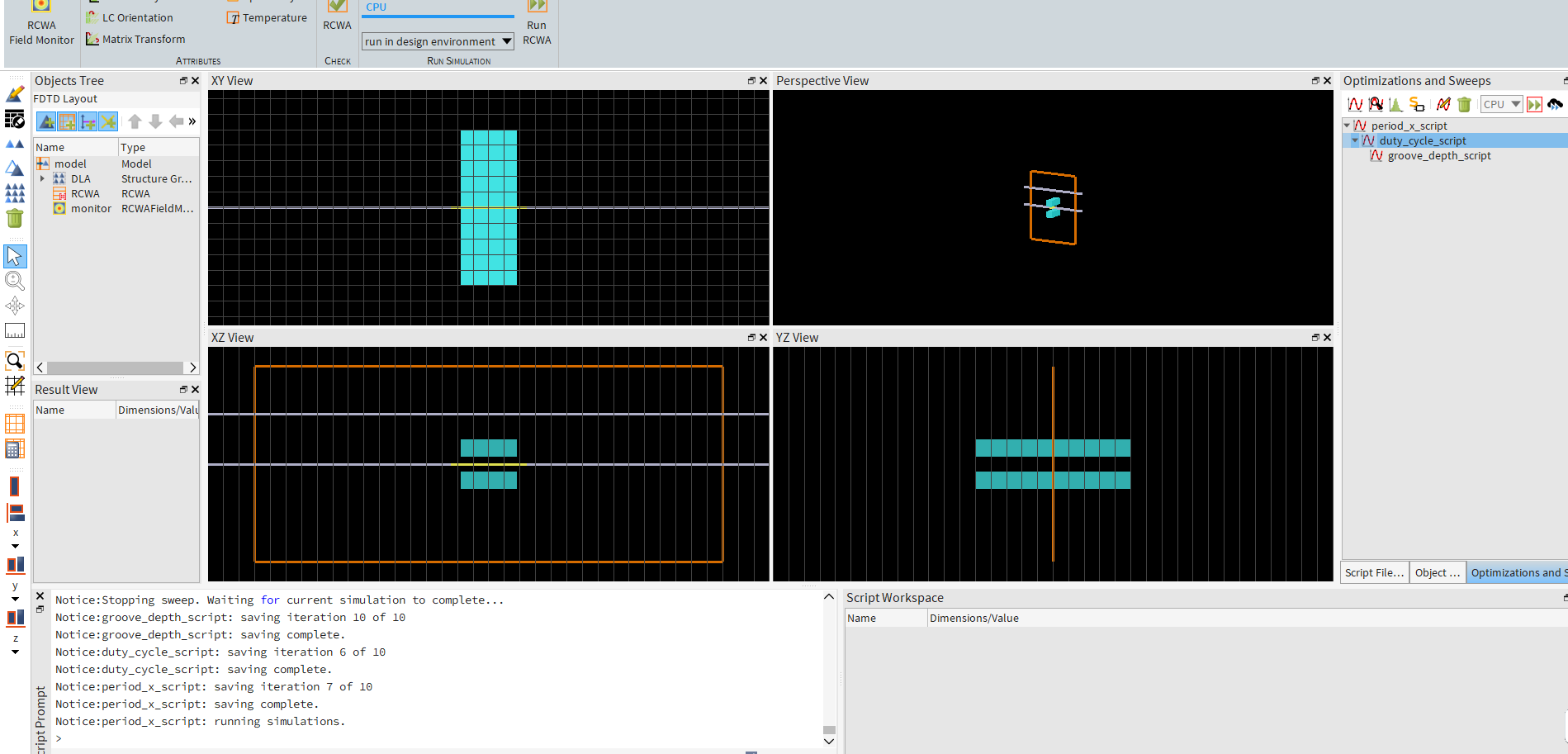

      We tried running the sweep from the above example with Lumerical 2025 R2.1 on Windows and it run to completion without any issues (as shown from the image below).
    • Lito

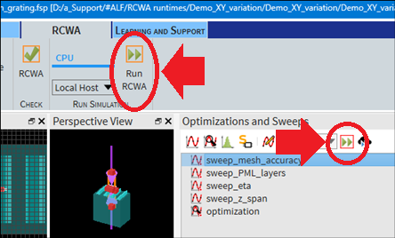

      By the way, when accessing the license from a different machine, it will take a few seconds for the client machine to "checkout" the license and run the job. Especially if the license server is on a different network or acccessed via the Internet and also if the simulation/sweep is run via a script.
      Try running the simulation/sweep directly from the CAD/GUI as shown in the image below. This is how we run our tests for the example, Photonic Crystal Slab (RCWA) – Ansys Optics
