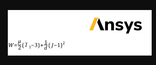

I am working on the structural simulation of hyperelastic models and I have some questions. Concerning the model of Neo, I have that the parameter d is the incompressibility of the material. For compressible material I saw that we could put d=0 or in the energy equation:
June 24, 2021 at 12:47 ampeteroznewman

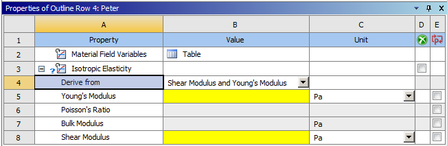

SubscriberYou cannot set d=0. You must set d = 2/K where K is the Bulk Modulus of the material.
June 24, 2021 at 8:23 amEmperor

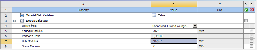

SubscriberHow do I get the mass modulus of the material? I have a hyperelastic material for which I only have the shore hardness and the density. Thanks to the shore hardness I could deduce the Young's modulus of the material (Gent's formula) then the initial shear Go. So I chose a Neo-Hookean model with a value of mu. But to find the parameter D1, I wanted to put the value of 0 for the incompressible material. Is it the same "d" or is it different?

SubscriberYes, I believe that is all the same parameter.
