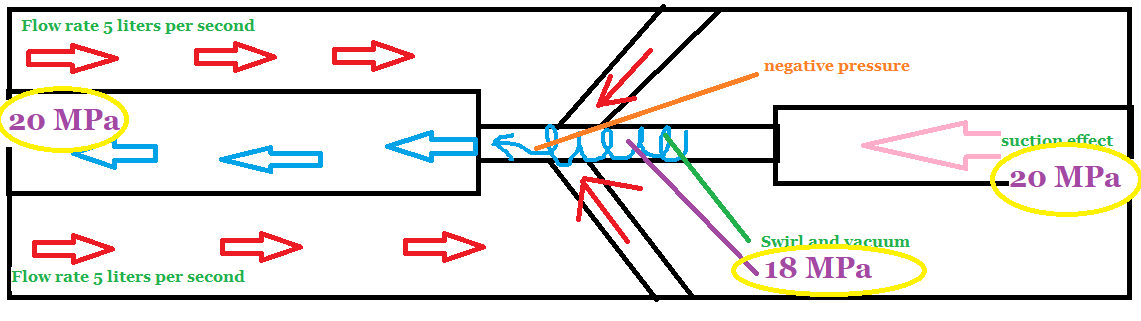

      Hi all. I have a problem. Help me please. Good knowledge in CFD is required. I'm counting a jet downhole choke. This fitting creates a vacuum when liquid is supplied to it, due to the vacuum, it sucks out the liquid after the fitting. I set the flow rate to 5 liters per second, which is fed into this fitting (red), goes through the radial channels and enters the chamber where it creates a vacuum due to the round flow. There is atmospheric pressure at the outlet of this nozzle (blue) and where the nozzle also sucks out atmospheric pressure (pink). When calculating in the vacuum chamber, it shows negative pressure. Why? What else can be asked? What could be the problem?
      I think you have a swirling flow in the centre section? That's creating a vortex core, and that can create the suction effect. Some CFD images will help explain what's going on: tangential velocity and pressure would be good.
      • javat33489
        Yes, that's right, there are vortices that create a suction effect and in this place the pressure is -1.5 MPa, this does not happen
      How does the convergence look? What is the operating pressure, remember you're (probably) reporting gauge. Please post some images.
      • javat33489
        Sorry I can't attach images. The flow rate at the inlet is 5 liters per second, which creates a pressure of 6 MPa. The task of the device is to cause an influx of fluid due to the vacuum in the tangential chamber. Due to this, the liquid should be sucked out of the pink area (see picture). But in the rarefaction zone there is a negative pressure, this does not happen in nature. The mesh is very good, at least 5 elements across the narrowest channels. Ke turbulence model. Convergence is achieved in 300 iterations.
        I tried to make a calculation under the condition of cavitation, then there is no convergence at all, the outlet pressure constantly jumps.
      With high swirl you'll need RSM: read the theory on the 2-equation turbulence models. How much mesh have you got in the swirl region?

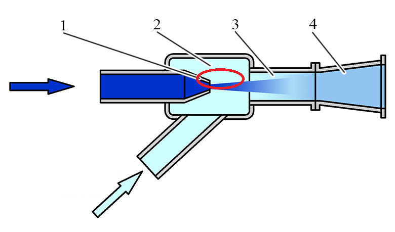

        The jet pump that I expect works on the principle of an ejector. In the area where the liquid is lifted through the constriction, a decrease in pressure occurs, which creates a suction effect for the second liquid. Highlighted in red where the program shows negative pressure.
      OK, so you have a known mass flow for the primary nozzle, a (probably atmospheric) secondary feed and an outlet at a different pressure.  That may then discharge into a larger vessel.  You will (should) know most of the data you need.
      I've modelled a few of these, and helped my PhD supervisor clean up after a few experimental mishaps. They're far more complex than people realise, and the throat dimensions and ratios are critical to good operation: same as in vortex amplifiers.

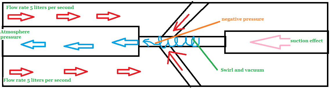

        How will this post help me? Can you help me? How to get rid of the negative pressure in the center? The inlet flow rate is 5 liters/second. Discharged to the atmosphere (into the container but from above, so the pressure is atmospheric, because the container is not filled). At the second inlet, the pressure is also atmospheric. The experiment is such that water is supplied at a flow rate of 5 l / s, pressure gauges are installed and they measure how air is sucked in from the vacuum inside the chamber and water is thrown into the tank.
      Given you've not shown any results it's hard to say if you have the correct answer. If you're venting to an open vessel you may need to include that: is setting 0Pa in the outlet nozzle physically correct?

        At the inlet to the pump, I set the flow rate, and at the outlet, atmospheric pressure, the program itself calculates the flow rate in the chamber (in the nozzle). Need to set nozzle pressure?
      As it's the outlet how confident are you that it's zero Pa, as opposed to zero in the chamber it exhausts to?
      • javat33489
        No, it's not like that. Water enters through the nozzle into the pump chamber - then the water from the pump chamber goes outside into the tank under atmospheric pressure. I did not put pressure on the nozzle, only on the inlet to the pump and the outlet from the pump chamber, and after the nozzle into the pump chamber, the program calculates itself.

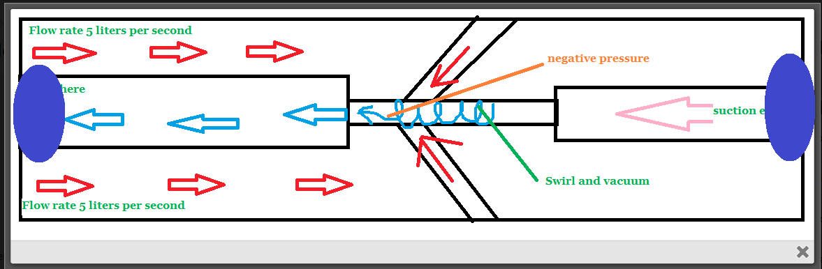

        Ok I will take some pictures
      • javat33489
        Here is a picture
        2
      That's a weird looking ejector. What speeds and density fields are you seeing?
      • javat33489
        I calculate the ejector again. I have a mass flow rate of 5 l / s at the inlet to the ejector, but according to the calculation, the output is 24 l / s, and that the ejector sucks only 2 l / s, there should be a total output of 7 l / s. What is the problem? At the outlet of the ejector, atmospheric pressure is set; at the inlet to the ejector from the side of the tank, atmospheric pressure is also set. Problem with ejector calculation in FLUENT
      The solver will (assuming the mesh is OK and it's converged) give the correct answer for the defined boundary conditions. However, as I can't see the solution I can't comment. I'm also not permitted to download case files so can only advise in general terms.
