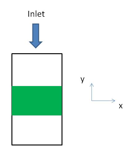

By simulating the expansion of a compressible flow (using compressible liquid) in a chamber, negative static pressures and total pressures appear.
For the initialisation I set a total pressure of 200 bar in the chamber and 10 bar before the porous media (models in green).
The red line models a piston which moves downward. The boundary conditions are shown in the picture below:
Problems are as follow:

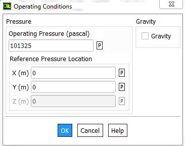

Ansys EmployeeNegative pressure but relative to the operating pressure. Gauge pressures can be negative.
April 25, 2019 at 9:50 am
Max4
SubscriberThe operating pressure is set as 101 325 Pa. Could the problem came from the definition of the Operating Conditions? I haven´t change the location of the reference pressure location. By default it is in the chamber, where a pressure of 200 bar is initialized.
The absolute pressure is the sum of the operating pressure and the gauge pressure. So the gauge pressure is the sum of the dynamic and static pressure? It´s better to plot the absolute pressure instead of the static pressure?

Ansys EmployeeAbsolute pressure= static gauge pressure+ operating pressure
Total pressure= static gauge pressure+ dynamic pressure
If you have an opening (pressure inlet ór pressure outlet) the reference pressure location is ignored.

SubscriberOk, then the reference location has no influence because I´m using a pressure outlet.
If my static gauge pressure has values in the order of -5e+6 Pa and the operating pressure is set as 101 325Pa, I obtain negative absolute pressure.

SubscriberI can then write an UDF for the temperature as function of the pressure for the fluid. Where should I hook this UDF?
I have a time step of 1E-5s. There is a still amount of fluid that pass through the porous media. The maximal velocity in the chamber is 2.5 m/s but remains very weak throughout the chamber. The cells size varie from 2E-5 m to 1E-4 m but the aspect ratio is good. I have create a domain (transition) between a zone where the mesh is very fine (after the porous media) and the rest of the chamber.

For the direction vector 1 of the porous zone, should I set X=1 and Y=0 OR X=0 and Y= -1?

Forum ModeratorThe direction vector is to allow you to set the resistance coefficients: as long as you know which direction to assign which coefficient to it doesn't matter. Porous media doesn't cause the flow to speed up unless you've specified the option: given the flow will normalise very quickly I never bother.Â
