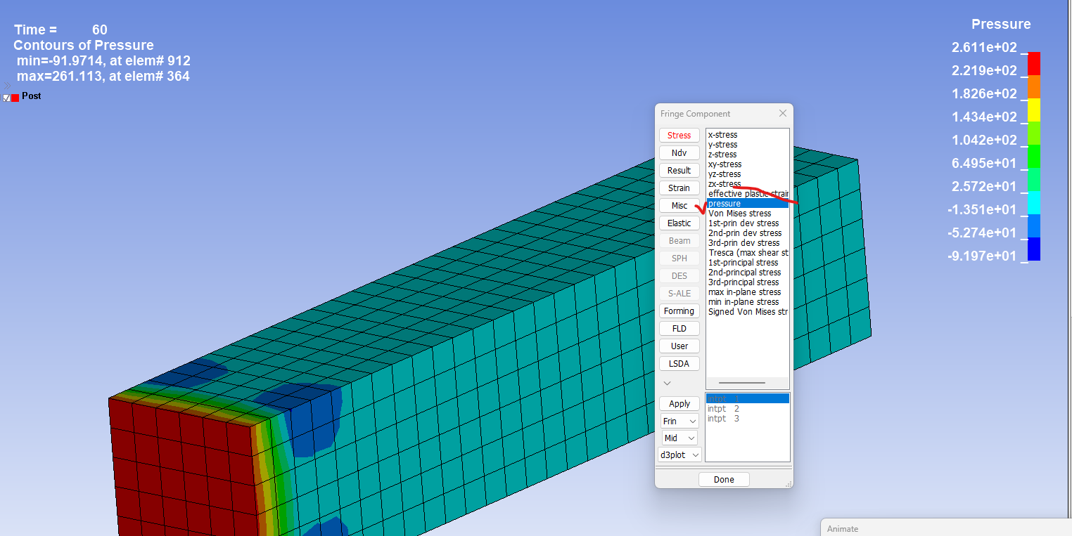

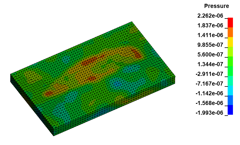

      I am learning about LS Dyna. When I check the pressure results, the color scale shows some negative pressure. Is this an error? And how can I fix it?

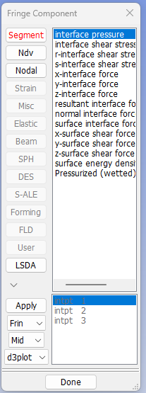

      I think you are using pressure option available under stress fringe component for plotting pressure.
      This pressure shows a mean stress value which can be negative. If you are interested in contact pressure, please write out intfor file and use it for postprocessing contact Pressure.

        Hi Raman Babu,
        Thanks for your reply.
        I was able to get the desired results.
