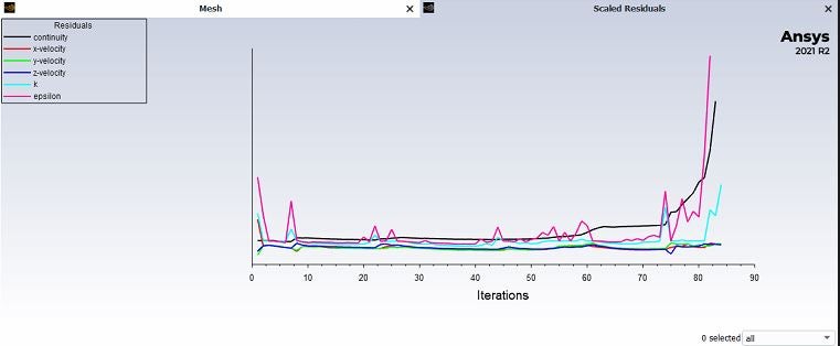

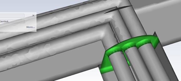

      Hi, i have a problem with my model it iterates a few times and show divergence and residual spike, how i overcome this?, i am modelling a duct and a tunnel but after 100 iteration what happened is the floating point exception and show message negative K in xxx cells how i can handled this

      It is mostly due to bad convergence, or bad mesh, or both. It also occurs when a user adds a negative source term to the "k" equation.
      Thank you.
    • Agung Limowa
      how can i can overcome this ?
      Check the mesh quality: note that's cell metrics (in Meshing) and resolution (Meshing or the Fluent solver). You'll need to look at and then judge the latter.
