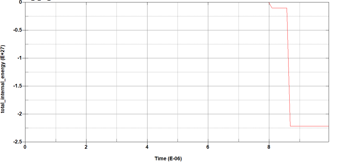

When I use LS-Prepost to read the result files, I find that for some cases, the total internal energy will appear an extremely negative value:
Also, the total kinetic energy cannot be fully displayed (as you can see, the same part but with different time frames, it should end at 10^-6s but there is no output after 8^-6s):
However, the results are convergent for other cases (same model but with different material properties). Also, for different meshes, the results will be different as well.

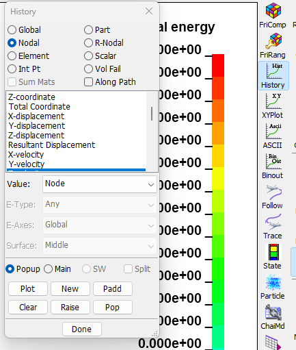

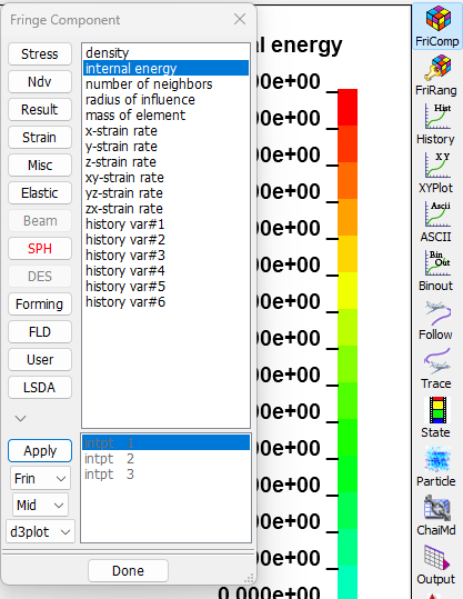

- Are there any methods in LS-Prepost to directly output the particle (nodal) internal energy? I can find the icon (internal energy in SPH Fringe Comp) but I cannot find internal energy in the history output icon, only part energy, which shows the same results as matsum. If I can get the individual results, I can manually delete the extreme particles and see the results.

For plotting the internal energy, you can use the scalar option, and since you have used the internal energy as a fringe plot you can select the node from SPH part.Â
