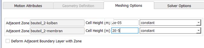

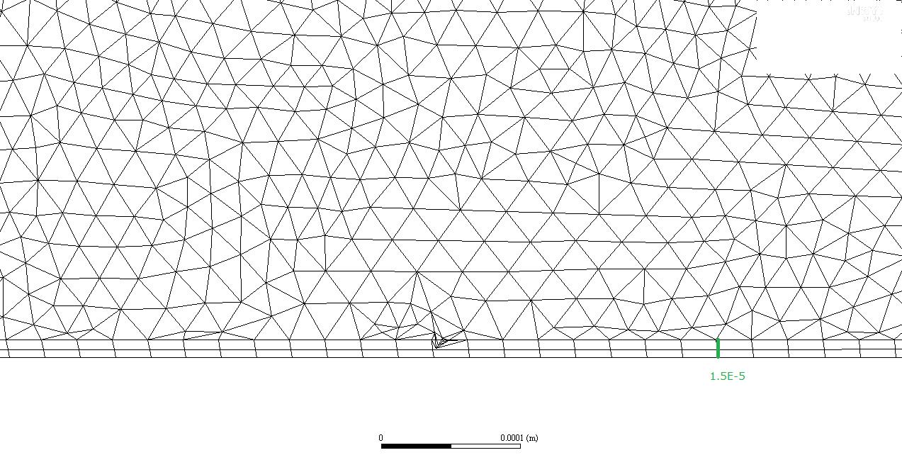

      I´m running a transient simulation with dynamic mesh. The position at the beginning is as follow. There is inflation which moves according to the mouvement of a piston. The cell size is 2E-5 m and the parameter are the following. Region Face is enabled because there are moving vertical boundaries in the domain too. I have use a time step size of 7E-6 s.

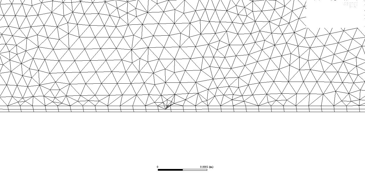

      After several time steps, one cell with negative volume is detected:

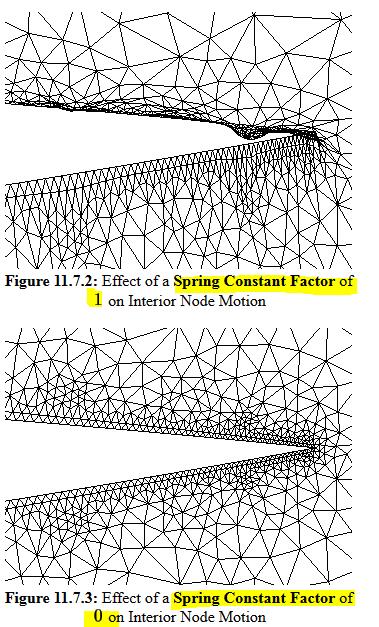

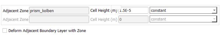

      As Cell Heigt for the moving boundary "piston", I have set 1,5E-5 m. Should I just set the value of the first layer height and not the height of the inflation ? I have yet chang the Spring Constant Factor between 0 and 1, without any changes.

      i assume you are moving prism layer with lower boundary.
      please use cell height for tet and not for prism.
    • Max4
      Yes, prism layer are moving with the lower boundary and are set as a rigid body.

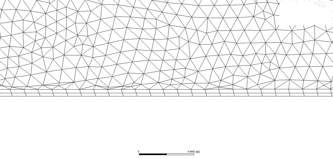

      I have tried it with cell height of 2,5e-5 m, but it doesn´t work. The problem occurs always at the same position.
      I have set the spring constant factor to 0.1, so why does the mesh deform so much around the moving boundary (compressed cells)?
      The other settings seem to you okay?
      Maxime
    • Keyur Kanade
      in smoothing please use spring factor as zero and no. of iterations as 100. then check.
    • Max4
      It doesn´t work. The same problem at the same position.

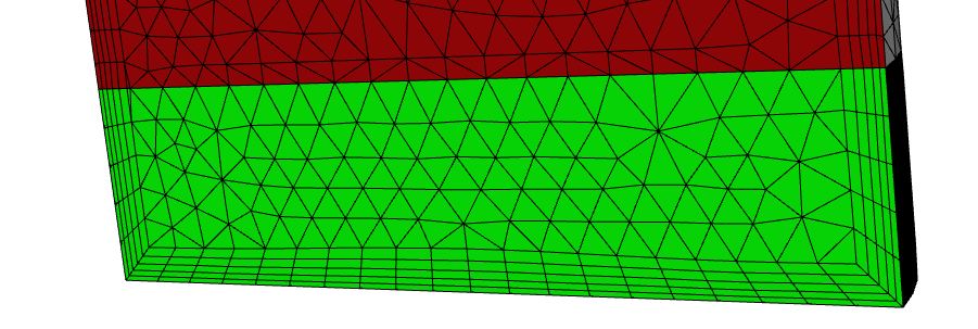

      My green zone is moving rigidly. The same happens for the interior boundary between green zone and dark red zone. dark red zone is marked as deforming with local cell remeshing and region face. That is why I was meaning with domain decomposition.

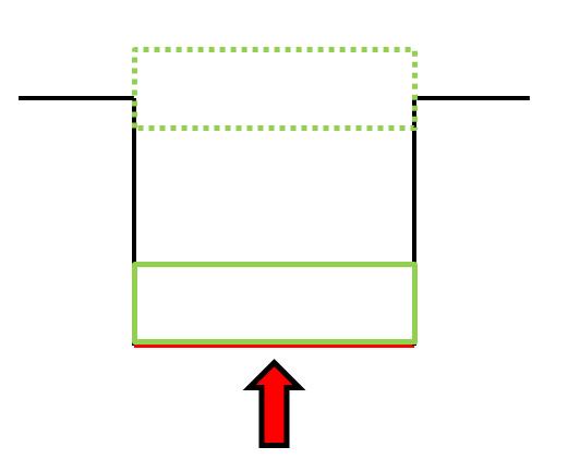

      Does your solution work, if the rigid domain (green rectangle) overtakes the corner (final position: green dotted line area)?
      The separation is the same for 2D and 3D Case? You have done the separation in ANSYS Meshing then?
    • Amine Ben Hadj Ali
      I do not have corners in my example so that I cannot answer here.

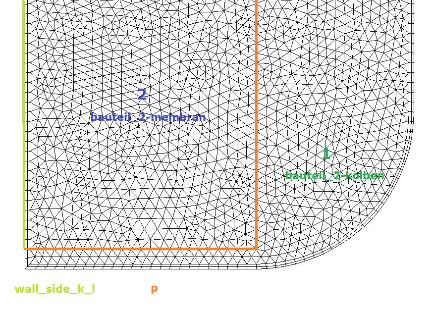

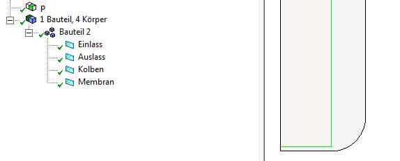

      I have split the geometrie into two domains:
      By the upward movement of the piston (and the whole domain 1 set as Rigid Body), there is a problem at the inflation which gives negative cells. So, can we use the inflation with remeshing?

      Region Face has to be enabled here and if the settings are correct it has to work.  For the interior boundary (in orange) you need to provide the same UDF/profile as for the cell zone 1. Disable smoothing globally or locally in the related zones /walls.

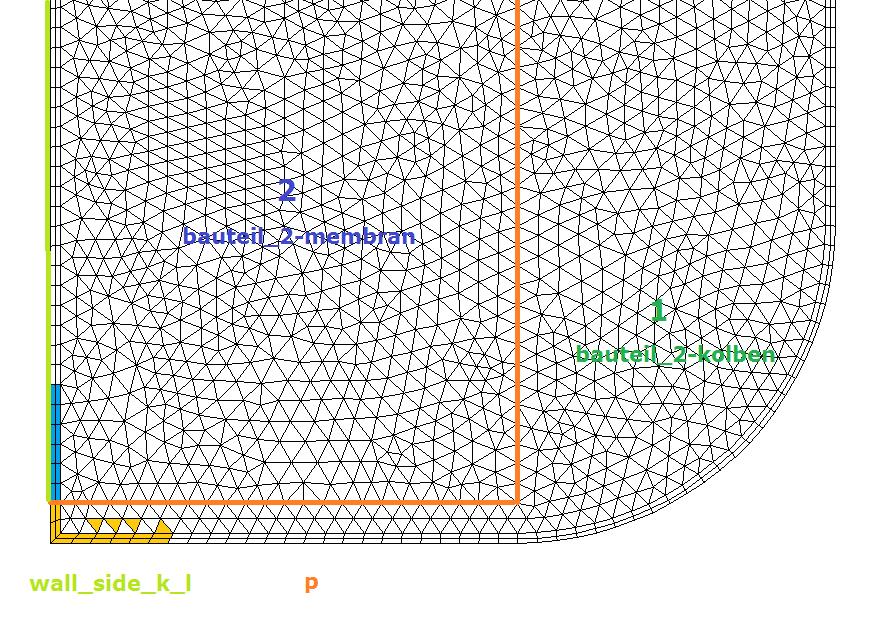

      Thank you for the answer. The same problem occurs with negative cells on the left boundary. Local Face and Region Face are enabled in Remeshing.

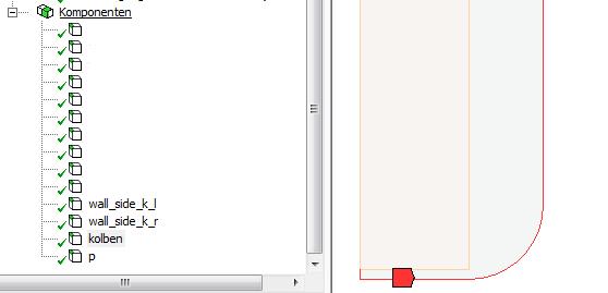

      I have created a component (named p) in DesignModeler for the interior boundary in orange.
      Following picture shows the different parts:

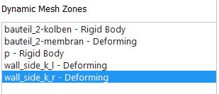

      The dynamic mesh zones is as follow:
      In details:

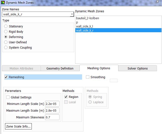

      wall_side_k_r: I have disabled Smoothing (better when Region Face is used on moving boundary)

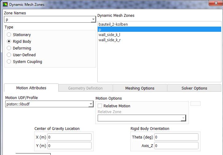

      p (interior boundary)
      bauteil_2-membran

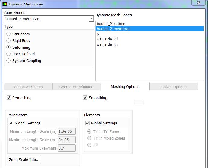

      bauteil_2-kolben is set as Rigid Body with the same UDF as the boundary p
      Thank you in advance.
       Hallo Maxime,

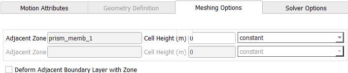

      1/For the rigid body meshing option: set 0 as mesh size. This is only relevant for layering
      2/wall_side_k_l has to have the settings as wall_side_k_r
      3/Wall_side_k_r is rigid and does not require explicit definition.

      1/ For the definition of "p", I have to set 0 for the cell height if I understood correctly?
      2/ wall_side_k_l and wall_side_k_r have the same settings
      3/ wall_side_k_r has to be set as Deforming, like wall_side_k_l
      The deforming wall_side_k_l and r are already set as Plane, thanks.

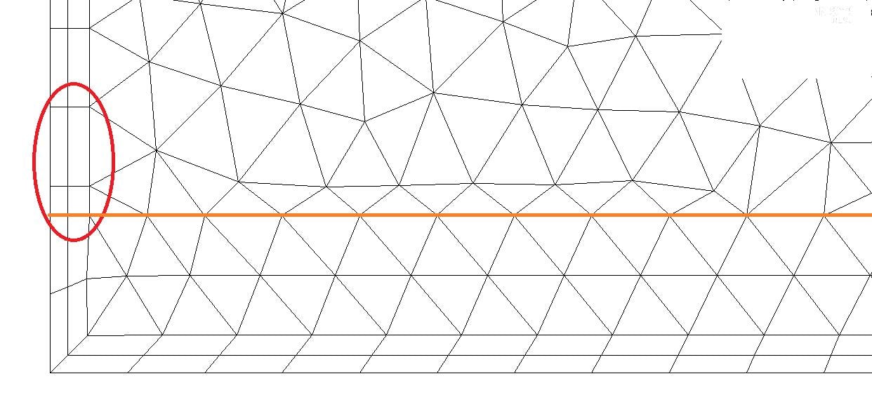

      The problem persists. How does the solver know when to merge the cell on the left boundary?

      HAve you read the last part of my answer?
      Where is wall_Side_k_r?
      The rigidly moving cell zone encapsulates the prism layers on the moving piston so that the layers are not remeshed.

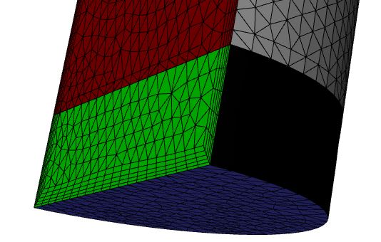

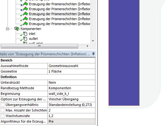

      In ANSYS Meshing, I have done the inflation layer for the wall_side_k_l respectively r and for the piston (kolben) separately:
      I have separate "kolben" and "wall_side_k" in order to be able to select the "wall_side_k" as Deforming (Plane as Definiton).
      By upward and downward movement of the piston, how the prism layers on the "wall_side_k" behave?

      Should I enable "Deform Adjacent Boundary Layer " in the definition of p?
      The settings are looking fine perhaps the decomposition should be done differently. At this stage we cannot provide more information without having access to the case. As ANSYS Stuff we do not do that on this open community. Please check with your supervisor if any who can contact his local support.
    • Max4
      By using Remeshing & Smoothing, it is not necessary to set a value for the cell height for part set as Rigid Body?
       Not necessary and lease check with your supervisor if any who can contact his local support.
