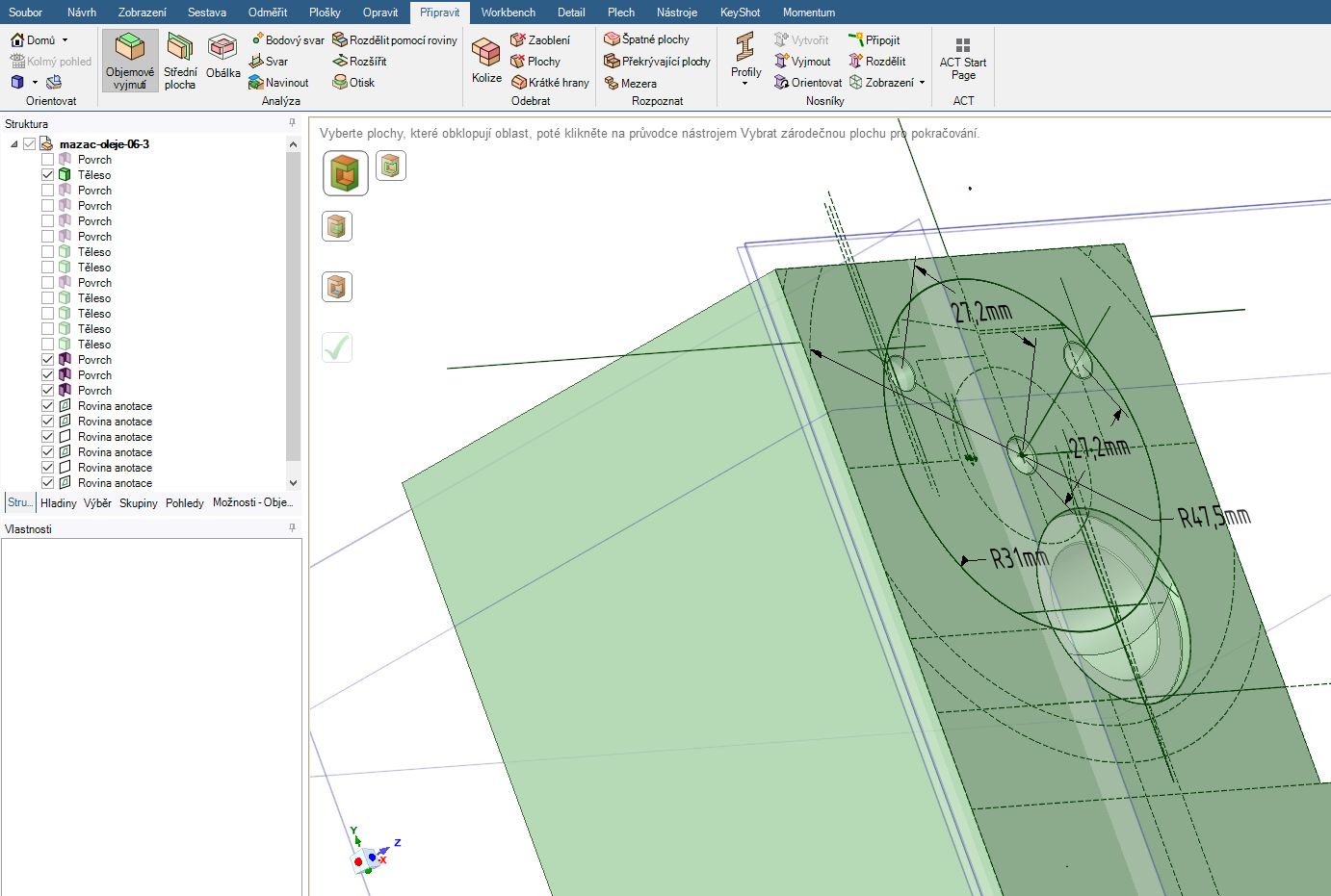

      Hello, I need to help with the dimension and their changes, since it seems I am not able to change the dimension of length in the picture I show you! And of course I know how to get the dimension with the star, but it does not work and I try all possible lengths, but it does not allow me to change anything at all. And this is absolutely critical and I am trying to do with this for one month and nothing!!! Absolutely poor!
      Please have a look at the picture and you will see what the problem is and tell me! Thanks.
    • Georgiro1
    • Georgiro1

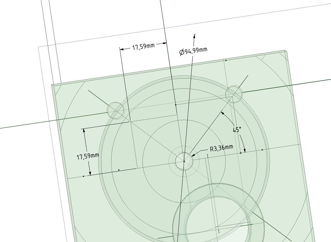

      And the point is for example that I need to change the R=3.36mm to D=6.15mm, but it does not work and I have been trying this change of so many lengths, but it is not possible. So can you tell me what to start to do in order to be able to do it! Thanks
      Can you Pull the face that forms that feature? You'll need to work out how far to get the new diameter (radius).

      I only and only need a simple way to order to change the dimension on the star value! It does not work and I do with with so many visibility - the position of the start, i. e. from different visibility of starts! Just impossible at all! Thanks
      It's a SpaceClaim function  https://www.youtube.com/watch?v=BY5KU-hOaAU   which you need to alter the geometry. Those dimensions look like a CAD dimension overlay, not what I'd expect to just type a new number into.

      As we have mentioned before: staff are NOT allowed to download files. We are also not allowed to give detailed instructions. We are here to help & guide you need to go through the tutorials and learn. How did you generate the CAD?
      I opened the attachment and found there is no solid body, just a collection of surface bodies.
      I suggest you start over with a new file. As you make each sketch of a profile to Pull into a solid, keep checking the Structure tab to make sure you maintain a solid body.

      If you have a set of connected (or mostly connected) faces with a few holes running the Repair tools will highlight where the problems are & will try and fix them. What happens if you follow the process shown in the video?

      OK, I assume you're trying to change the dimension and not the actual geometry. That won't work: the dimensions are an annotation rather than a controlling feature.  You need to use pull etc (as in the videos) on the volume to change the sizes.
      It may help to untick the "Annotation Plane" in the tree so you're not getting confused by the labels.
      As an aside, please can you post the first 10-15 lines of the licence file: I wonder if there's a feature causing some of the issues (there are several "flavours" of SpaceClaim licence).

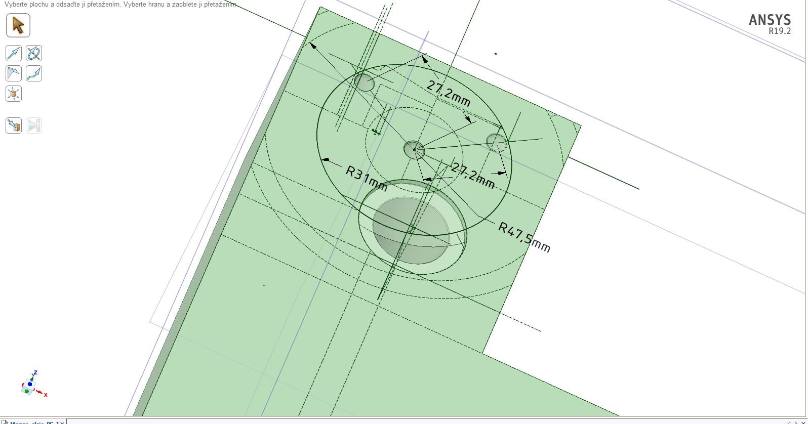

      So basically I need to change the radius of 27.2 to 32 mm and I would say this must be absolutely easy, but it is not and I do not know why! Thanks
      You change the geometry using Pull etc, this will update the radius dimension when it's done.

      Basically I need to change the distance from the center of the small hole from R= 27.2 mm to R=31 mm, but do not know how. Thanks
    • Georgiro1
      In the previous comment there is also the part to change...Thanks
      Select the annular face and use the Pull tool as outlined in the video(s).

      Pull is used to extend/shrink objects. Including changing the radius of holes.  To move the hole, follow the instructions Peter gave.

      Watch the video again. First I turned off the surfaces, then I moved one hole, then I moved the other hole after changing the direction of the move.

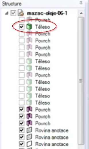

      And also you mentined the solid body and I need to know how can this find out? Thanks
      The solid body is circled.  Uncheck the surface bodies at the bottom (Povrch) to avoid moving them instead of the hole in the solid.

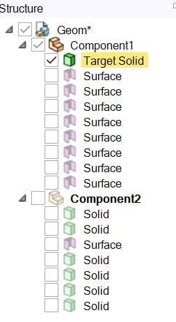

      If you added a Component, and that component is Active (name is Bold in Outline), then you can't edit solids in other components. [edit made]
      You have to click on the Component that has the solid below it and Make Active.

      I left the word bold out of the previous post, which is now corrected.
      Here is the outline of the file you attached above, let's concentrate on that.
      In this outline, there is only the file name at the top, and it is in bold.
       The solid body is circled. As I said above, the surfaces lower down can get in the way.
      If you right mouse button on the solid, the popup menu shows Hide Others.
      It's important to hide others in order to do Move operations on faces of the solid. Concentrate on moving the holes according to the video without complicating it with additional components.  Download the file attached to this post and follow the steps in the video. You will be successful.

      Here is an example with two components and each component has solids under it.  See Component 2 is bold, that means that is the Active Component.
      I was suggesting that to edit the Target Solid under Component1, it would be helpful to make Component1 Active first, before attempting to move faces on the Target Solid.

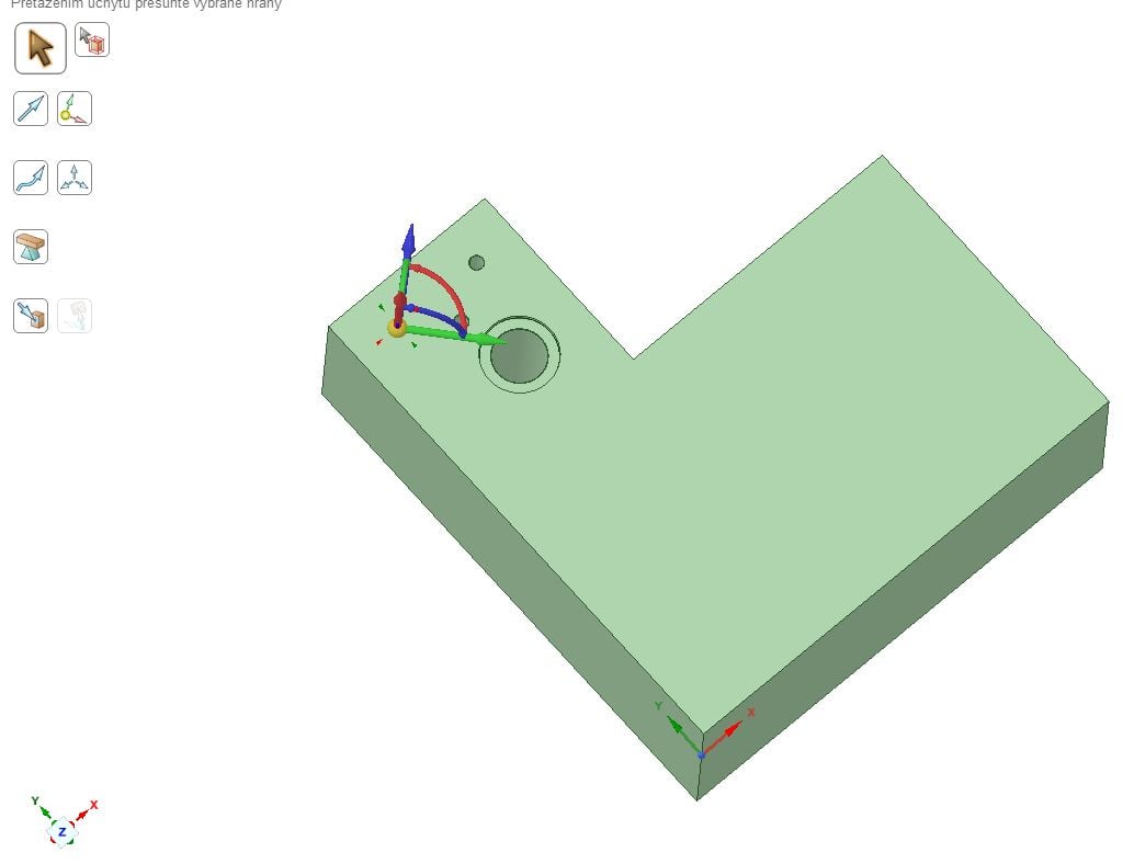

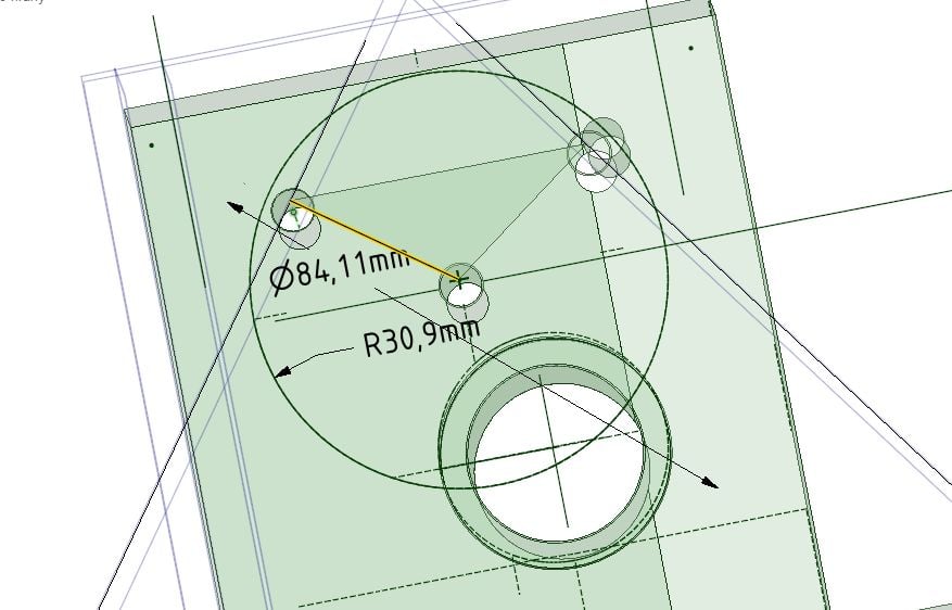

      The only better way is to tell me how to increase the distance of the cylindrical hole from the centre hole, i. e. to increase it to over 31 mm. Thanks
      As shown in the video, if you have only one solid visible, and all other objects are not visible, you can click on the Move tool, click on the face of the hole, and drag one of the arrows on the triad to move the hole in that direction by an amount you can type in.  The video shows how to align the triad with a curve that is visible.

      And you can see here that I have changed the coordinate system, but how to change the distance - I have no idea! And this is the point!
    • Georgiro1
      And also to think of me to change the length - in this way it is not possible and I have no idea what it means...
      Good progress.  The next thing to do when you have the hole face selected and the move triad visible and pointing in the right direction is to click on the green axis of the triad and drag it to the left. That will begin moving the hole in the right direction to increase the dimension. A popup box with the move distance will appear. The difference between the dimension you want 31 and the dimension you have 27.2 is 3.8 so you type 3.8 in the dialog and hit enter and the hole will now be at 31 mm. That is what I did in the video.
      Some people have figured out how to use the measure tool while moving faces, and learned how to measure the distance to the other hole, then they can type in 31 instead of 3.8 but I haven't figured out how to use the measure tool while moving faces.

      So I was trying to do what you are saying, but I am able to do the hole face selected, but do not know exactly what does it mean "move triad" and move to the right direction should not be a problem. If you can show me what is "move triad", this would be clear! Thanks Because otherwise it does not work at all!
      Watch the video, at 37 second mark, I grab the red axis of the triad and pull it, which moves the hole and pops up a box to type in a number.
      I do it again at the 56 second mark for the other hole.

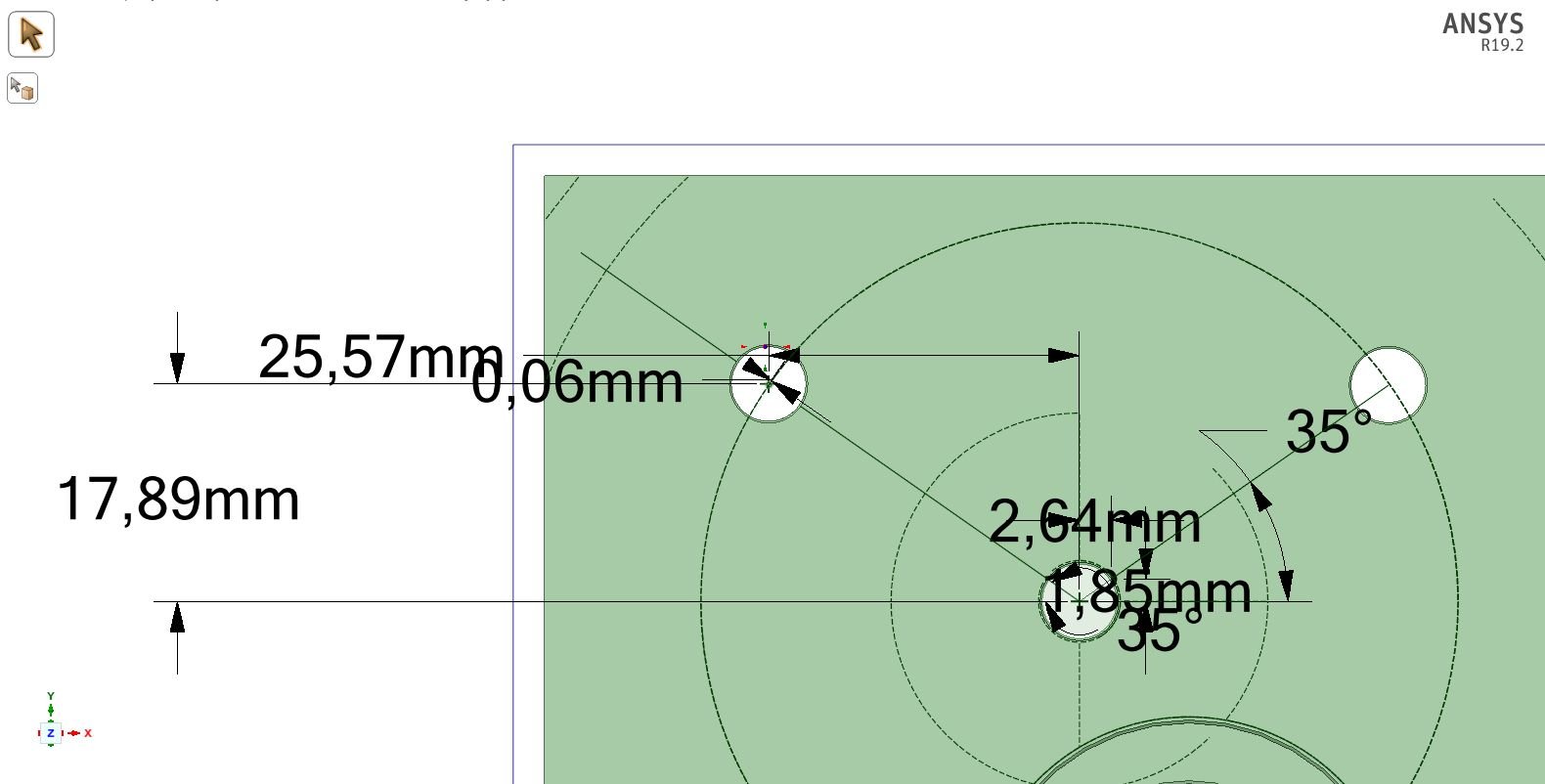

    • Georgiro1
      So here I have changed the position, but still missing 0,06 mm and need to do it, but how? I do not know? Would you be able to help me a little bit! Thanks
      Click on the face of the hole on the left that is wrong. Hit F on the keyboard, which is Fill and the hole will be gone. If that hole has a chamfer, you have to first pick the face of the chamfer and hit F, then do the hole.
      Now start a sketch on the top and get the circle tool, and start a new hole at the intersection of the radial construction line and circle.
    • Georgiro1
      Quite good and quick idea, ok, I will do it. Thanks
    • Georgiro1
      This was great idea and it worked absolutely easily. Thanks
