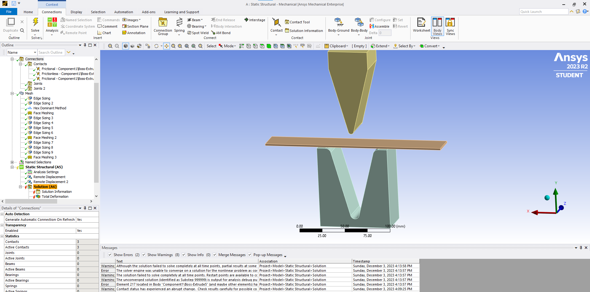

      I'm just a beginner on Ansys, and I'm struggling with simulating a V-die sheet metal bending process.
      Can someone help me on how to set up the contact and static structural ? Cus when i watched the tutorials on Youtube, some use joint but some use contact instead.

      I would suggest to use explicit dynamics for this (static can not solve this).
      See here for a tutorial:
      https://www.youtube.com/watch?v=OfiEqS3RlXw

        Thank you for your suggestion. It went quite well. But the thing is, my sheet metal plate is too flexible, felt like rubber, is there anyway i can make it bahave like normal steel plate? And also, i want to input the force at the end of the journey, is it possible?
