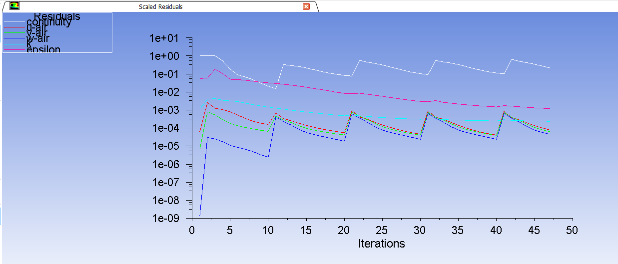

      Dear Mr Rob I tried running dpm not ddpm, but i cannot monitor the concentration of the particles, also i find that some particle status is "incomplete", but if i use DDPM under Eulerian, i can monitor concentration and all particles are complete.
      How can i find the concentration if i am using only DPM?
      And also, when i update the DPM sources every say 40 or 50 iterations, the solution never converges, as can seen in the screenshot below. how can i overcome this? how can i solve the flow without particles until convergence then inject particles?

      Concentration requires a coupled (interaction with continuous phase) to be available. You can run the flow to completion and then track particles: that's done fairly often when the particle loading is low. As you want to look at deposition blocking the filter that may not be appropriate.
      Incomplete means the particle ran out of integration steps before leaving the domain. This can mean they're stuck in a recirculation zone and will never leave or that you've not set enough steps. Default is about 5,000 (from memory), try 10,000 and see if that helps. Don't blindly increase that value too far as the solver must do those integration steps if they're needed so you could be waiting a long time for a result.

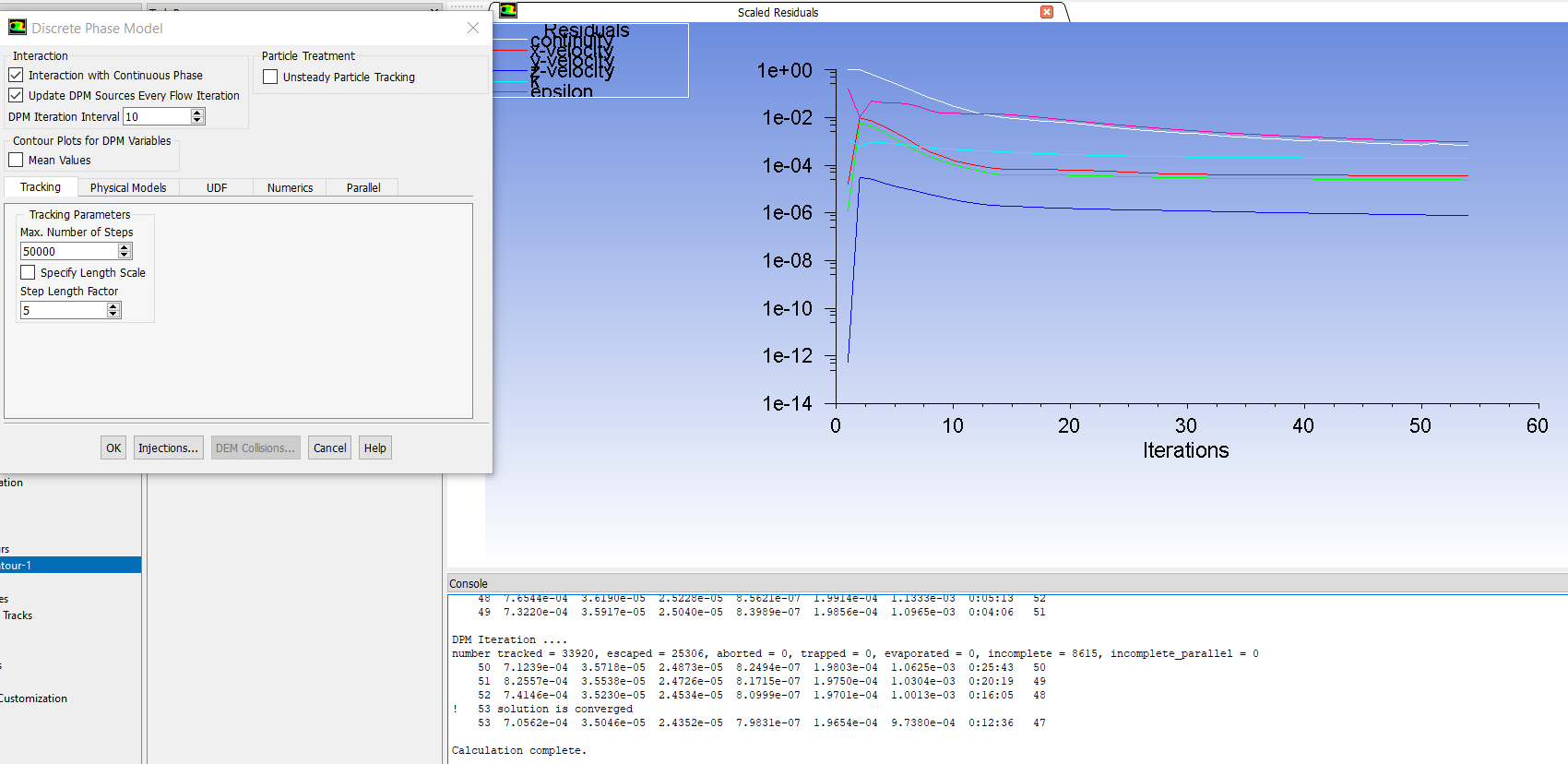

      Mr Rob, the solution converged, but still incomplete particles, although i increased the max number of steps to 50,000.
      Any suggestions how can i solve this issue?
      Have a look in post processing to see where they've gone.
