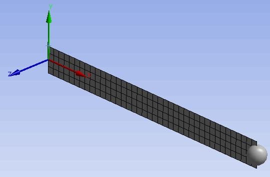

      Adding point mass: need suggestion for this confusion: when i just selected the face and added point mass, it was just point mass, i couldn't apply any forces or other features on it. then i tried to add another geometry like it is shown in the picture of my post you posted as well. at the end i just added a small block and gave it the mass of 0.5kg. then total weight became 1kg. so my question here is, should i add another object like shown in the picture above? or should i use just point mass if i want to get the effect of point mass? please suggest.  and will the moment of inertia of both masses will be combined or not? if not then how to combine or get the exact value required to rotate the beam horizontally.

      You show a solid plate for the flexible beam. Don't use a solid, use a surface body, mesh it with shell elements and assign them a thickness property.

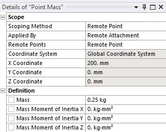

      Here is a 0.25 kg Point Mass on the end of a 0.0314 kg cantilever beam 200 x 20 x 1 mm.  The point mass is scoped to the short edge of the cantilever.
      Note that this is a true point mass. The Moments of Inertia are zero. To simulate a body that spans the width of the cantilever like you did, you could take the values of Ip from that body and type them into the details of the point mass.

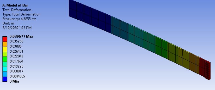

      Make the edge on the Y axis Fixed and run a Modal Analysis. Click on the Solution Information folder and look at the Solver Output. In that listing you will find the Precise Mass Summary with the Moment of Inertia about the Origin. You want to use the values the green arrow points to.  You don't want the values the red arrow points to because they are not where the torque is applied.  Note that the units are very important!  These units are kg and m.  Be careful, since you will get different numbers if the units are set to mm.

      i still don't understand that what is the meaning/use of lp1,lp2,lp3 in inertia section.
      is this how i am suppose to fill the values...right?

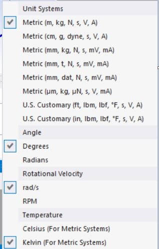

      and as you said the units are important. i am not getting the same values as yours even after changing to m, kg unit standards. changing the standards are not effecting, so it doesn't matter which standard i choose, its changing the value in the properties box but not in the "solution information"

      YOURS vs Mine
      In YOURS, the units are set to mm, in Mine, the units were set to SI. You can verify that by looking higher up in the Output. You have to Clear Generated Data after you change to SI units before you Solve, otherwise, Workbench sees the model is already solved and will not solve it again. Below is what you had in the output listing.
       MPA UNITS SPECIFIED FOR INTERNAL
        LENGTH      = MILLIMETERS (mm)
        MASS        = TONNE (Mg)
        TIME        = SECONDS (sec)
        FORCE       = NEWTON (N)

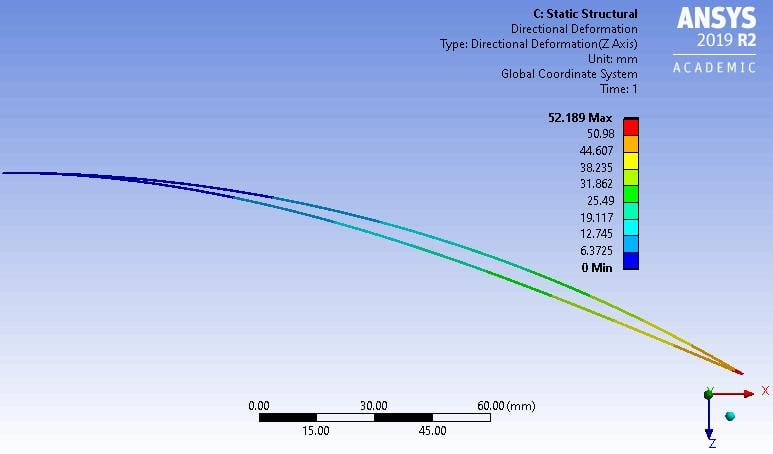

      Beam Stiffness in different directions
      If I define the two points for stiffness as the ends of the cantilever, I can apply a Z displacement or I can apply a Z rotation at the tip.  The resulting deformation in the middle is different and the stiffness values aren't even in the same units, one is in N/m and the other is in N-m/degree. In the image below, I have overlaid two cantilevers and applied a Z displacement to one and a Z rotation to the other.
      You are confusing a Rigid Body Rotation of 30 degrees at the base, which if done slowly, causes no deformation and results in a perfectly straight cantilever... with applying a 30 degree static rotation of the tip relative to a fixed base that cause the deformation shown above.  In your dynamic case, the inertia of the mass at the tip and the rapid rotation of the shaft connected to the base of the cantilever results in deformation similar to that shown above.
      Moments of Inertia
      You should read a textbook to understand mass moments of inertia. A solid body has a 3x3 matrix for the mass moments of inertia relative to a specific coordinate system, such as the one at the base of the cantilever.  This can have non-zero off-diagonal terms in the matrix.  Then there is a special moment of inertia matrix, relative to a coordinate system at the centroid of the mass and oriented in a special way such that the moments of inertia values are only on the diagonal and all the off-diagonal terms are zero. Those three values are called the Principal moments of inertia.

      the beam will be same as before without deformation if done slowly, but i have to do it in less time like 0.09 sec or 0.1sec etc...so considering the thickness it will definitely produce deformation.

      Open SpaceClaim, on the Prepare tab, use the Midsurface button to replace the solid body with a sheet body.
      In Mechanical, reattach the Fixed Support and Remote Displacement to the edges of the sheet body.
      Under the Static Structural analysis, under the Analysis Settings, turn on Large Deflection.
      Solve it once with a 30 degree rotation about the Z axis, leaving the Z displacement free. Note the directional displacement in the Z direction.
      Solve it again with the Z rotation free and apply the Z displacement found in the previous solution. Those are the two curves.
      If you want the two curves overlaid, then copy and paste the midsurface so you have two cantilever beams in the same model, but give them the two different end conditions.  If you do that, you will need to increase the nonlinear displacement convergence tolerance to make the tips end up at the same value.
