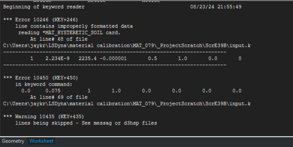

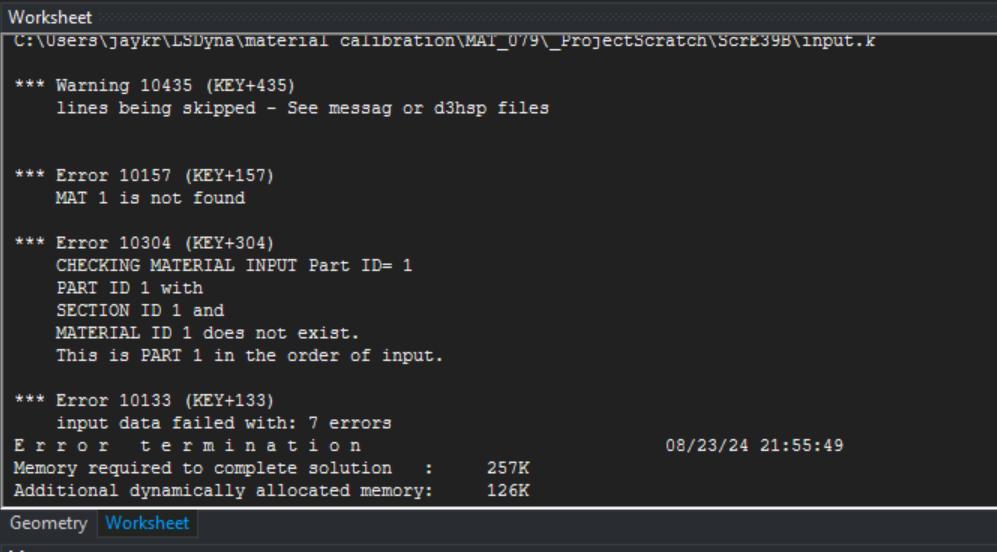

      Hello. I am hoping somebody can help me. I am trying to do a simulation using MAT_079 in Workbench LS Dyna 2024 R1. I am always getting the following errors:
      • error 10246 (KEY+246): 'line contains improperly formatted data'
      • error 10450 (KEY+450)
      • error 10157 (KEY+157) 'MAT 1 is not found'

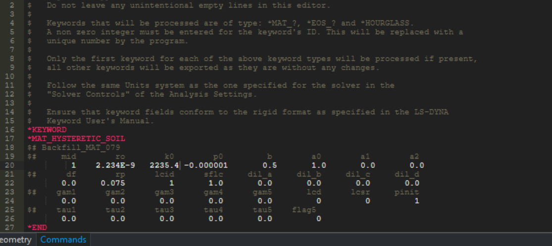

      I cannot figure out what is wrong. I have entered the material description in LSPP and then copied from the keyword file. Below are some screenshots.
      Hope somebody can tell me where the mistake is. Thanks.
    • Joerg
      I think I figured out what was wrong: All entries need to lign up vertically at the end...When I adjusted this, it worked.
