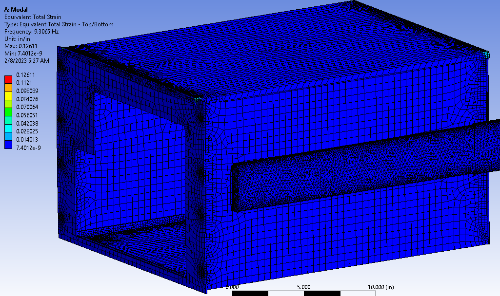

      I have a model of a box with a point mass inside. The box is made up of 6 individual components (sides) and they're all connected using bonded contacts. The geometry of the box is made up of midsurfaces (shell elements). Each side of the box has a chassis slide attached using bonded contacts. The chassis slides are solid elements.
      My ultimate goal is to determine the resonant frequency and I've already gotten some results but I wasn't convinced. So I suppressed the boundary conditions and the point mass to check the rigid body modes.
      1-3 translation modes are 0 Hz but 4-6 rotation modes are non-zero, in fact they're in the single digit frequency range. So I extracted equivalent total strain and notice non-zero values for strain at each corner of the box. Can anyone shed some light on possible causes? I appreciate any help.
      I checked my contacts using the contact tool and don't have any open contacts. There are some that are statused orange.

      Yes the point mass is remote and it is deformable. What appears to have been the culprit is my contacts so I used shared topology instead. Do you have any input on that?
      Switching to Shared Topology was going to be my next suggestion.
      Another suggestion would be to change the Bonded Contact Formulation to MPC.

      I also tried MPC and didn't get different results. Thanks for your input.
    • dlooman
      The most common reason for this is penalty based contact across open gaps or between curved surfaces so it's surprising that switching to MPC didn't fix the problem.  A test is to request stress results and look where stresses are occurring in modes 4-6.  In a rigid body mode there shouldn't be any, so the location of stress could indicate where the artificial model constraint is located.
