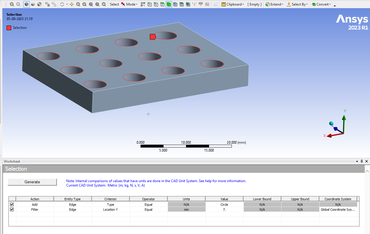

      Is it possible to use a named selection to isolate and choose only the edges on one side of a through hole of a plate?

      It will be great if you can share some inline images describing your issue. From the above description, you can use the worksheet to create the required logic for creating the named selection. Please check the below link for details.
      Specifying Named Selections using Worksheet Criteria (ansys.com)

      i want to select only the holes on one side

      Hi Ebwix,
      Thanks for sharing the image. You will have to use the worksheet to create the logic to select the circular edges on only one side. You can filter the required edges using Location Y.
