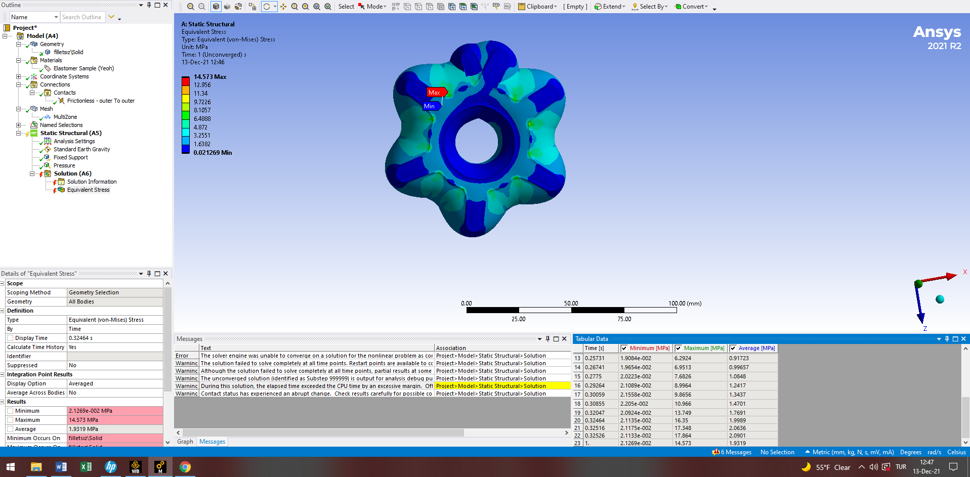

My nonlinear analysis is unconverged how can i fix this problem
    • emregny96

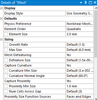

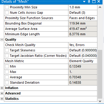

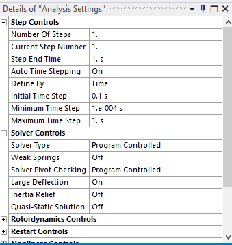

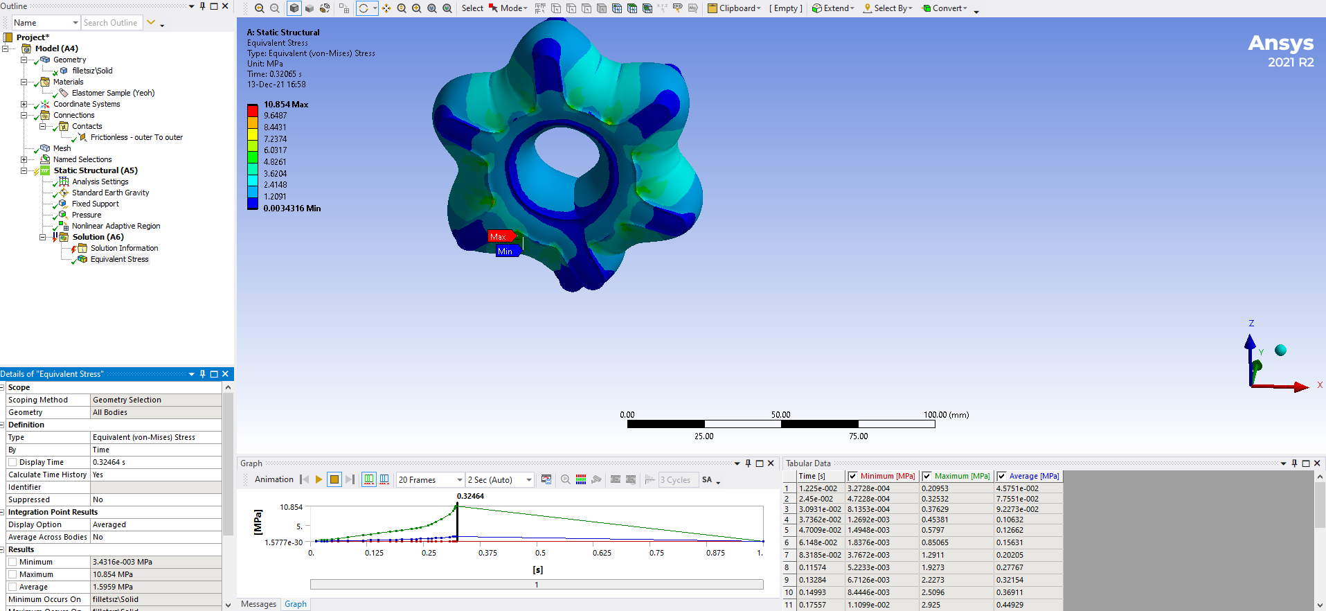

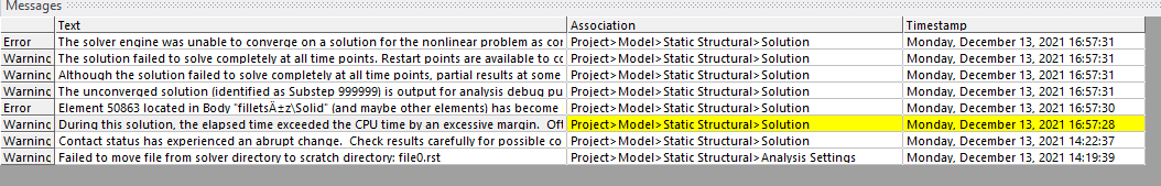

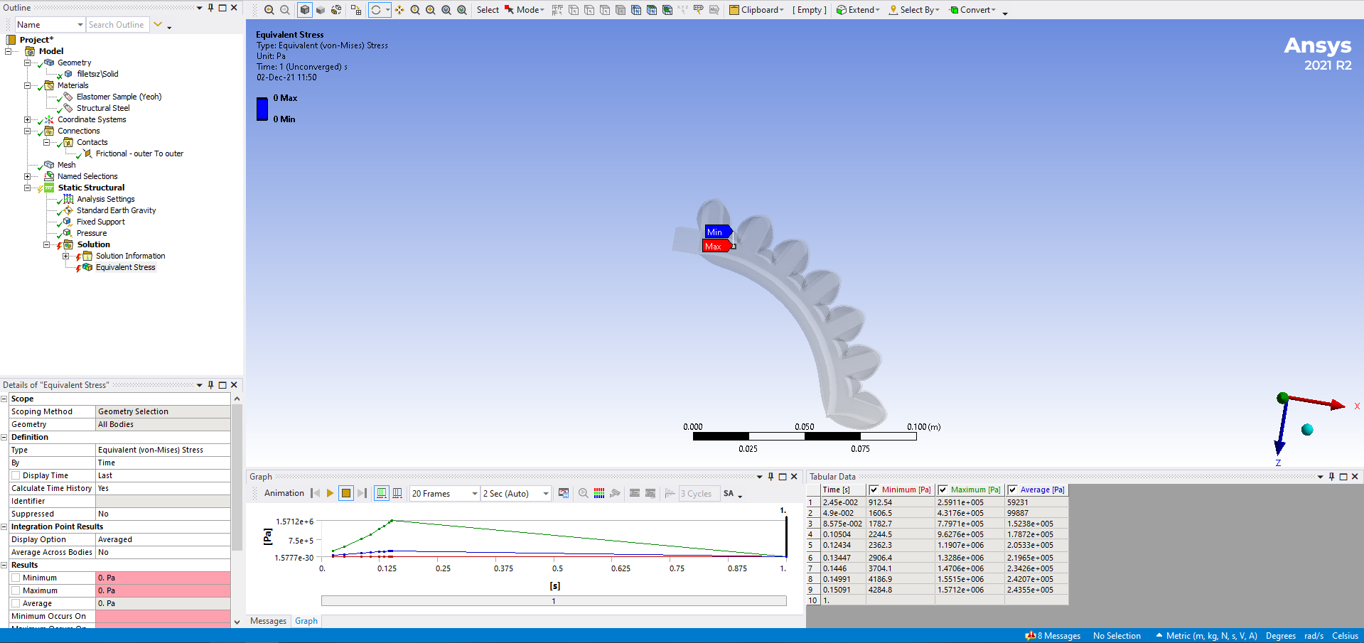

      as you can see in pictures my simulation stop at specific time and it gives unconverged solution.I tried many times but i didn't get result of 1 sec. you can see my settings i gave 1 mm mesh size element quality is 0.84.

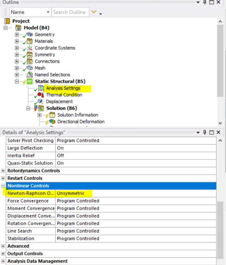

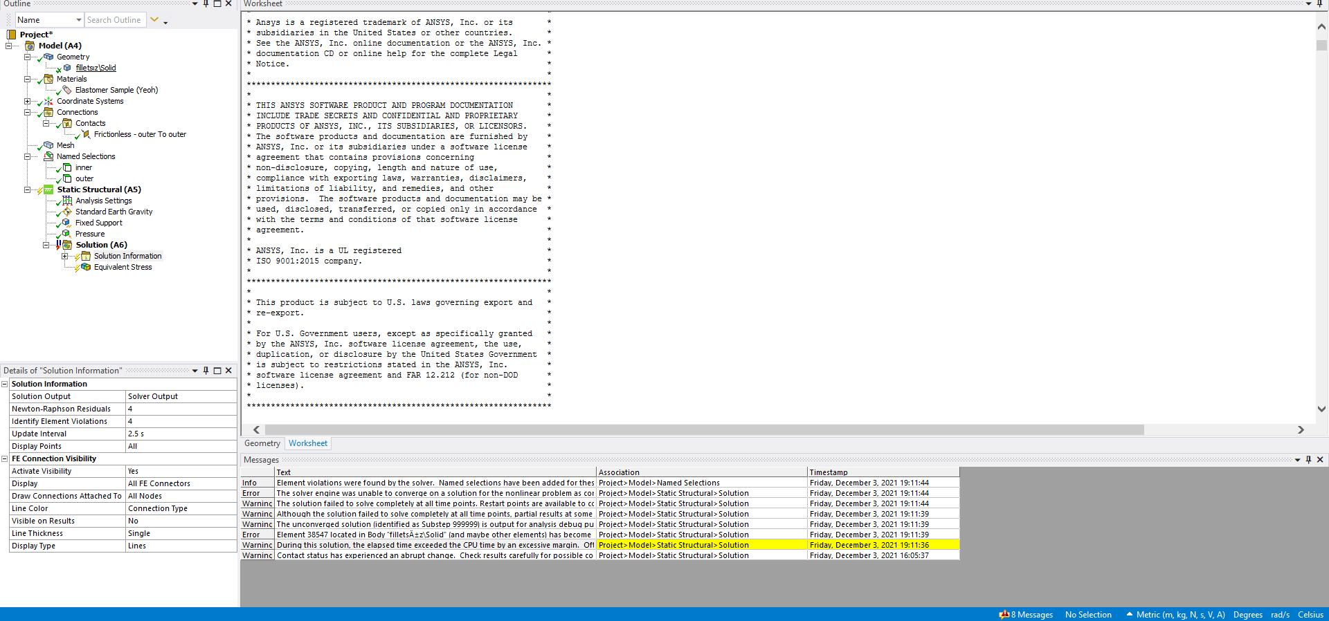

      Convergence can be very tricky to solve. You can try to change trim contact to OFF under frictional contact and as you have a frictional contact you can change Newton Raphson option under Analysis setting>Non-linear control to unsymmetric.

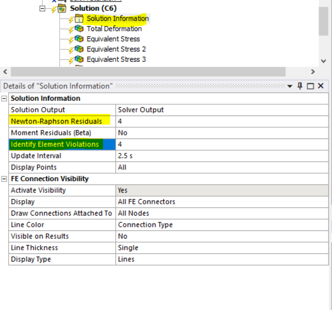

      Also, can you share the error messages you are getting and you can also check Newton-Raphson residual and element distortion to check the problematic area.
      Regards amaniyar

      WHEN I SOLVE IT G─░VES THIS ERRORS
    • Akshay Maniyar

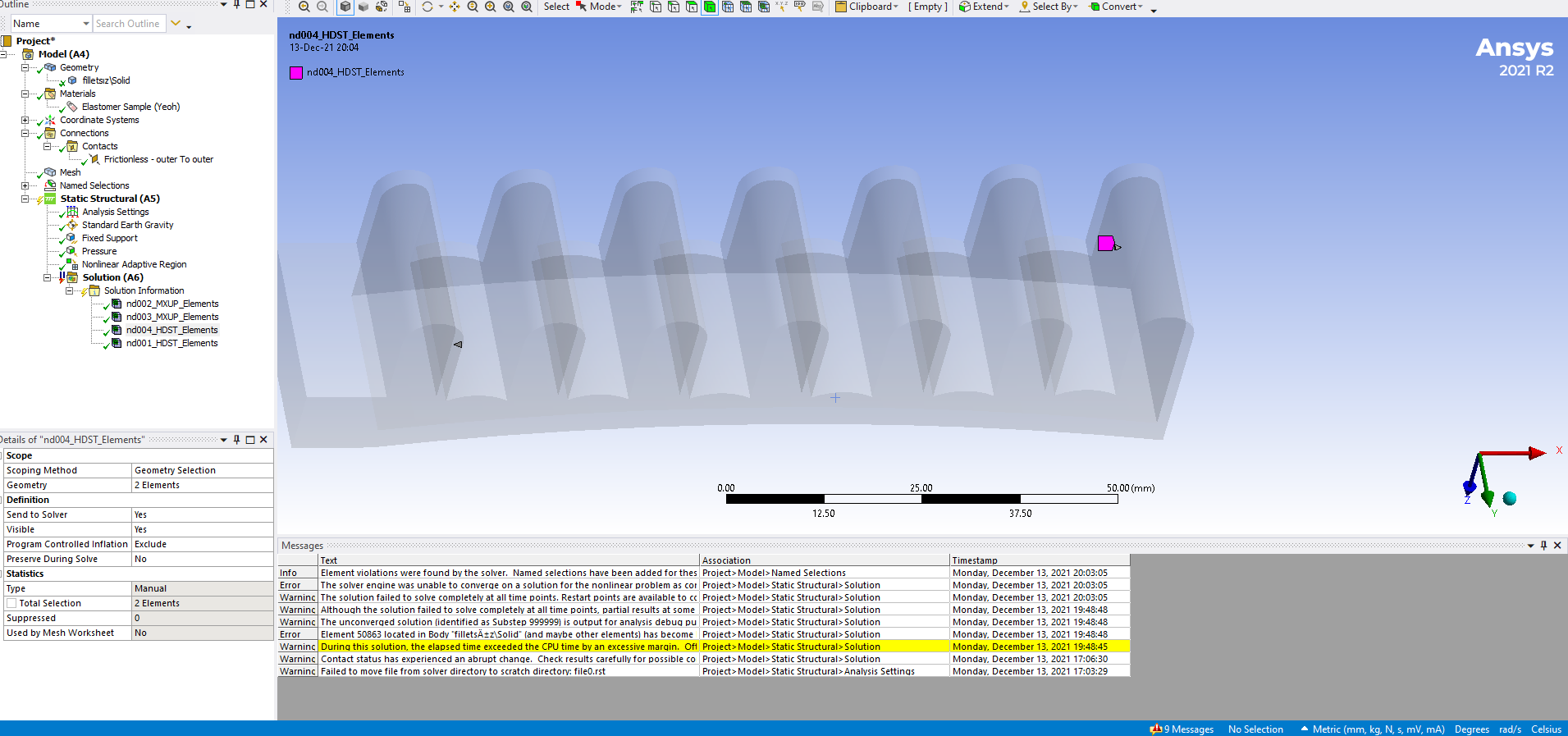

      It is a element distortion issue. Can you check the video I have attached. It explains various ways to handle such issues.

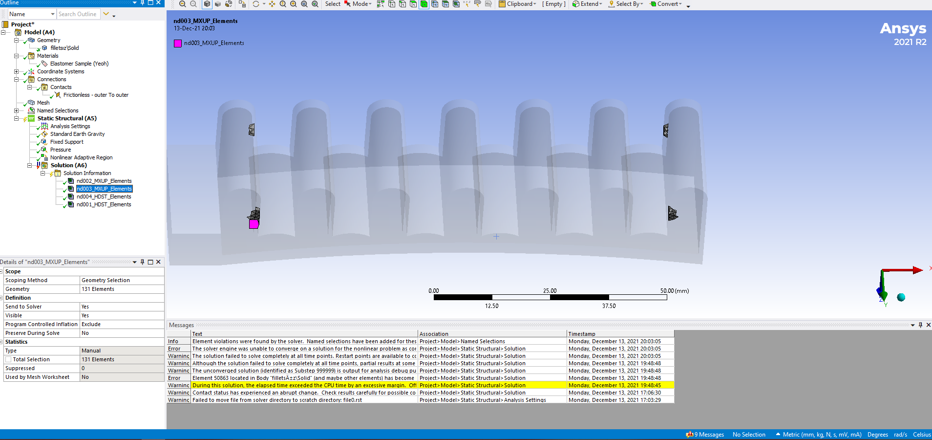

    • Akshay Maniyar

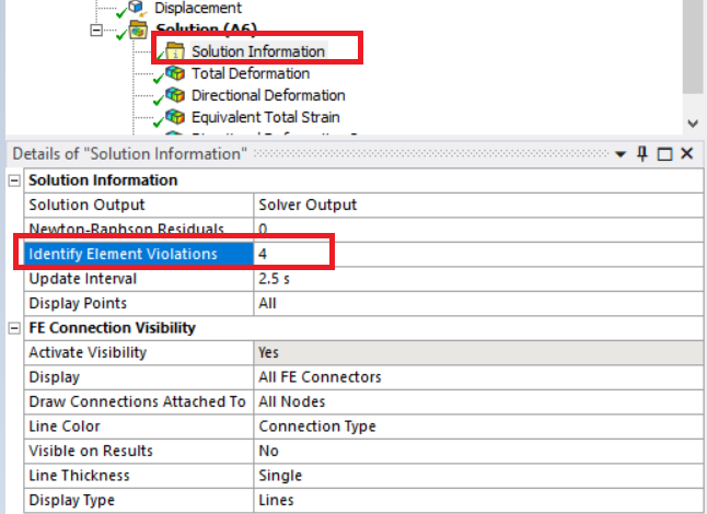

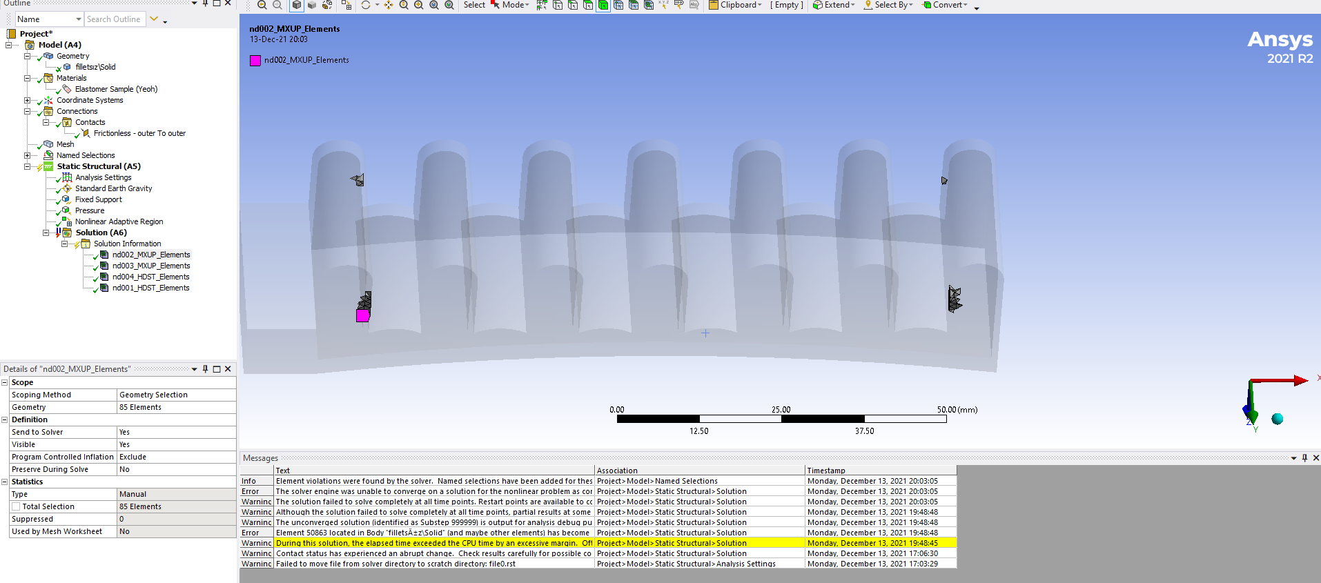

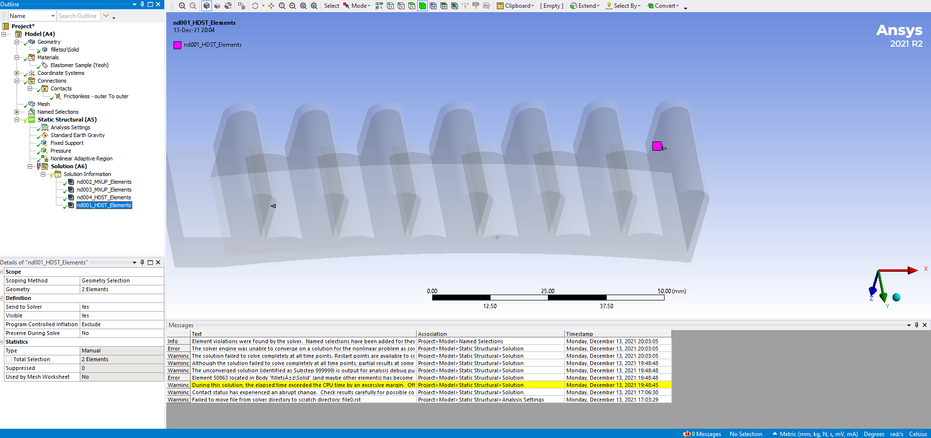

      Can you check which elements are having distortion issues, just change 0 to 4 so that it will create a named selection after the run.
      Also, you can use NLAD technique, so that it will get remeshed as element shape is getting bad.
      Thanks Amaniyar
      Hi In your Dec 3 post, there was a Highly Distorted Element error that stopped the simulation, so Identifying Element Violations was useful.
      But in your post of today, there is not a Highly Distorted Element error that stopped the simulation, it just didn't converge.
      I expect this material should be a hyperelastic material model. Please review the following discussion for more ideas on convergence.

      I tried your NADL technique suggetsion but same.It stops at 0.32464 now i m trying to do which elements are having distortion issues.
    • emregny96
      Also you can check Element violations
