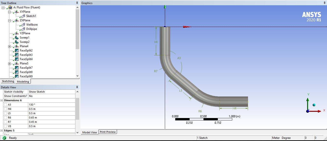

      I want to model a drilling operation i.e to build a cutting transportation model through the annular fluid.  I have used the Sweep method too but it works only for wellbore not for drillpipe. Please check the attachment:
    • Keyur Kanade
      first of all get geometry connected with share topology.

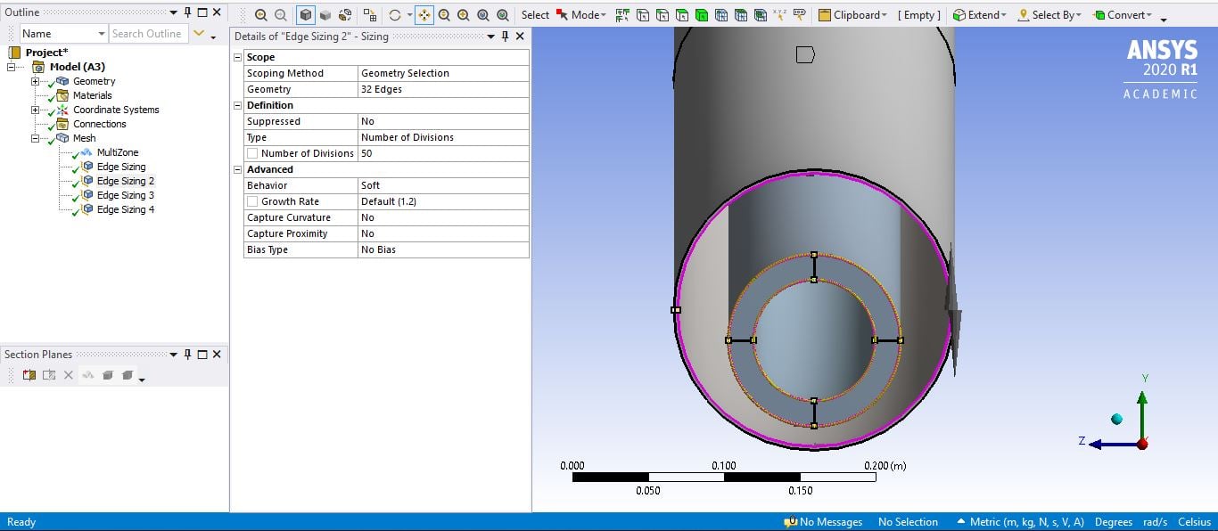

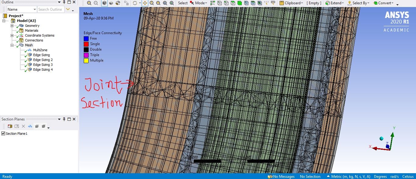

      Here i am sharing my mesh details with geometry.....
      please verify it that i have done anything wrong here.
      Mesh
      Sectional view
      In joint section
      Mesh details, which i have done:
      Geometry Details, Which i have used:

    • Keyur Kanade
      i can see some tet mesh in your images.
      please seletct source and target faces while defining multizone.
      if multizone fails, you can also try sweep method.

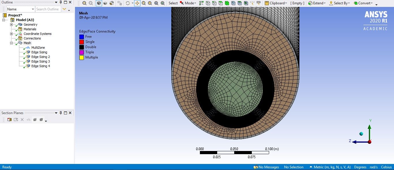

      Hi
      I have tried all your recommended options but its still not working (i.e in mesh face mesh option is not working).
      If i don't form new part then i find a good mesh, is it ok or not, i need your concern:
      cross-section of soild pipe:
      regards
      Zico
      Turn off all the local sizing and set the global values to be something sensible. Use a multibody part and turn off multizone. What happens?
