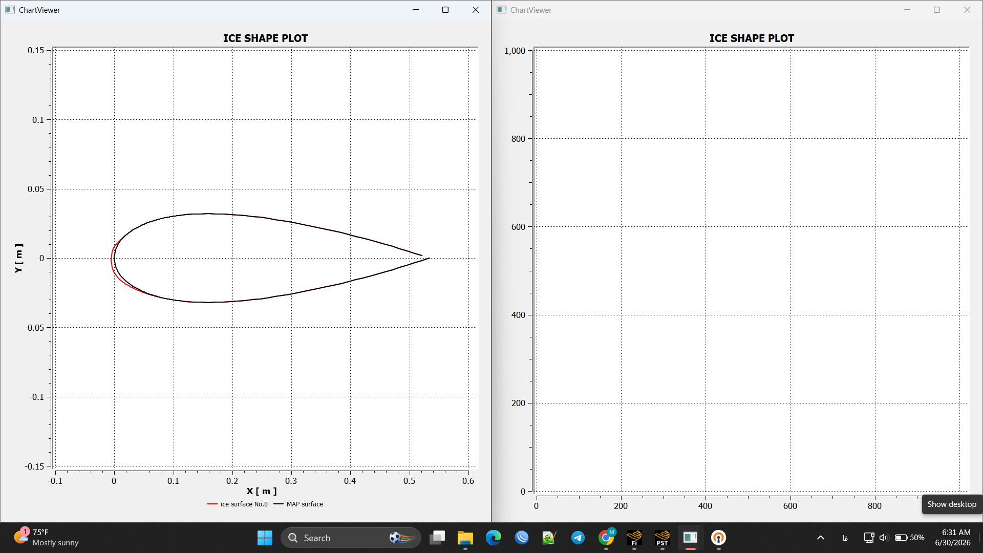

I am using Fluent Icing to simulate ice on an 3d airfoil. When I use ICEM-CFD for meshing, at the end of multishot in cfd-post the ice shape of each shot is displayed in the macro calculator, Ice Cover - 2D plot. But when I use fluent meshing, the 2D ice plot is empty and the .csv files are empty. How can I solve this problem so that I have the airfoil and ice formation coordinate file?
.png)

What type of mesh elements are you using while working with Fluent Meshing?
July 3, 2026 at 7:45 pm
moham.moslemi
Subscriberi'm using tetrahedral mesh because the poly mesh is not acceptable for fluent icing 2025. the hexcore mesh type is not good at orthogonal and skewness quality. however i use tetrahedral.
