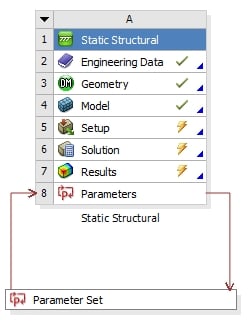

SubscriberHow can I run multiple simulations on the same model with variable mechanical properties?
For example, let's say I have a rod that I am applying a tensile load to. I want to simulate the given load with multiple different values for the stiffness to look at how the results change with different values of stiffness. Lately, I have been creating new Workbench projects each time I change the stiffness so that I can view results for each set of data. But, is there a better way to do this?
That is, is there a way to input a set of stiffness values? Then, ANSYS will do the simulation for each stiffness value while still allowing me to plot the results for each stiffness value?

SubscriberThis is how to automate a parameter study
In Engineering Data, click the checkbox after Young's Modulus to turn it into a Parameter.
If you have a Static Structural analysis and you have a Deformation result, you click the P box next to the Maximum.
Then on the Project Schematic, you double click on the Parameter Set box
Then in the Parameter Set, you type a set of values for Young's Modulus, then click Update All Design Points [Corrected].
ANSYS will go off and calculate a result for each value of Young's Modulus and put the Total Deformation Maximum into column C.

SubscriberYes you can have a complete solution for each row of the Parameter set. Past column C where the Deformation result will be put is a column titled Retain. If you check of every row, then the full solution will be retained and you can call each one up using the Set Current when you RMB on a row.

SubscriberI apologize for asking another question on this thread. The only thing I can't find now is where I can click Evaluate All Design Points. Is that within the Parameter Set?
December 4, 2018 at 2:38 am
peteroznewman
SubscriberSorry, I meant to say Update All Design Points, which is the button on the top left of the image above, so I edited the original, thanks.
