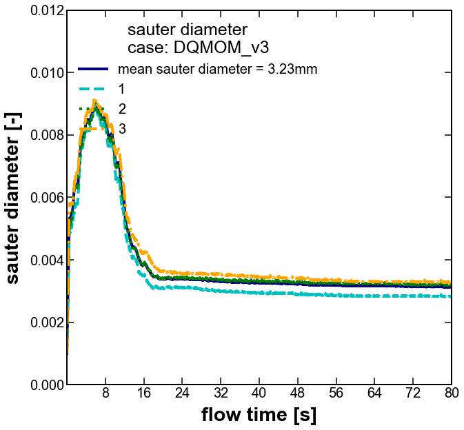

Thank you for your advise. I could fix the Problem by using the gas-volume-fraction instead of the inlet velocity for splitting the gas-phase in 3 secondary phases!Now the calculation is running without errors.
I have another question with respect to the DQMOM inlet-BC. After using Wheeler moment-inversion ANSYS gives abscissas(diameter values) and volume fraction + m4 (both calculatet from the weights and abscissas) for the inlet BC. When using m4 values for inlet BC simulation is running without problems but the sauter diameter from secondary phase is nearly similar. With this flow profile(velocities are similar too). I expect 3 different phases with different flow profiles and sauter diameter. Absciccas here where : QP0 = 13 mm, QP2 = 10, QP3 = 8 mm. PBM options max. Length = 10mm; min. Length = 1mm; reference Length = 6.3 mm
Sauter Diameter is very low in comparison with discrete and QMOM Method (6.7 ans 8 mm).
Is it really enough to give m4 and vof values from moment inversion for inlet BC to define the different secondary phases?

Yannik Danner
SubscriberHey, yes thats what I expect. Caclulating weights and lengths is meaningful.
This is my moment-inversion:
                            QP0                   QP1           QP2
 Length (m)            8.542875e-03     6.586689e-03     5.078440e-03
 Volume Fraction      9.340751e-02     3.345744e-01     7.201864e-02
 DQMOM-m4 (m)    7.979686e-04     2.203738e-03     3.657423e-04I have 3 secondary Phases (Air1, Air2, Air3).
For BC is used: QP0 -> Air1; QP1 -> Air2 and QP2 -> Air3 (volume fraction and dqmom-m4).
When starting Simulation I expected that the Sauter-Diameter for each phase at the inlet is:
Air1 ~ QP0(length); Air2 ~ QP1(length); Air3 ~ QP2(length);
But all Sauter Diameter start at 0.001 m (thats what i defined the min Size). Its not even in the NDF what i used for inlet BC.
Why? how to define these diameter values? They are the essential values for calulating velocity.

I have another question, sorry.:
I saw that the Simulation gives Sauter mean diameter for regions with vof = 0, Sauter = 0.001 m = min. Length. Maybe thats not considered in global mean diameter and thats why its this low.
Do Ansys calculate the Eulerian velocity based on the Sauter diameter for each cell, or based on the global sauter diameter?
