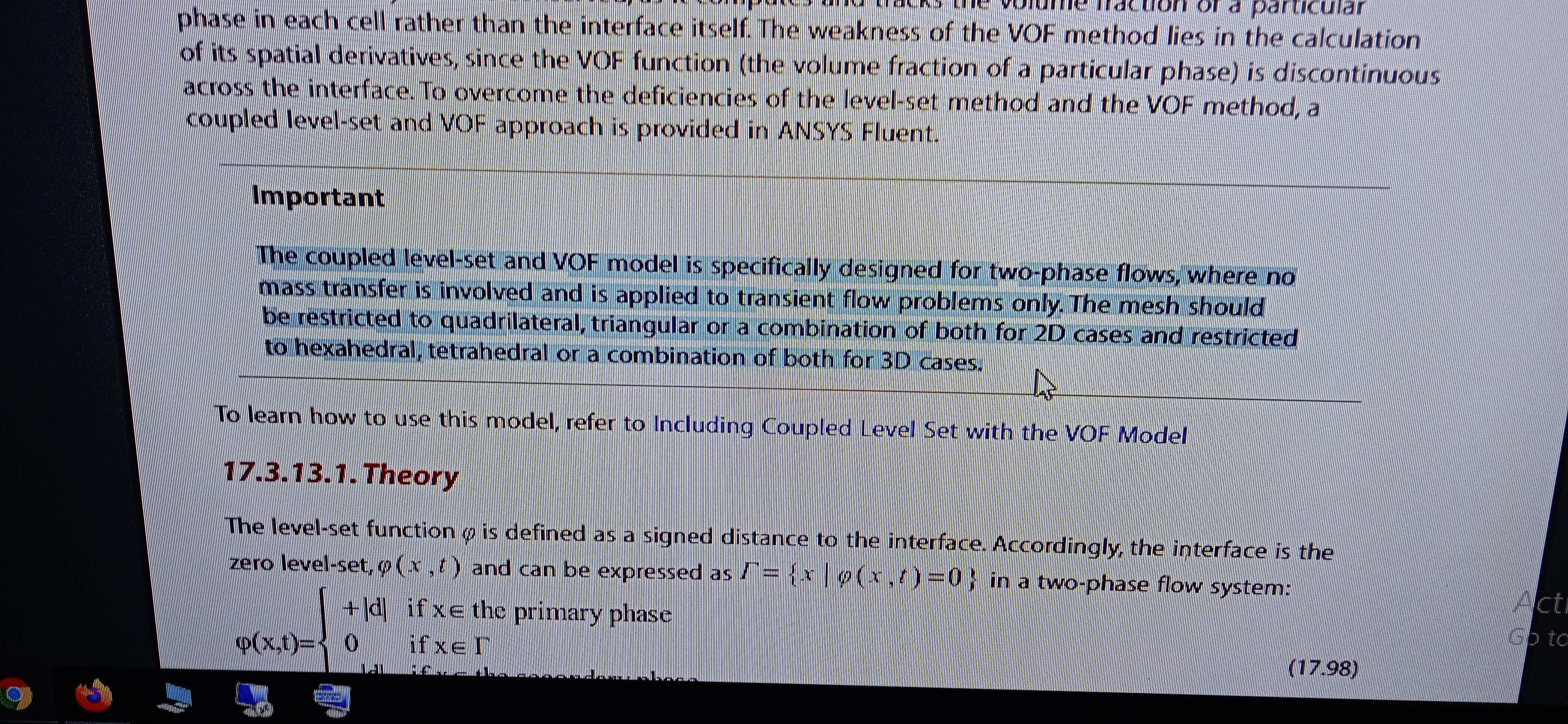

      I read about limitations from Ansys guide book about limitation
    • tumulpurwar
      We tend to avoid poly-hexcore around the VOF interface, but the solver does work on those types of cell.
      Now the image loaded...... CLS is an older model and struggles with several newer features. I don't use it.

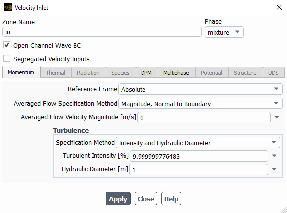

      Velocity inlet: open channel bc.
      Pressure outlet: open channel bc
      Sides were symmetry.
      Seabed was wall
      Sky was a symmetry plane.
      I want to know,have you wrote it wrong, as Velocity inlet:open channel doesnot work in VOF...pressure based inlet & outlet work only.Can you explain please?
      Thanks

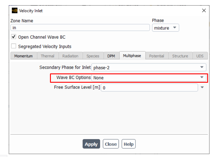

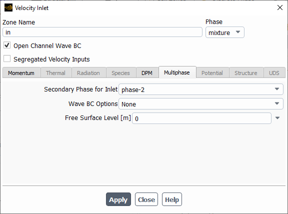

      You need to turn waves on (not sure why) and then set the wave option to none.
    • tumulpurwar
      Thanks Rob,i was selecting ever "open channel" only instead of "open channel wave BC".thats why was not getting velocity inlet option.

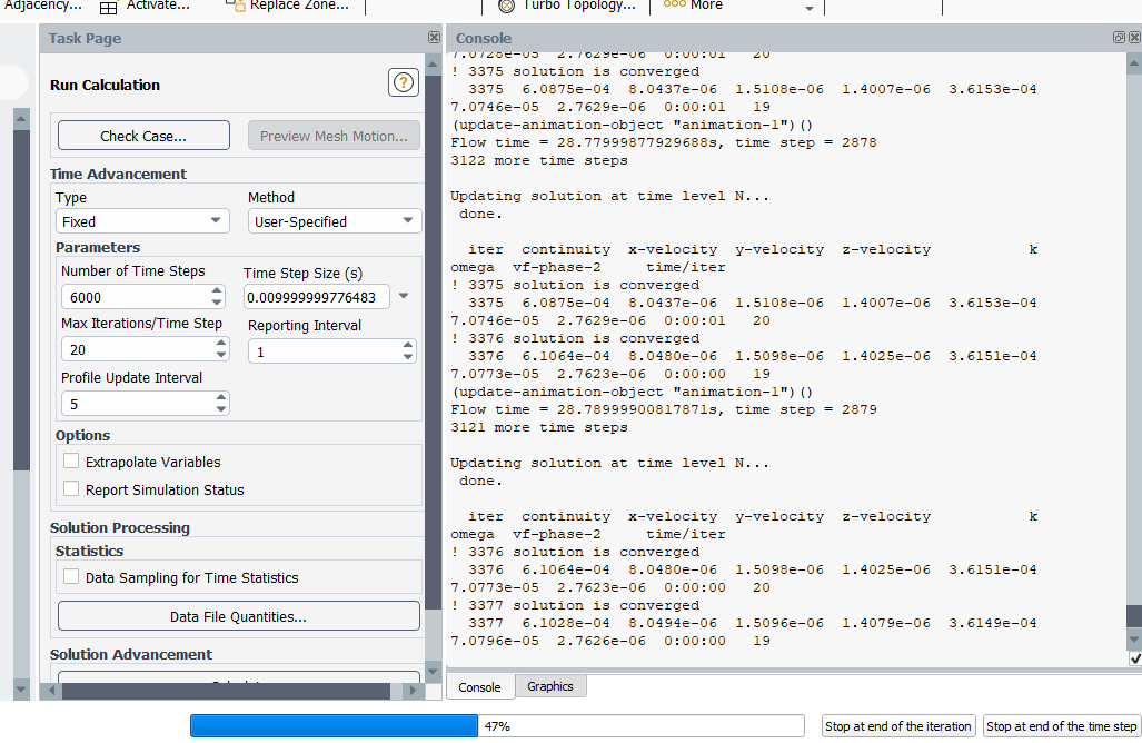

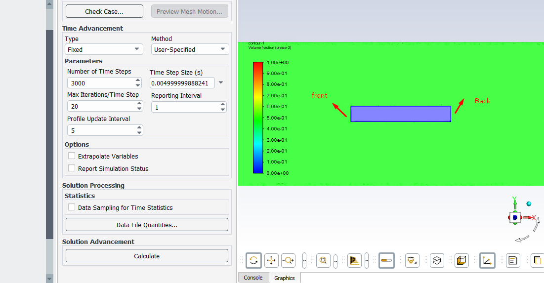

    • tumulpurwar
      Hi Rob

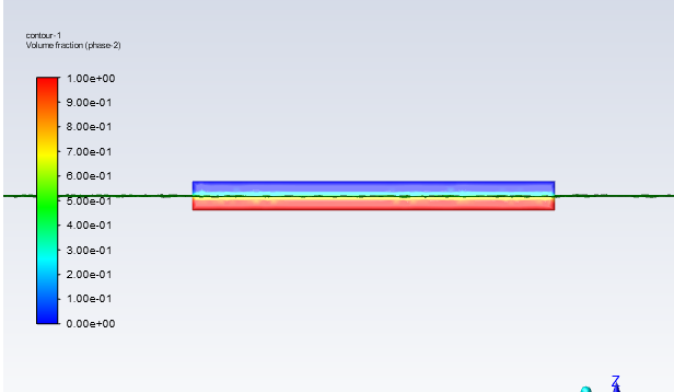

      If i am trying STEADY STATE , than my solution convergere, but i can understand that results graphically are wrong.
      If i do transient state, my graphical results looks correct, but solution only converge on steps, but not globally even after running 3000 iterations.
      What can be the reason?
      I have further currently increased my iteration to 6000, to see if transient solution will converge or not.
      Thanks
    • DrAmine
      What do you mean it converges on steps?
    • tumulpurwar
      Hi DrAmine, i meant to say this, regarding convergence....and for globally i meants say like i am running for 6000 iteration, it should somewhere stop before 6000, and should tell the solution is converged.
    • DrAmine
      Why shall it stop? Are you defining interruption criteria? If you run for 6000 Time Steps it will run all these time steps ( if there is nothing defined to stop the run).
    • tumulpurwar
      Hi, I am bit unclear, like in steady state, it stop in between and say solution is converged.
      In transient which currently I am doing, don't it ever stop and say solution is converged?
    • DrAmine
      I does stop if the requested time steps are finished (or total flow time is reached), or in case you define an interruption criteria it will stop or if you stop. Every time step you might see a time step convergence and Fluent will write a message telling that the time step has converged.
    • tumulpurwar
      Ok.. Thanks DrAmine.

      Wherever i have checked any research paper regarding calm water test of ship with cfd..they always used Velocity inlet...i also wanted to use velocity inlet, but i dont see option in my license which ROB suggested few days back in his comment in this Post.
      This red box i dont have
      Note: I dont need waves because its calm water test
    • tumulpurwar

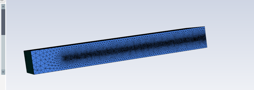

      Hello DrAmine
      One more question

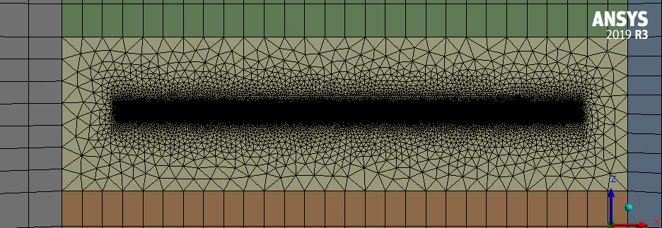

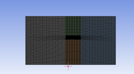

      Why i am not seeing kelvin wave pattern on back side of ship(i took currently for simplicity, ship shape as simple primitive cuboid) with some draft say 0.28 , it is 7 meter in length
      my mesh
    • DrAmine
      I do not understand the issue with Velocity inlet.
    • DrAmine
      Temporal and Spatial resolution whenever you are "playing" with waves especially if the waves appear due to Coriolis forces (not present in your case) or due to bow-waves past the ship.

      May be my mesh is not good that can be possibility , i am refining it further, but please can you answer my above doubts...i ever see in youtube people for hull simulation used Pressure based inlet..but whenever i looked for research paper they always used Velocity inlet based...i dont understand, for me it looks both are same condition...Am i correct in understanding or i am misunderstanding these both inlet conditions?

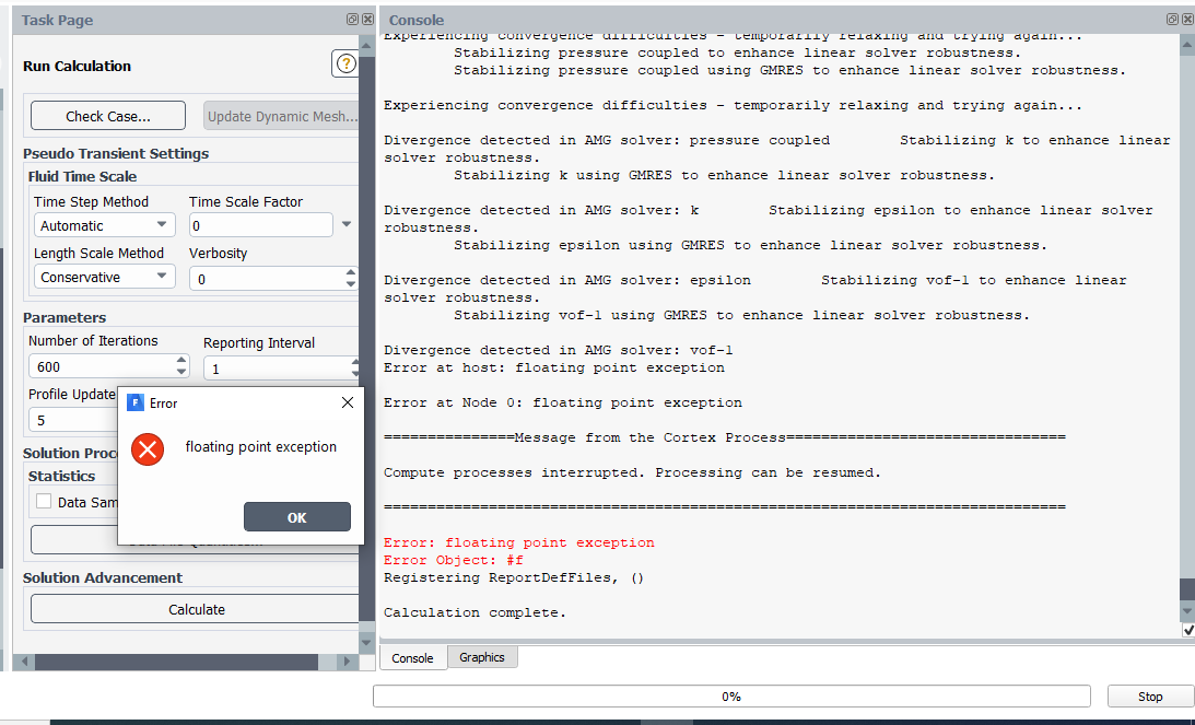

      Also in steady case my solution fails and says its finding difficulty in converging the solution, and if i try Transient, than it converge, what can be the reason of it?i am just doing calm water test of ship model

      Hi DrAmine
      Thanks...i had bit misunderstanding..i have that option in velocity inlet, just saw, so now issue is solved.thanks for help
    • DrAmine
      You can use whatever you want to use for BC at inlet: only what you now is important. So if you know the speed and free surface level / or the wave-theory just use Velocity BC.

    • tumulpurwar
      Hi DrAmine
      I dont understand, why my simulation of vof is failing in STEADY STATE?..but PASSING/CONVERGING in TRANSIENT...why?

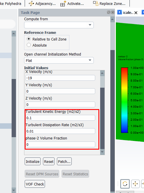

      Hi DrAmine

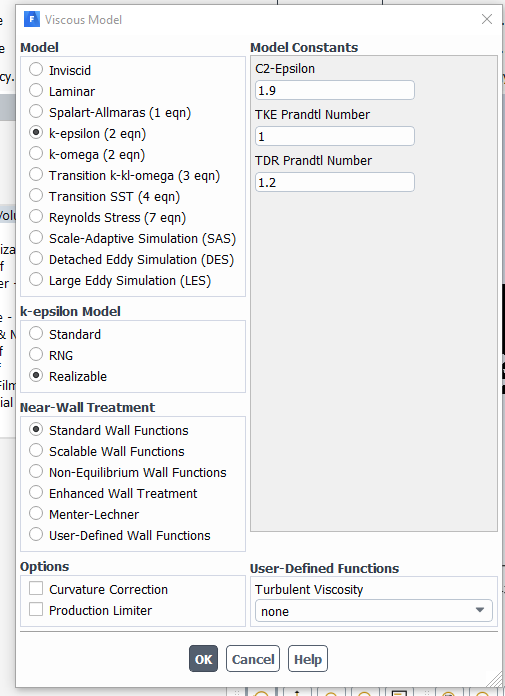

      There asre so many types of wall functions under WaLL TREATMENT CATEGORY FOR MY HULL DRAG CALCULATION..FOR K E MODEL, WHICH WALL FUNCTION I NEED TO USE
      Also i manually put theses values to 0.1 & 0.01 for the red boxes...normally what are the correct initial value i should give to start with?

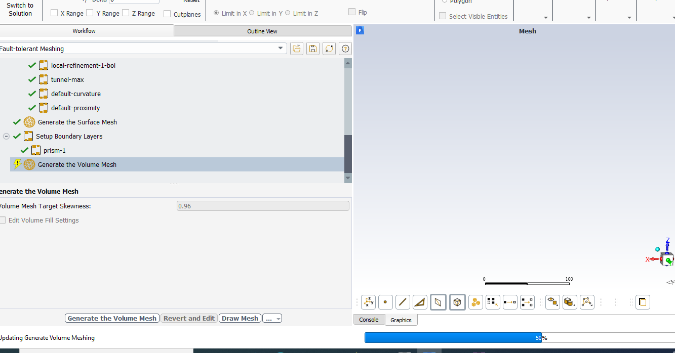

      IS ANSYS FLUENT MESHING IS SLOW ?
      SINCE 1 HOUR STUCK ON 50% FOR VOLUME MESH
    • DrAmine
      Actually not. It is known to be very quick.
