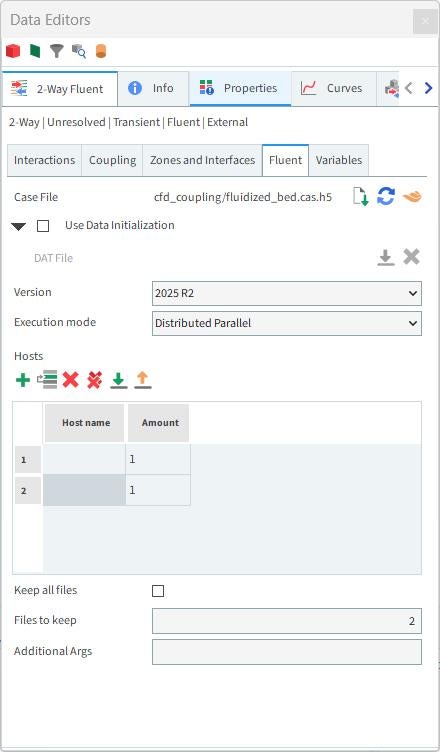

      Below you can see an image of the 2-Way Fluent menu in Ansys Rocky. In the "Fluent" tab, you will find options related to the processing of the simulation.
      undefined
      As mentioned, you are looking for distributed parallel execution.
      You can set the Execution Mode for Ansys Fluent as "Distributed Parallel", which will allow to choose different hosts for processing.
      I believe there is valuable information regarding parallel processing in the Ansys Fluent documentation.
      Please, check the Fluent User's Guide, Chapter III - Solution Mode, Section 44 - Parallel Processing to see if there is any content that may help you further.

      Thanks for the reply, I am familiar with the "distributed parallel" option under the Fluent tab on the Rocky GUI, and that's the option I select when setting up the simulation. However, I can't use the GUI after I transfer the files onto an HPC, since that's where I want to launch it on.
      To summarize, I'm attempting to launch Rocky with Fluent integration. I need to specify multiple nodes for Fluent Distributed Parallel mode. My system is using Slurm to schedule compute nodes, so for each run the nodes may be different. Is there a way to set these nodes dynamically on launch from a command line either by an argument or via a configuration file?
      My current command line launch command is as follows:
      Rocky --simulate "RProcky.rocky" --resume=1 --use-gpu=1 --gpu-num=0 --gpu-num=1 --gpu-num=2 --gpu-num=3 --ncpus=4
