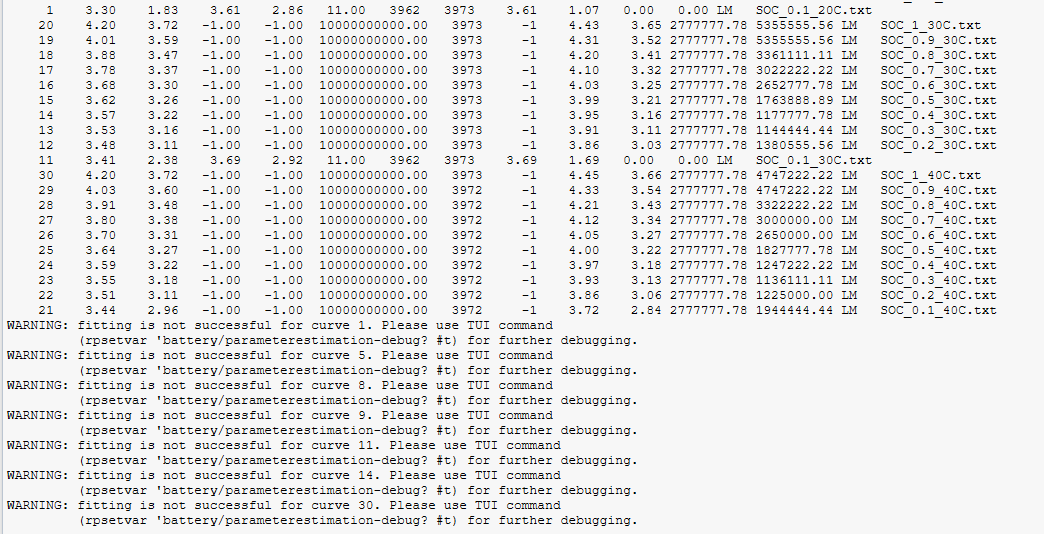

      Hi everyone,
      Can you help me please with fitting results HPPC test problem?
      I did experimental HPPC test. (1 hour rest period, 5 minutes relaxation period and 10 seconds pulse.)
      and I uploaded inside MSMD battery model.
      as you can see from picture, it is shwoing a problem.
      if I did wrong test, then it should show that all the data is inccorect. but there are only some of them incorrect.
      can anyone help me please?
    • chinmaya.bhakta
      Hello Arman,
      Do following changes in the hppc test and you may get curve fitting.
      1. relaxtion between 60 to 100 sec.
      2. discharge for 20 sec.
