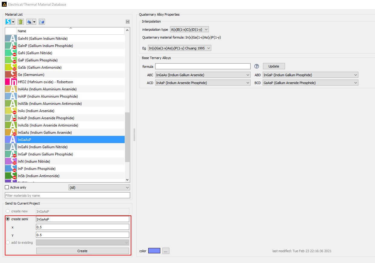

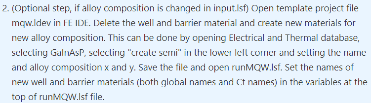

I'm using the model of MQW edge laser https://support.lumerical.com/hc/en-us/articles/360041725214 but with different composition number in InGaAsP. It says
March 11, 2022 at 2:12 amKyle
When you create a new quaternary alloy material in the Electrical/Thermal database, all of the required properties for the MQW solver should be set according to the new composition using interpolation (https://support.lumerical.com/hc/en-us/articles/360034398494).
Creating quaternary materials in this way is a newer feature, you might need to update your software to use it. This should calculate all the required properties for the MQW solver, using the buildmqwmaterial command shouldn't be necessary for this step.
