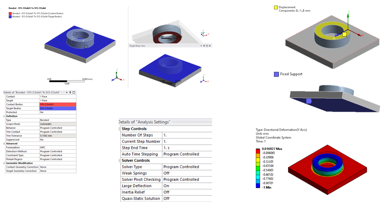

SubscriberHi,

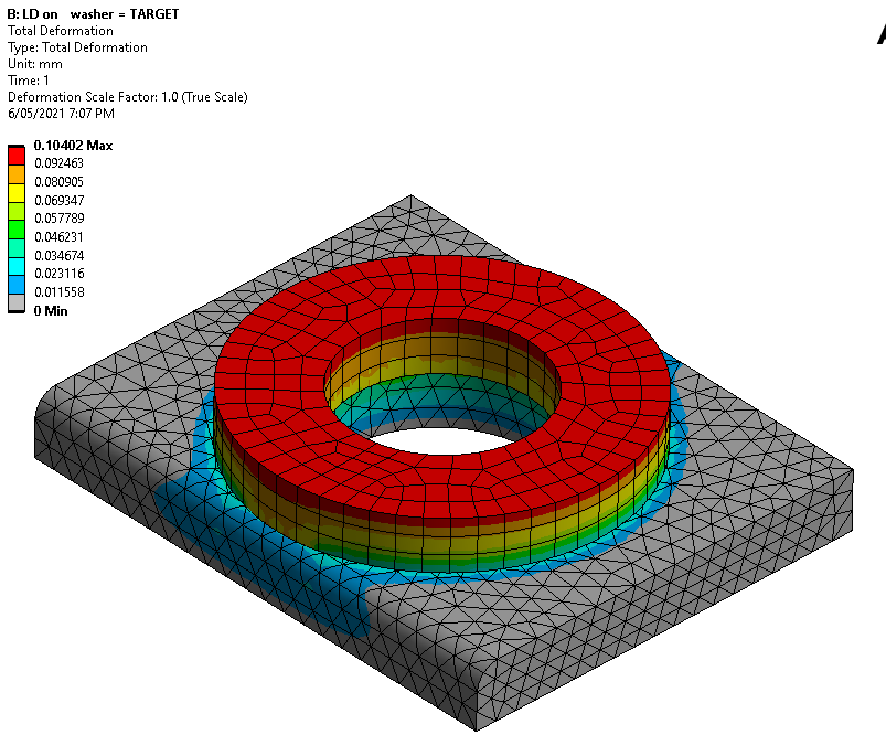

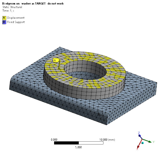

simple model:
- Fixed Support: bottom surface of plate
- Displacement: 0, 1 mm
- MPC-Bonded Contact between Washer & Plate
- Large Deflection: On

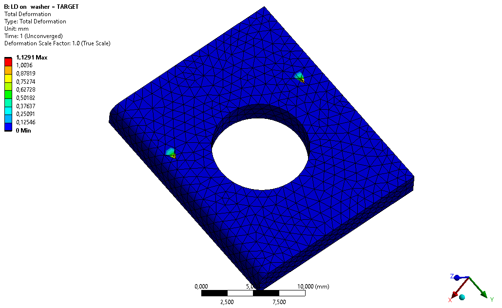

May 5, 2021 at 6:22 pmpiknockyou
Subscriber:
Thanks a lot for your work, but you can not reproduce my case with a different mesh (by the way: contact/target are flipped at your end). As already mentioned: I presented you a very simple model, but lately (2021 R1) I've been getting this element distortions more and more often between MPC-bonded contacts of different geometries - be it small, simple or very large models. It is random.
I get the same result for both solvers.

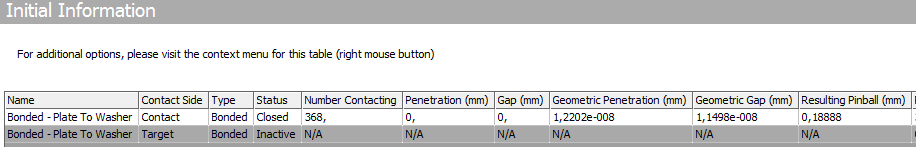

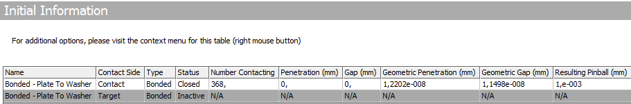

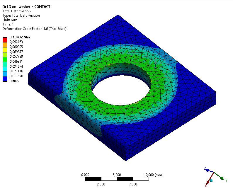

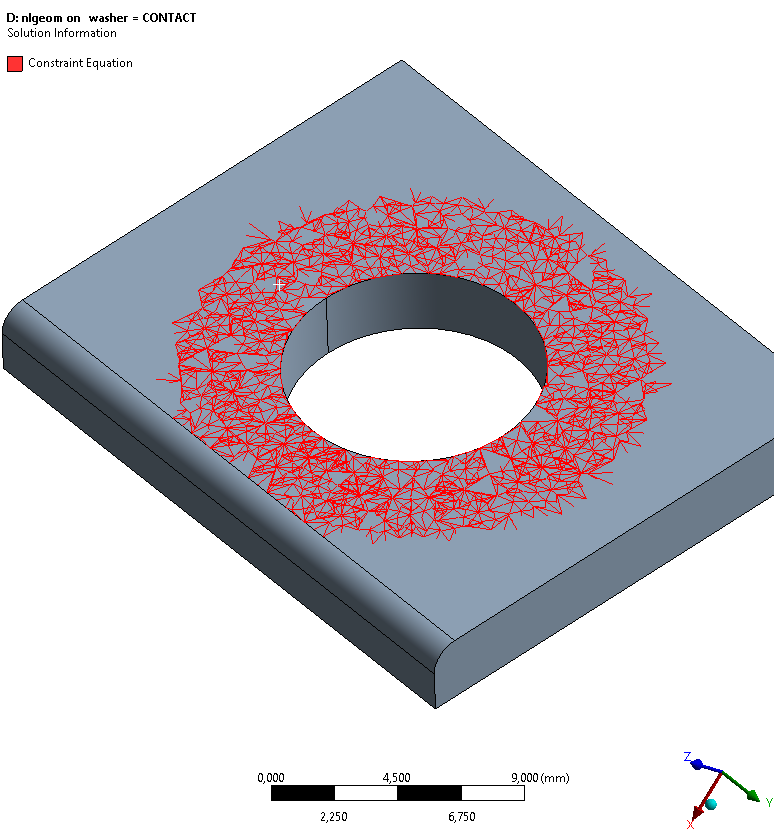

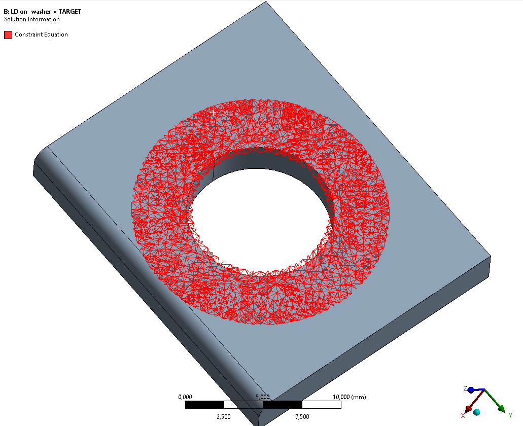

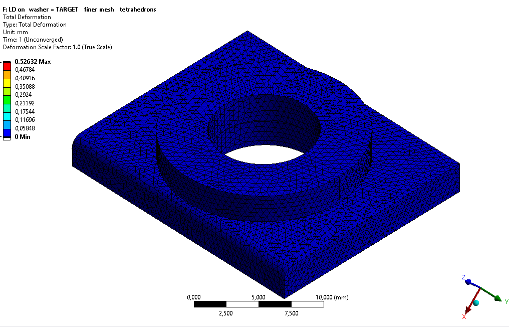

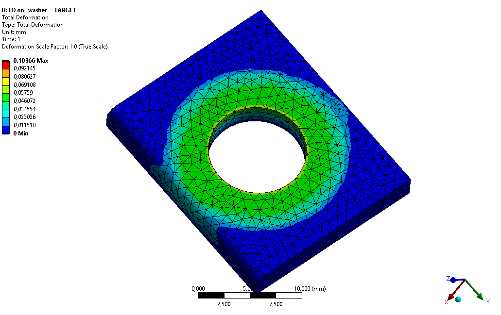

For further investigation I solved several models with different Pinball Radii.
Figure 1: Initial Information from the Contact Tool

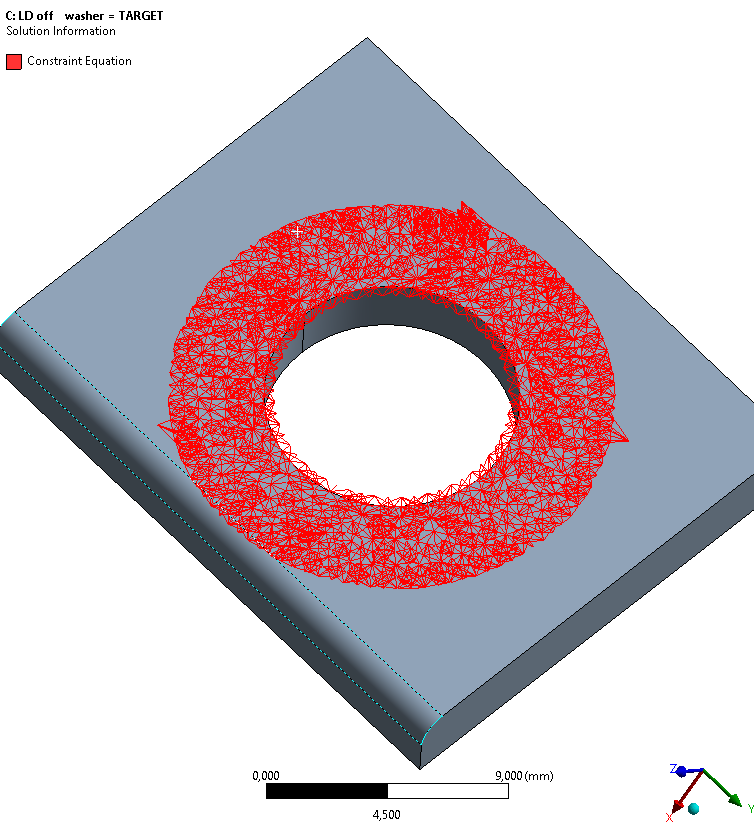

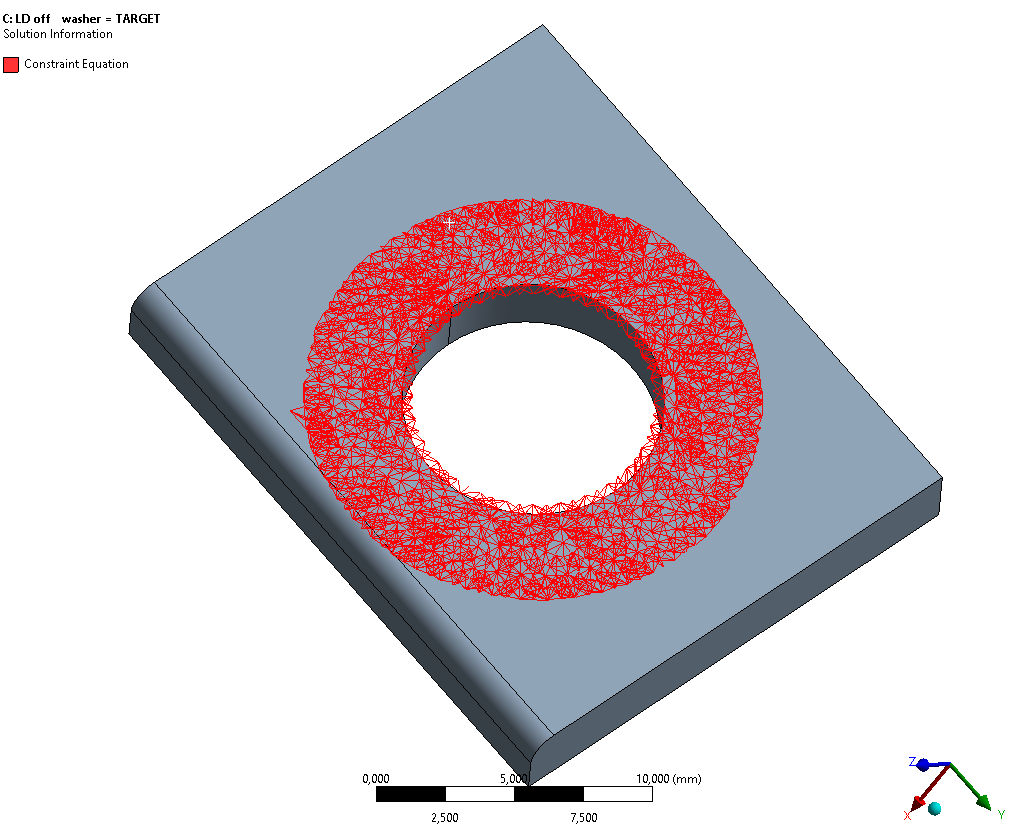

Figure 2: Constraint Equations (for illustration purposes) after successful solution with Large Deflection: Off.

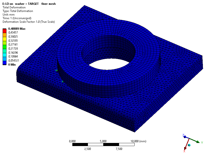

Figure 3: Total Deformation with Large Deflection: On.
Case 1: Pinball-Radius: 0,18888 mm - Unsuccessfull!
Case 2: Pinball-Radius: 1 mm - Unsuccessfull!
Case 3: Pinball-Radius: 0,001 mm - Successfull!

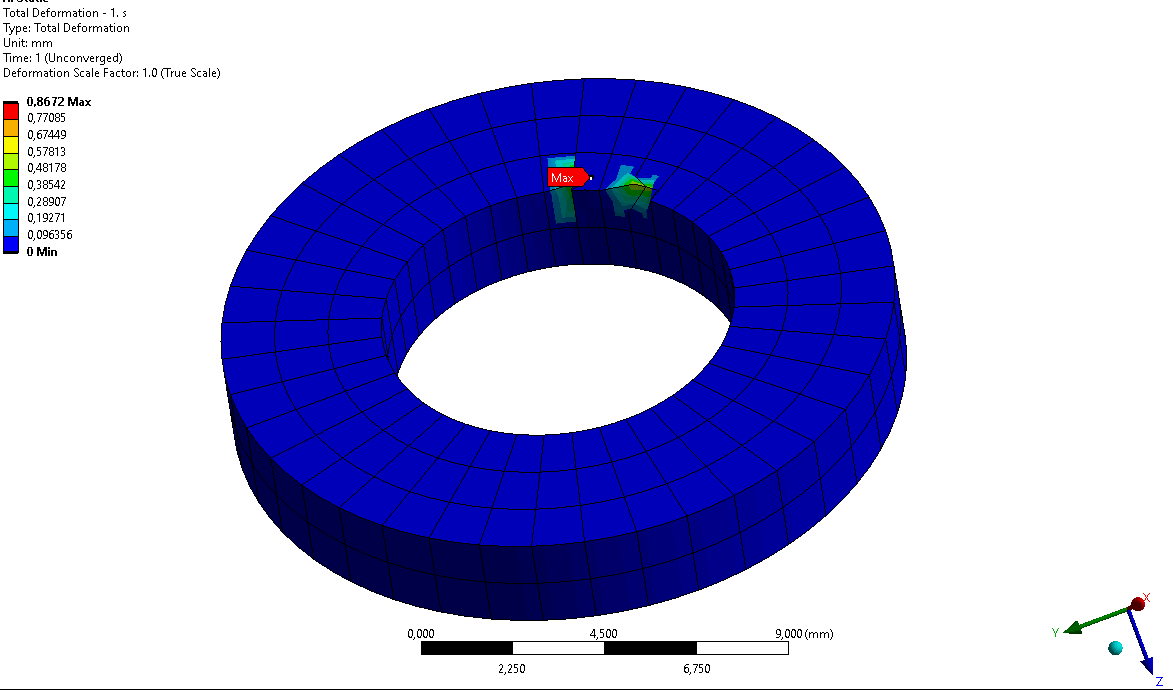

Case 1 & 2: You can clearly see that some constraints are built behind the Washer Diameter. Those are the spots where the element distortions occur.
Case 3: If I set the Pinball Radius very small, no constraint are built behind the Washer Diameter and the solution is successful.

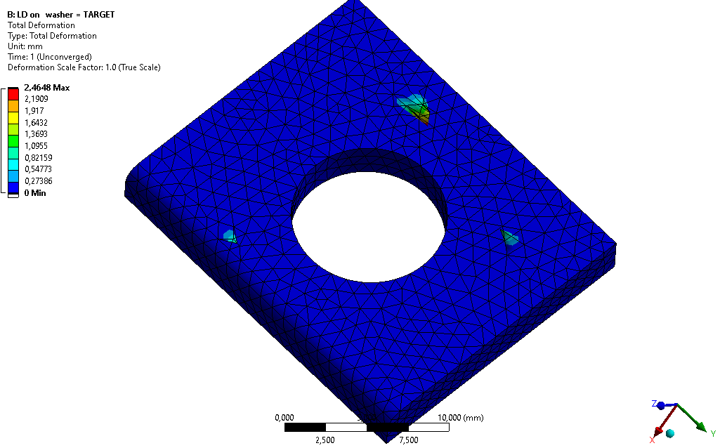

Case 4: Another way to avoid constraints behind the Washer Diameter is by switching from "Nodal-Normal to Target" to "Nodal-Normal from Contact" . This will produce the exact same results as pictured in Case 3.
All Cases will successfully solve when Large Deflection is Off.
I can not comprehend why constraints behind the touching regions should be of any problem. Especially when I flip Contact/Target side, the constraint equations become even "wilder" regarding their spread ...
... but it solves flawlessly:
But this is not always the case! Sometimes the other side gets distorted! This was just an illustration, not an acceptable workaround for me.
Is this a bug?
Please help me to resolve & understand this issue.
This happens randomly & is not very uncommon anymore.
Did this never occur to you?
Thank you!

Other than pinball readius, my first impression is that the mesh is too coarse, this thinking is similar to what you have already discovered, a finer mesh will help keep the constraints closer to the contact region.

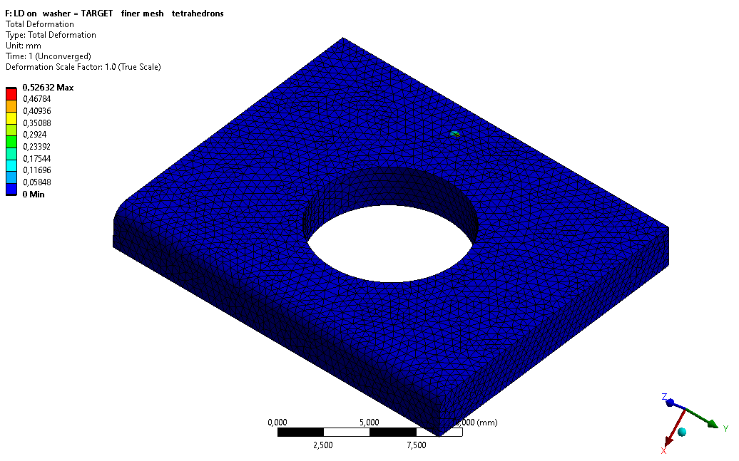

I do not share the opinion, that the mesh is too coarse at this location. In relation to the geometry dimensions I believe the model has a pretty good mesh resolution, especially because I am not trying to evaluate stresses. But anyway, here you go:
This seems to be not a mesh related issue (tetrahedrons for Washer):
I am solely here to understand what & why this is happening.

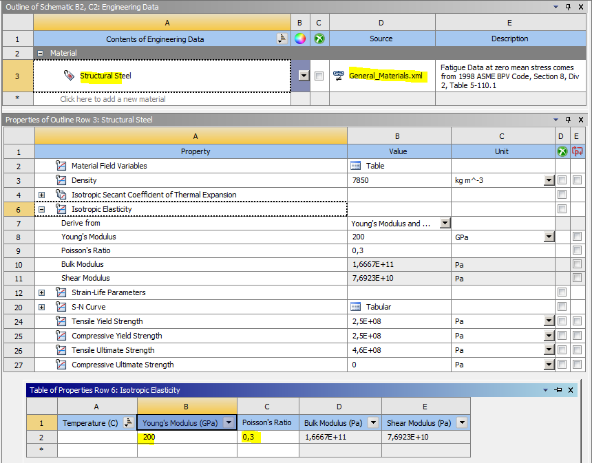

Are you using structural steel in these analysis? any nonlinear materials?
This is an odd guess, but we have had issues that have been fixed by replacing/cleaning up geometry, so considering you are not using spaceclaim, have you tried running Virtual Topology over your geometry, creating a virtual entity in as many places possible that may make sense?
Maybe time to reinstall windows
May 6, 2021 at 8:05 ampiknockyou
Subscriber. Thank you for your effort, but as I already told,who also went through this effort, I am sure you guys are not able to reproduce my results with a different model. This is a random occurrence with MPC-bonded contacts with Large Deflection: On. I have other larger models, where I encountered the exact same problem for different geometries. And you also mentioned you have seen this before, but probably did not investigate any further.
I am using linear Structural Seel :

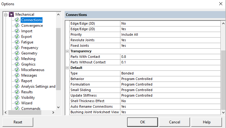

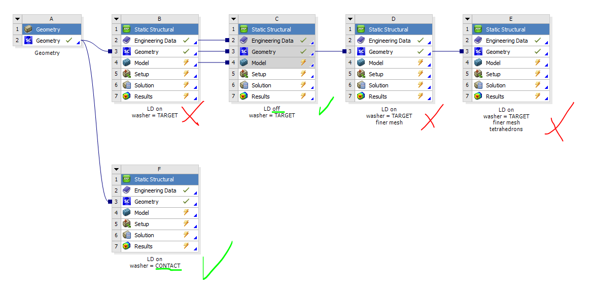

SubscriberJust changing the behaviour from Asymmetric to Program Controlled got the B5 solution to converge with no issues. The program controlled option defaults to Auto Assymetric for flexible body - to - flexible body contact; Do you always set behaviour to Assymetric? I would recommend using Program Controlled for most things. The only time I change this setting is to specify symmetric behaviour for complex non linear contacts such as self contact.
I then changed this in all your models, B->F, and they all converged.
The root cause is that your washer has a small overhang over the plate hole. When this feature is present, the Auto assymetric was flipping which contact/target was active to the opposite of Assymetric, i.e. when this overhang exists, it matters which side is active in the analysis. This is why when you specify Washer=contact in the F system, the solve is successful (Assymetric always leaves the contact active, and the target inactive). I tested this by just moving the radius to be coincident, when this is the case, either side can be active in the analysis (this is what I had in my test model).
In short, MPC contact does a weird thing when a larger donut is set as the active contact, to a smaller donut as target. Why? no idea.
Also your model has multiple splines in it, which should be planar faces.
There is an option for the default behaviour in file->options

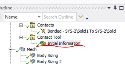

What you did, is exactly the same: When looking at the Contact Tool - Initial Information (with your setting) the Washer will automatically be assigned as contact. I am aware of this.
This was already accomplished in System F before I even started the thread and I even pictured the results in the last 2 images of my yesterday's last post (5th May) (please pay attention to the constraint equations, which spread even further).
I know you already know all that, since you mentioned System F.
But please also pay attention, what I wrote inside the parenthesis: "not applicable, b/c the other side gets distorted in some cases"
By that, I am referring to models with 12 of these Washers on a plate:
If all Washers = Target --> some regions of the plate become distorted
If all Washers = Contact --> some of their elements become distorted
Under these circumstances, flipping contact/target is one of the worst workarounds.

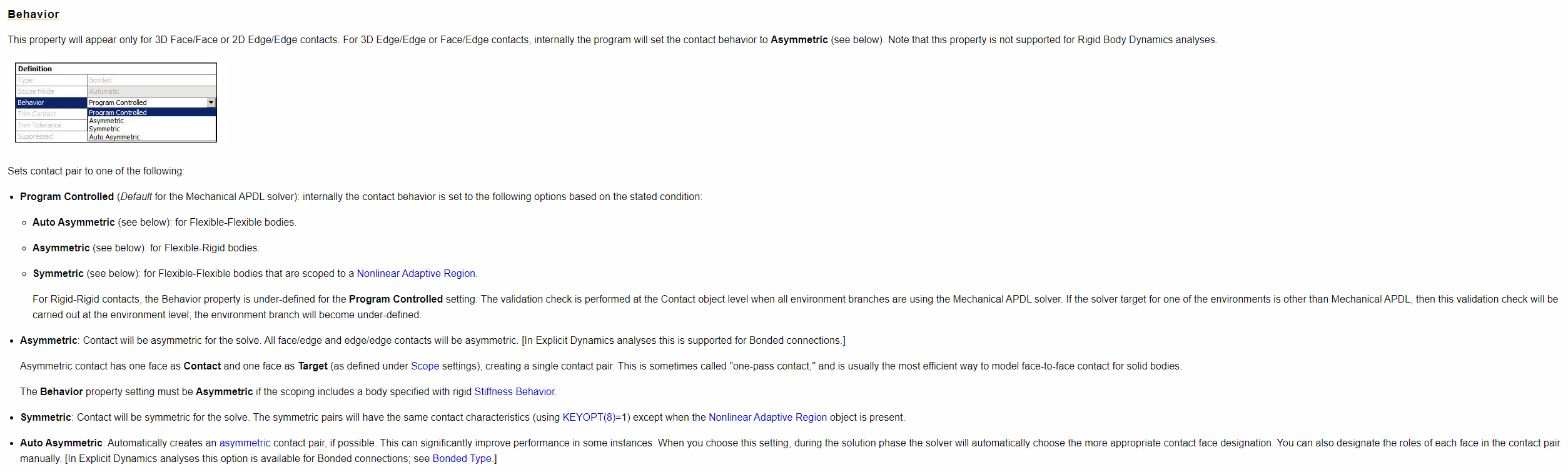

When looking at a single side of a contact pair, that side can be one of the four following options, "contact and active", "contact and inactive", "target and active", "target and inactive". The behaviour setting is not the same as flipping the contact and taget side, it is determining whether it is active or inactive. I am not going to pretend to understand the nuances of these differences, but they are different nonetheless. When behaviour is set to Auto-Assymetric, keyopt 8 on Conta174 is set to 2, when behaviour is set to Assymetric, keyopt 8 is not issued in the ds.dat. Also in the ds.dat, when behaiour is auto-assymetric, there are additional rmod commands which input real constants on the tid (target side) (these are completely missing when behaviour is Assymetric), this appears consistent with keyopt 8 = 2, as this states that both sides of the contact pair will be used to determine the stiffness of the contact.
i.e. when behaviour -> program controlled, it does not matter which side is contact and which side is target, the solver is selecting the best options for you.
You did not answer the question Why are you using behaviour -> assymetric?
As per the Ansys help, this option is inteded for use with rigid body - flexible body contact. The shortest answer I can offer currently is that you are using the wrong setting, and should be using program controlled. This isn't a "Workaround" it is just how the application works; it is the default option and it is the best option for most scenarios.
That being said it doesn't appear you are interested in this. If I am interpretting you correctly, you may be after one or both of the answers to the following.
What is the logic in APDL that causes it to create a seemingly incorrect internal constraint equation such that we get this result?
What is the actual internal constraint equation, that is going into the matrices, which are creating what appears to be singularities?
My stab in the dark is that it is not correctly accounting for the stiffness of both sides of the contact pair (as per keyopt 8). This may be a bug or intentional/predictable behaviour. Unfortunately I cannot answer further than this, and I do not think you will get more of an answer in this forum. The developers are not super active here, of which, you would need to find one that specifically works with contact to get a full answer.
To answer your question as directly as I can.
What is the reason of the element distortionswhen modellingMPC bonded contactswithLarge Deflection: On.
When the contact behaviour is set to Assymetric, the contact pair is implemented without keyopt 2, which results in the contact stiffness being determined/influenced by only the contact side of the contact pair. This can (but not always (seemingly randomly)) lead to incorrect internal constraint equations. This is not an issue with large deflections off, as the stiffness and geometric properties of the model are not updated during the solution. In general, linear solutions can always run when there is a singularity present, where as non linear models will have some trouble converging or fail to converge at all, due to the singularity.
