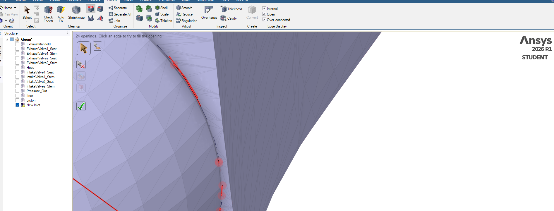

      More practices. Tried to close these identified holes, using the 'Hole' tool but didnt close and if I choose to close all then this closes the holes that need to be kept open.
      Use the Regularize button on the Facets tab to remake the facet surfaces with more regular shaped equilateral triangles on the two faces where holes appear at the intersection. That will make it much more likely that the Holes button will successfully fill the holes.
