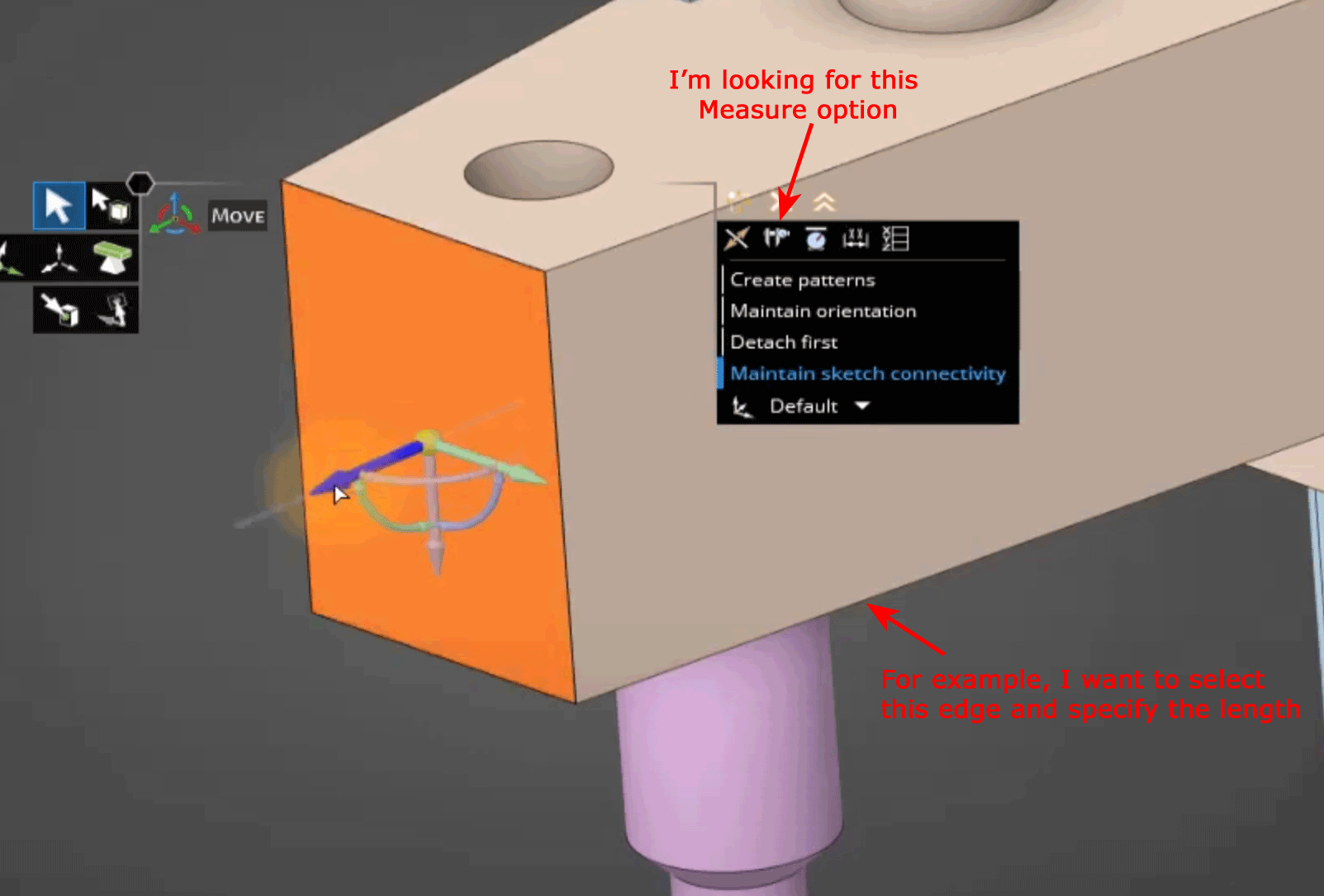

No, that’s not the option I’m looking for. The Measure option has an icon that looks like vernier calipers; it can be used to specify the desired length of an edge when moving a face.
Here is a screen capture from an Ansys tutorial video on using the Move tool in Ansys Discovery:
For some reason, this Measure option does not appear when I’m using the Move tool in Discovery.
Is there any way I can get SpaceClaim back? It was MUCH better than Discovery for my purposes.

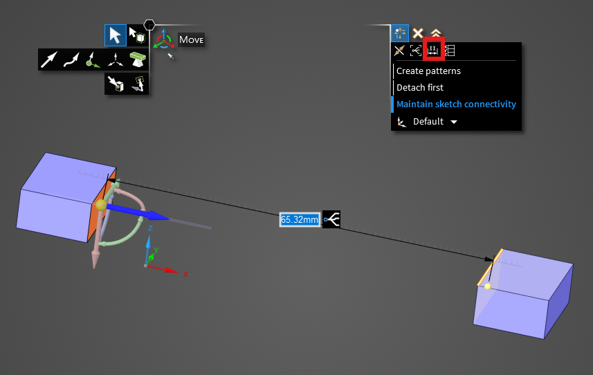

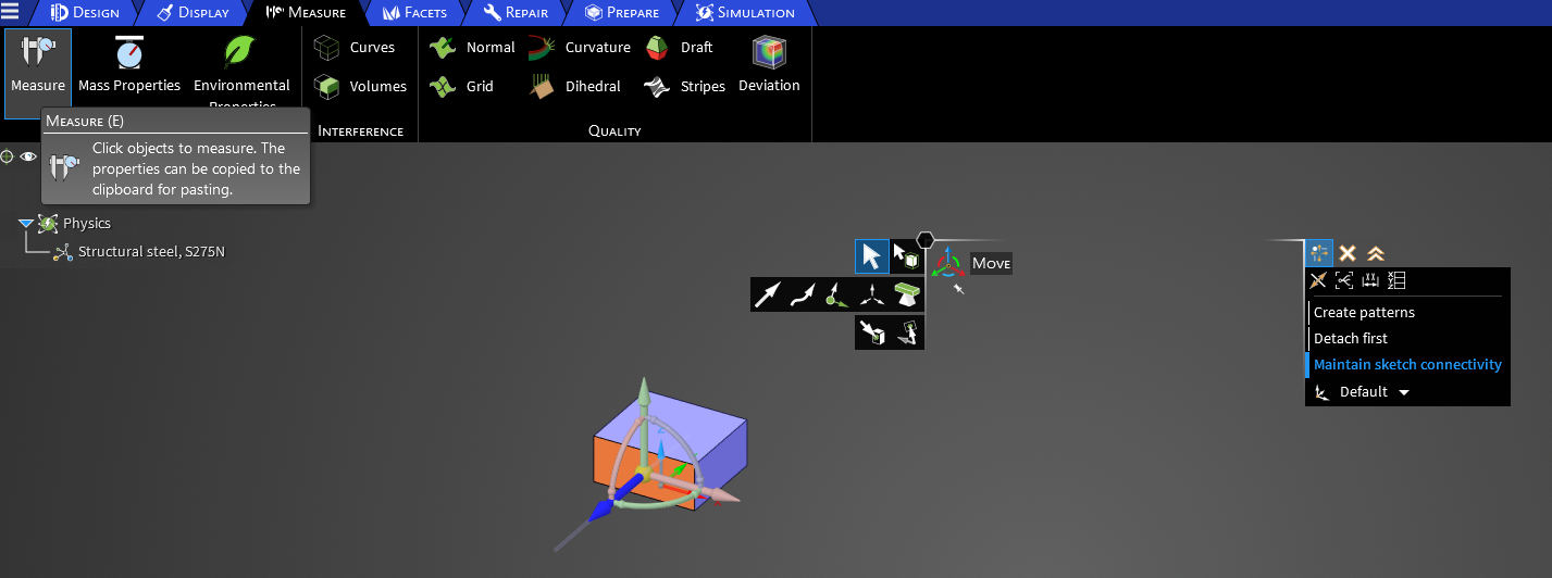

SubscriberWhat I'm looking for is NOT the Measure *tool* (which simply provides measurements). The missing feature was the Measure *option* for the Move tool (and the Pull tool), which allowed you to specify a measurement during the Move (or Pull) operation!
If you click the Measure tool during a Move/Pull operation, the Move/Pull operation is cancelled.
The loss of this important Move/Pull tool option makes no sense! Are there any Ansys employees in this forum to explain?

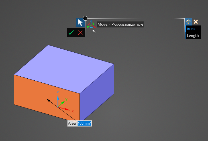

Forum ModeratorHi,Â
This feature was moved to Parameter button:Â
In this case you're measuring the face you're moving X face, and you're measuring Y element.Â
We have added other ways for parametrization which you can refer from here Parameterization — Lesson 4 | ANSYS Innovation Courses
