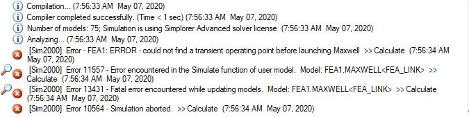

      Did you encounter any problem like this  "[Sim2000] Error - FEA1: ERROR - could not find a transient operating point before launching Maxwell >> Calculate at t=0.0005" when doing your cosimulation?
      I did try changing the time steps.The required time step was very small which took ages to solve. Do you have any idea about this one?

      I got the similar error. I tried different time settings. External Circuit Simulation TimeMotor Simulation Time

    • chandus127
      Try stop time as 0.0015 and time step as 3.75e-05
    • GayaniDeS
      I tried that value. Still the error is same.

    • GayaniDeS
      Hi ,
      I am using SVPWM for the inverter. Inverter is fed with a rectifier circuit connected with a capacitor in parallel.
      It was found when the SVPWM module is connected with the capacitor voltage it gives a error like that (Even though the initial voltage of the capacitor is given). And when SVPWM connected with a separate DC source there is no error.
      There is a possibility that FEA cannot initiate because it doesn't work untill the capacitor is fully charged.
      Hope this might give you an idea.
