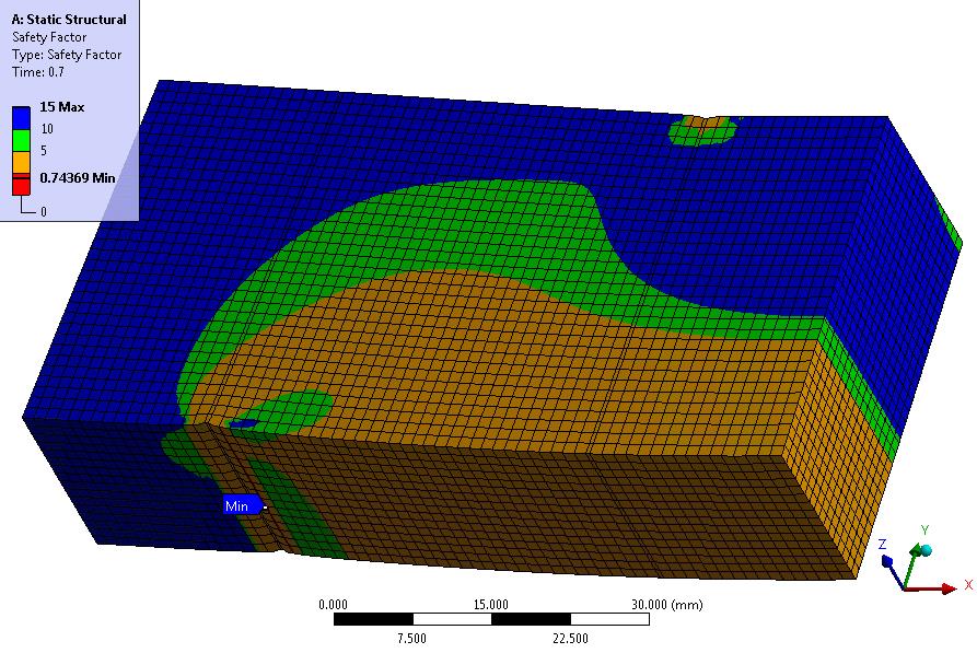

peteroznewman
SubscriberHello Krishna,
There are many students here who have used the Mohr-Coulomb material model. If you edit the Title of this discussion and use "Mohr-Coulomb material model" instead of "Dondapati", some of them may even read this thread!
Did you read the ANSYS documentation for Mohr-Coulomb material model? It's under Mechanical APDL > Material Reference > Geomechanics. There you will find this
The model defines yielding when the combination of pressure and shear stress reaches the cohesion of the material particles. Yielding occurs when the shear stress on any plane in the material reaches this criterion:Â
The value of c in your material is 19 MPa.Â
Did you read about the Mohr-Coulomb Stress Safety Tool in the documentation? It's under Mechanical Applications > Mechanical User's Guide > Using Results > Structural Results > Stress Tools.
Read the full page, not just this excerpt.
I recommend a few changes to your model.
Use Symmetry.
You have two planes of symmetry, half way along the length, and half way through the front-to-back depth. If you split the model on those two planes, you cut the volume to 1/4 and can therefore use smaller elements to get a more refined mesh that is still within the Student license limits. Another advantage is those planes take up 5 degrees of freedom on the body, so a displacement on the y coordinate is all that is needed to have a static model.
Replace Contact with Split Faces
Use a thin face to apply a displacement of Y=0 on the bottom and another thin face to apply a Y = -0.1 displacement on the top. It takes less time to solve if you have displacements than if you have contact.
Here is the result of the Stress Tool:
This shows the material has exceeded the failure threshold above about 40% of the applied displacement. However, this shows the failure is at the narrow face. Perhaps a wider face and smaller elements next to the face would be better for showing when the material on the center plane gets to the failure point.

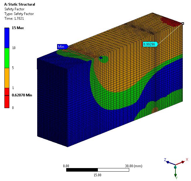

peteroznewman
The file I provided above ran slow on a computer with only 16 GB of RAM. The solver needed more than that to run in memory, therefore it ran for a much longer time using the slow HDD as storage. It did eventually stop solving but managed to converge past the point where failure is predicted.
Here is the Safety Factor Plot with a Probe showing SF < 1 near the center of the beam on the bottom face. This is a view of the bottom of the beam.
Failure at the support was predicted at much less displacement, but that failure could be delayed by spreading out the contact force over a larger area. The failure at the center of the span cannot be mitigated, so is mostly independent of the testing setup.
The model ran for 103 iterations before stopping due to a failure to converge.
Your model had an applied displacement of -0.1 mm on the center pair of faces. Where did that number come from?
My model was able to solve until -0.0454 mm then could not converge, but the model predicts failure at the center at this displacement if you ignore the failure at the support face. The force reaction for this displacement was 977 N for the quarter model or 3908 N for the full model. Do you have experimental data to compare this with?

peteroznewman
SubscriberHi Krishna,
Sorry for the late reply also.
This post has some relevant insights on Step Control.
When the solver fails to converge and stops, the Deformation plots often show the Unconverged solution, which is not what I want to see, I want to see the last converged solution. To see that, go to the Tabular data table for that result and scroll the the end. In a 2 step solution, you will see the time is 2 on the last row but 1.235 on the second last row for example. Right click on that second last row and select Retrieve this result. Now you are looking at the last converged result. You can probe the displacement anywhere on that model.
You can do the same for strain, picking the second last row. Since your strain gauge was aligned along the length of the beam, request Normal Strain and pick the appropriate axis for the strain component. You can then probe to pick off the value at the location where the strain gauge was mounted to compare with the experimental result. You can select a node nearest the strain gauge and plot the time history of strain.
