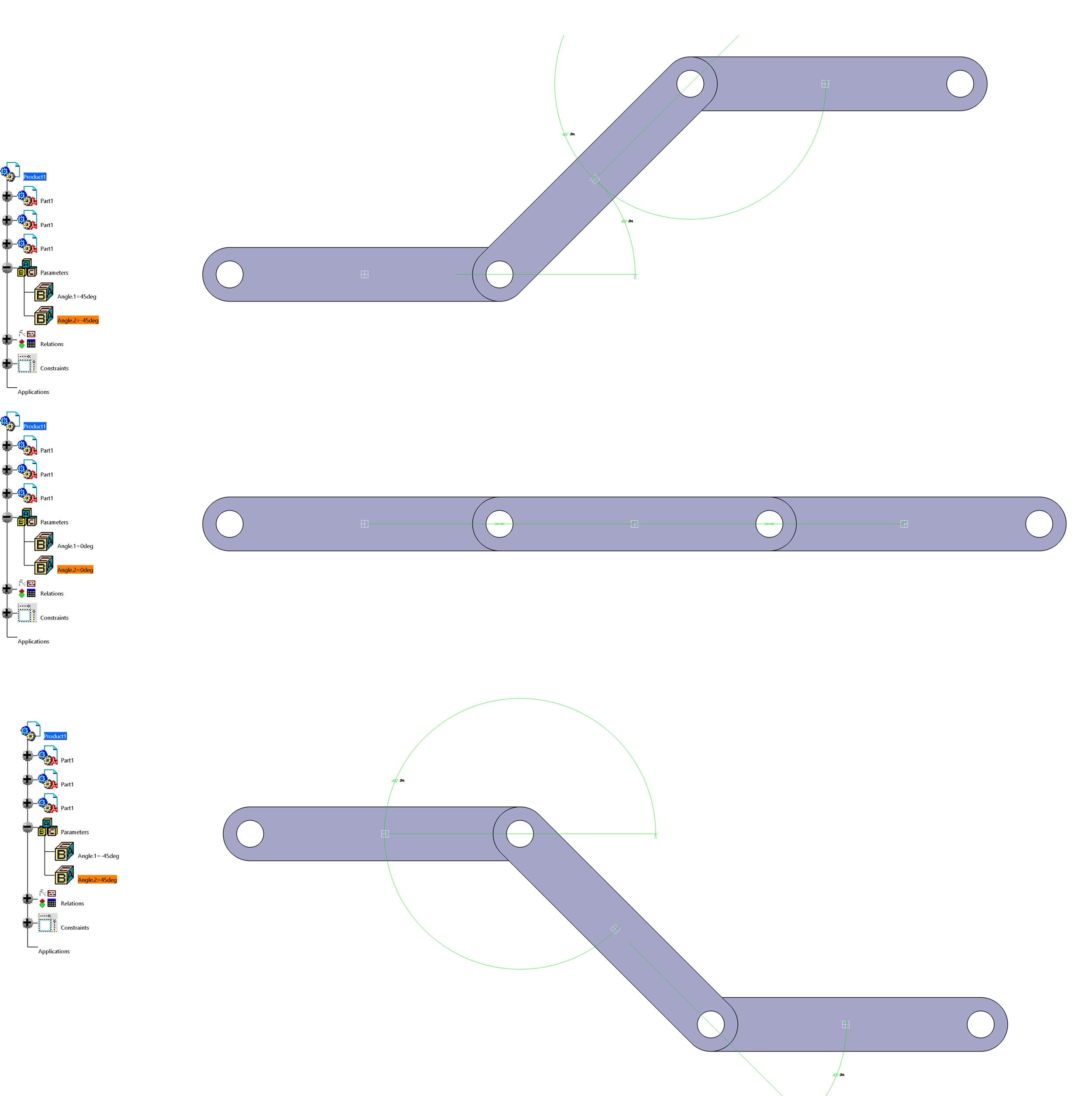

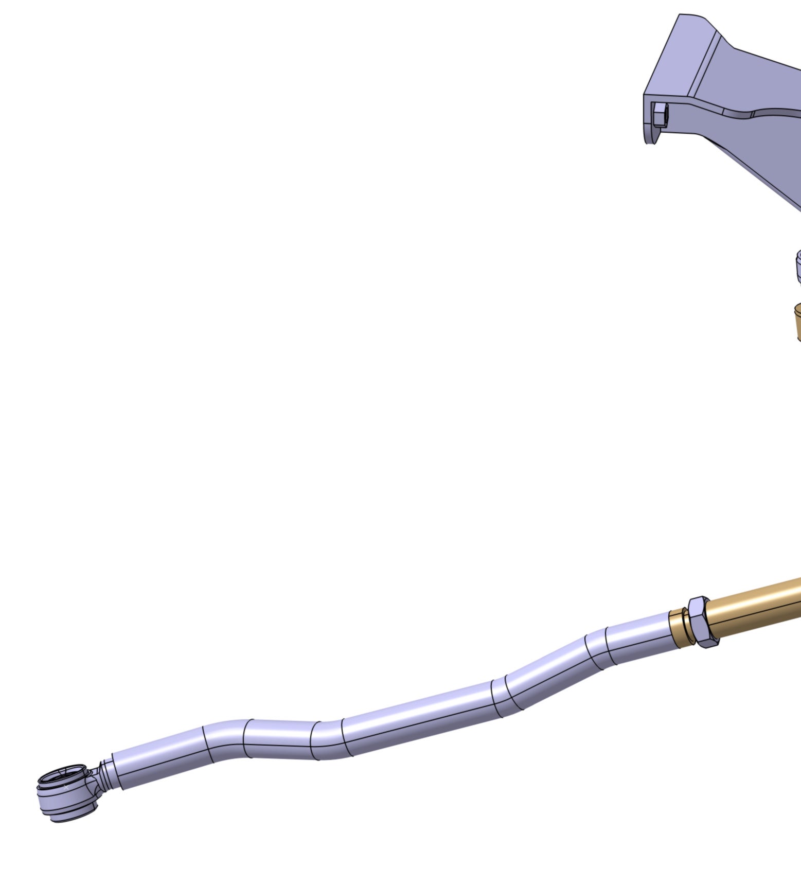

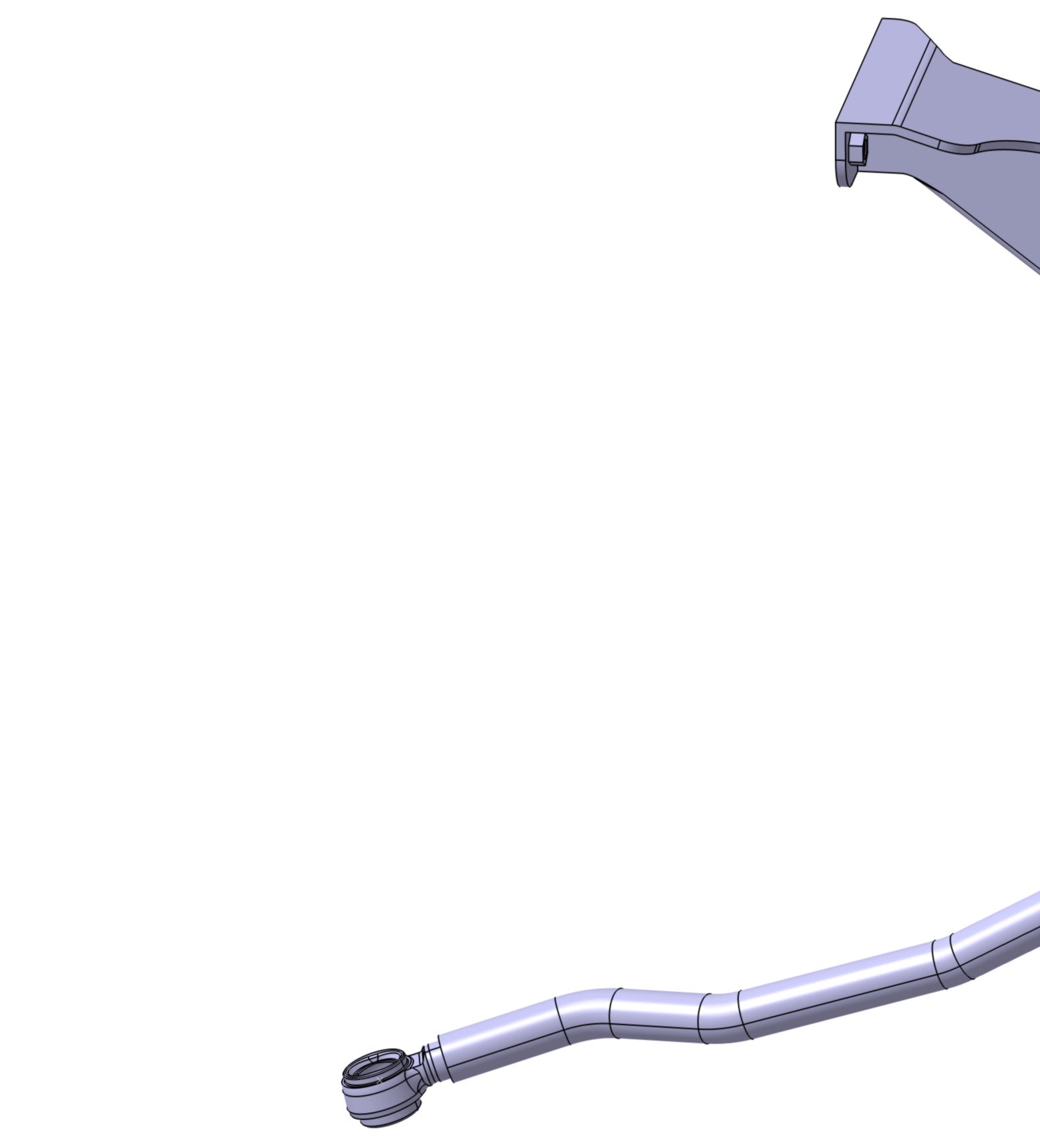

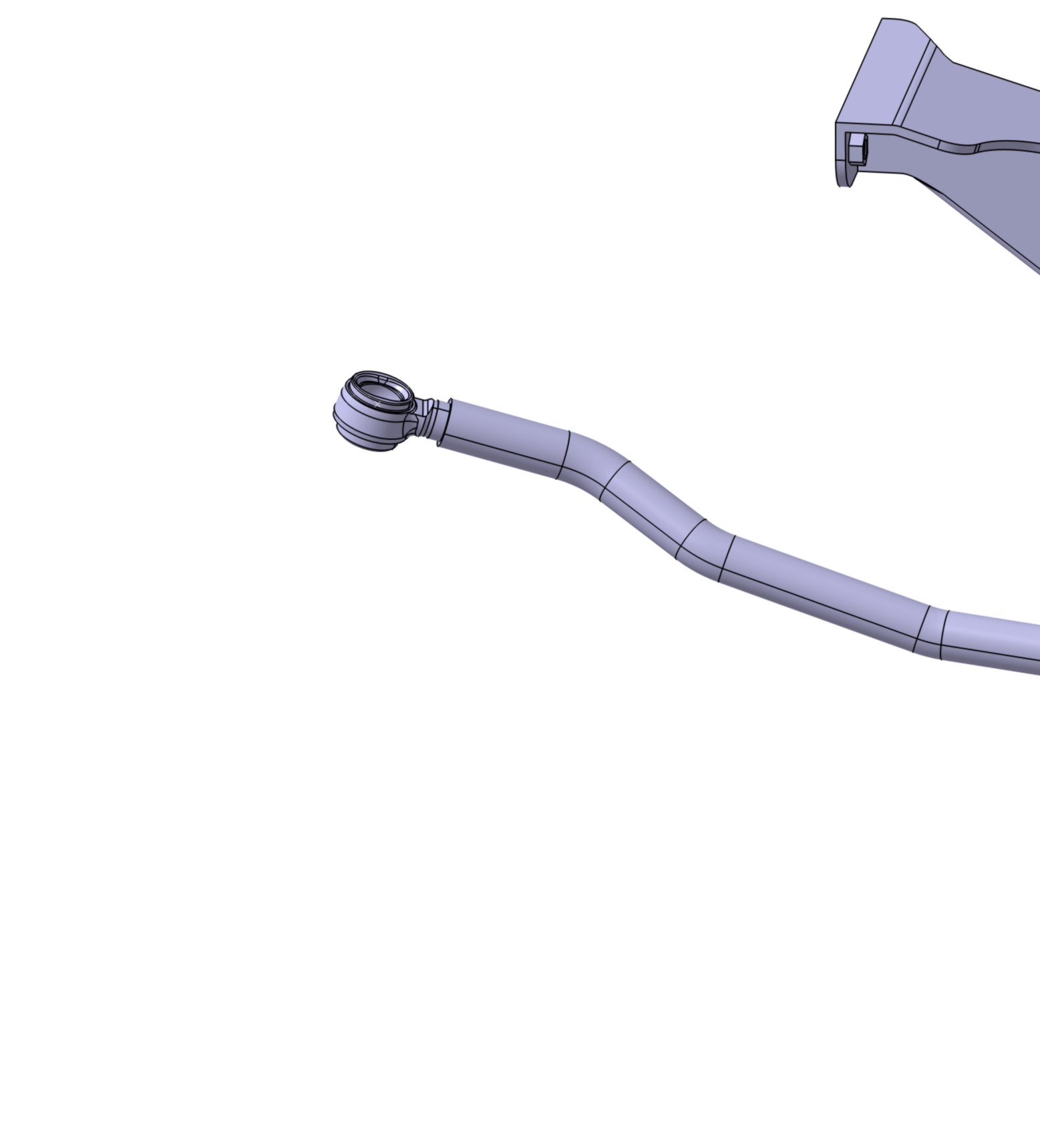

      I have been working at this for hours with no luck.  I have a large assembly controled by parameters in Catia.  I need to be able to update the model and run different cases in Ansys but I don't want to have to redo the model 9 times for each case.  That will be WAY too time intensive.  For the life of me, I can't get any sort of parameter linking or bidirectional design to work between Catia and Ansys.  These are my geometry settings:
      I would gladly ready the help/instructions/tech info but I can't find anything.  I don't even know what to search for as everything I have tried yeilds no results.  Can someone help me please?
      Mike,
      I haven't used the Catia-Ansys CAD interface, but I have used the NX-Ansys interface in the past. Now when I want to have any kind of parametric interface between CAD and Ansys Workbench, I use either DesignModeler or SpaceClaim because only those CAD programs (and Discovery now I suppose) support Multibody Parts in Ansys Workbench.  Multibody parts are useful for meshing or changing materials without needing any bonded contact. But maybe you don't need Multibody parts support.
      It looks like you have two revolute joint angles and you want to assemble the parts at three levels: -45, 0 and 45 degrees, for a total of 9 configurations. If you use Revolute joints, note that there is an Initial Position field that can be set to Override.  That means you can bring in a single configuration: the (0,0) angle from Catia, and build the model in Mechanical. Then you can copy the model 8 times and Override the revolute Inital Position angles in each of the copies to set the other 8 configurations.

      The image I showed was just to attract attention and as a general idea.  I have a large, complex model that is driven with a skeleton, parameters and laws in Catia.  Modifying it in design modeler or spaceclaim wouldn’t be so easy.  I suppose I could import a whole ton of points and then try to reassemble each component but that sounds like way too much work.
      I’ve done a whole bunch of reading and it sounds like the bi-directional connection between Catia and Ansys is basically impossible so I’m giving up on that avenue.
      At this point I’m guessing the easiest thing to do would be to make changes to my model, import each change and then somehow link the cases in Ansys Workbench.  Is that correct?  Do I have to turn off the model updates for each static structural instance in the workbench?  I’d be happy to do the reading about this but I don’t know where to start.
      As for modeling multi-body parts, I wasn't having much luck getting things to transfer properly to mechanical.  I think it may be easier to bring the bodies in from a catia assembly and just use connections in mechanical.... unless you can tell me a reason why that isn't the best way to do things....

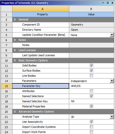

      Mike,

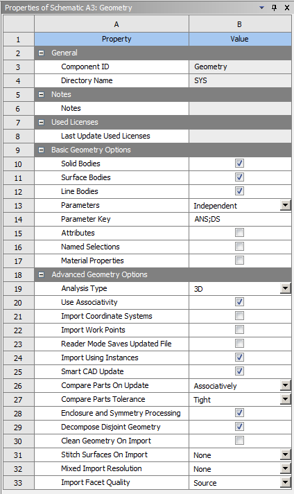

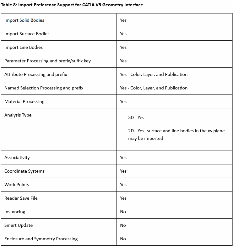

      Note that there are two Catia-Ansys CAD interfaces: “Reader Only” and “Associative Geometry Interface”.
      I assume you were using the latter. The former is not associative, it is a one-way reader.
      Did you read the Ansys Help entry?
      The CATIA V5 associative geometry interface requires that the following software be installed and running:
      • Compatible version of CATIA V5 CAD program (V5–6R2020, V5–6R2021, V5-6R2022).
      • DSLS configured with a CATIA V5 (MD2, HD2, or ME2) license.
      • CADNexus CAPRI CAE Gateway V3.90.0
      Do you have all that installed?  The associative interface defininitely support parameters.
      Ansys-Catia support Versions: V5R2 — V5–6R2022 of Catia.  Are you in that range?
      In order for Workbench to send parameters to Catia and get back the modified solid, surface and line bodies, you must have used the Prefix DS or ANS in Catia to name the parameters as shown in the Workbench Geometry Properties.
      Have you named the Parameters with a DS Prefix?
      Hidden parts will not be imported.
      Using Parameters with CATIA V5 (CADNexus CAPRI CAE Gateway )  —
      • Parameter names contain the entire CATIA Assembly Name and Part Name.
      • Parameters are shown at the assembly level, under the Details of Geometry branch in the Ansys Mechanical application.
      • Embedded spaces should not be used in the Assembly Name or the Part Name to ensure compatibility with the DesignModeler Parameter Manager.
      Have you removed any spaces in the Parameter names?
      Finally, if you were expecting Joints defined in Catia to be imported, that is not supported. You only get the geometry. Once the geometry comes over, you define joints and contacts in Ansys Mechanical.
      Say there is a parameter such as DS_linklen1 in Catia that is set to a value of 24 and controls the length of link 1 in Catia.  That parameter will be available in Ansys Workbench.  If you look in the Table of Design Points, you will see a row with a 24 in it under the DS_linklen1 Input Parameter. If you create a new row in the Table of Design Points and type a 36 in that column and click the Update All Design Points, Workbench will automatically start Catia in batch mode, rebuild the assembly using 36  for DS_linklen1 and pull that geometry into Workbench, then Mechanical will attach the native Ansys Joints to the face that is now on the longer link and run the Analysis and populate any results marked as output parameters to the Table of Design Points in Workbench.
      If none of the Catia parameters change the shape of any geometry, but only relocate/reorient parts, then there is less value in the associative interface.
      Good luck!

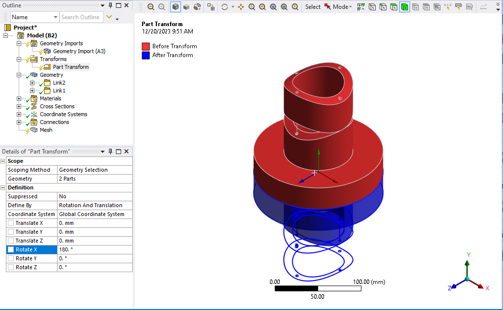

      Since you don’t need to change the part goemetry, only reorient/relocate parts, I refer you back to my original suggestion of using the Joint Override feature and copying the analysis to create the 9 configurations.
      If it can’t all be done with Joints, Workbench has a Part Transform capability when merging Mechanical Models into an assembly Mechanical Model. See my reply in this discussion.

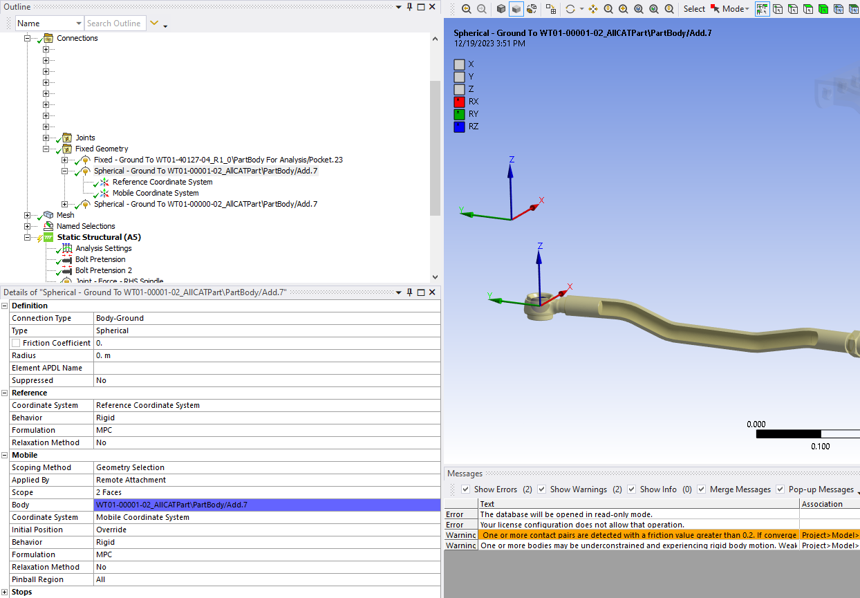

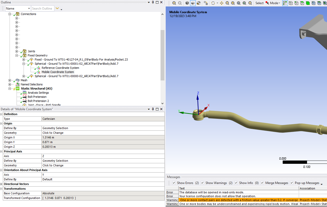

      OK, I see what you’re getting at and this is a good idea.  The only problem with it is that I have 2 tierods that are free in space.  The inner ends of these tierods are connected to the steering system but the outboard ends are fixed in space using frictionless support on a sperical surface of a balljoint.

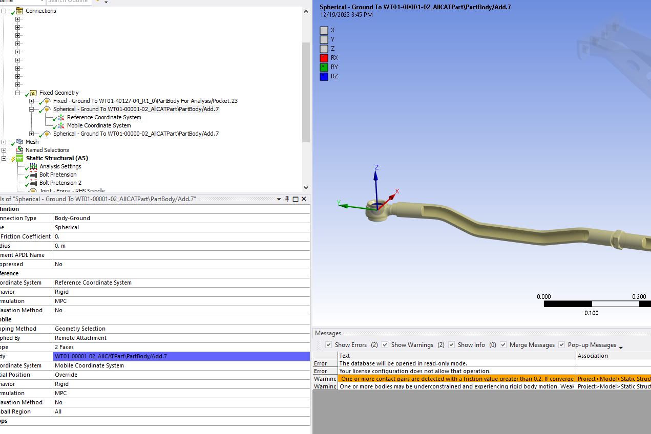

      Is there any way to define the position of the free ends using coordinates?  Can I join to centre of the balls to fixed points or something like that?  I don’t have any of the suspension geometry in the model to control the position of the ends of these tierods so I would need to do it with coordinates.
    • wallybanger
      I’ve tried doing a position override with a spherical body-ground joint and it doesn’t seem to be doing much
      I don't know if there's a way to make the geometry go to the coordinate system or if it's conflicting with other joints or what's going on.
    • wallybanger
      I'm getting the impression that I can only do what I want to do if I have solid geometry for every single part in the assembly, which is disappointing.
      You don't need every single part in the assembly. The simplified example you started with is the case where you know the transform for each body (translations and rotations).  Did you try inserting a Part Transform object into your Model?
    • wallybanger
      No!!  I didn't know part transforms were a thing.  That looks like a very helpful feature. It doesn't allow me to do exactly what I want but it might get me close.  I would prefer to locate the ball end using xyz coordinates but I'll play with this and see what I can do.

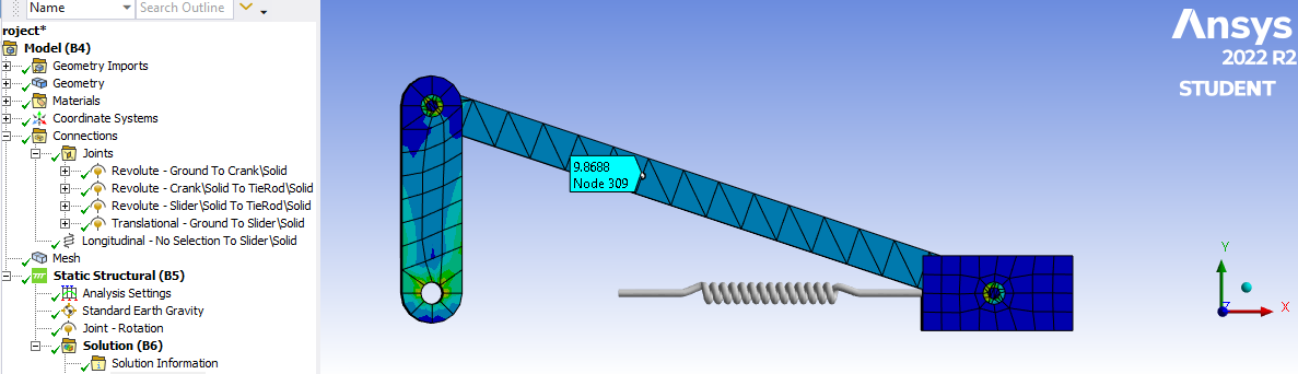

      Mike, I’m sorry your search for a workflow to build the model you want is so frustrating. The simple example at the start of the discussion did not capture a feature I overlooked because it is a chain where the third body’s position in space is determined by just two revolute angles.

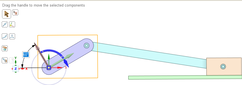

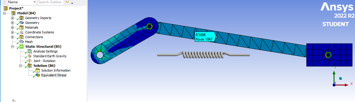

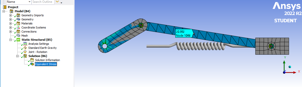

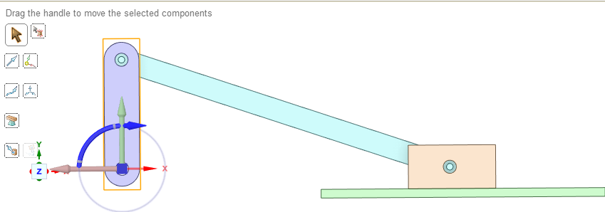

      I created a slider-crank mechanism, where the position of the connecting rod is not so easily defined.  In this example, assembly constraints in SpaceClaim keep the parts correctly assembled as the crank rotates using the Move tool.
      I have not figured out how to rotate the crank using a parameter because SC does not pop up a Parameter button the way it does when body faces are moved.
      In Static Structural, I created joints to connect the bodies so loads can be transferred through the parts. I added a spring to add some load to the mechanism.  The spring is preloaded by defining the Free Length of the spring. The force in the spring is calculated as the spring length minus the free length multiplied by the spring rate. In that way, when the crank rotates to a new angle, there will be more or less force as the spring length changes.
      In the first attempt at building this model, the joints and spring were created using the simplest method of picking Geometry and I solved the model with the crank vertical. Then I opened SC and used the Move tool to rotate the crank by 60 degrees. Assembly constraints kept all the links properly connected in SC then I closed SC and clicked Refresh on the Model cell in WB. I was happy to find that this version of Mechanical correctly updated the joint coordinates to their new locations in space. Years ago, they were stuck at their old global coordinates. Glad to see Ansys made some progress here.  I edited my comments in an earlier reply to reflect the 2022 R2 release.
      Only the spring connection failed to update to the new coordinates. Notice that the Spring Length did not update so there is no additional force at this configuration and there is a gap between the end of the spring and the face. Ansys has some more work to do for a future release.

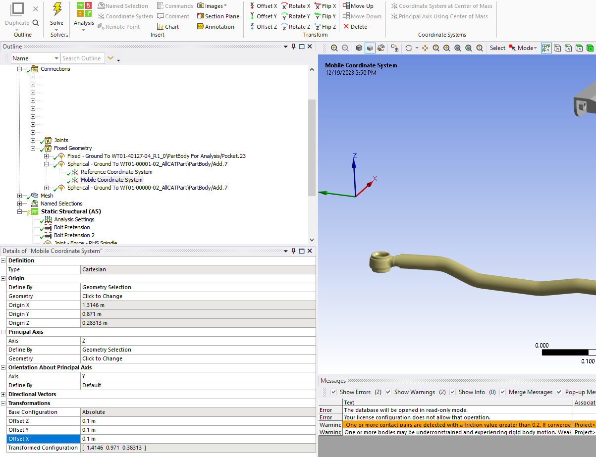

      To work around this failure, I created a Local Coordinate System on that face, which will stay attached when the face moves then the Mobile end of the spring was reconfigured to use that Local Coordinate System instead of the Global Coordinate System. Notice that when the geometry updates to the 60 degree crank angle, the Spring Length correctly updates to a longer length with the same free length, so the spring force will be higher in this configuration.
      You didn’t say what version of Ansys you are using. I created this example using Ansys 2022 R2 so you can open the archive at this link using that or a later version.

      OK, so we’re back to doing things in Space Claim.  It’s very frusterating because both Mechanical and Space Claim have great tools but individually they are missing functionality.  I have a big assembly but I don’t need to move all of the parts, just a few…. but there are no assemble to ground functions in Space Claim (as far as I can tell) so you have to fix a whole bunch of components to build the mechanism.  Also, as far as I can tell, the constraints don’t allow you to select more than one surface for things like ball joints so I may not be able to make some of the constraints work.  I guess you need to bring in a skeleton part to assemble things to.
      In Mechanical, all of these problems would be solved by being able to define a zero point and then set the joint position.  Linear movement with prismatic joints and angular movement with rotational joints.  When you “configure” your joints it even pops up with the realative position so the software knows where things are, it just won’t let you define them.

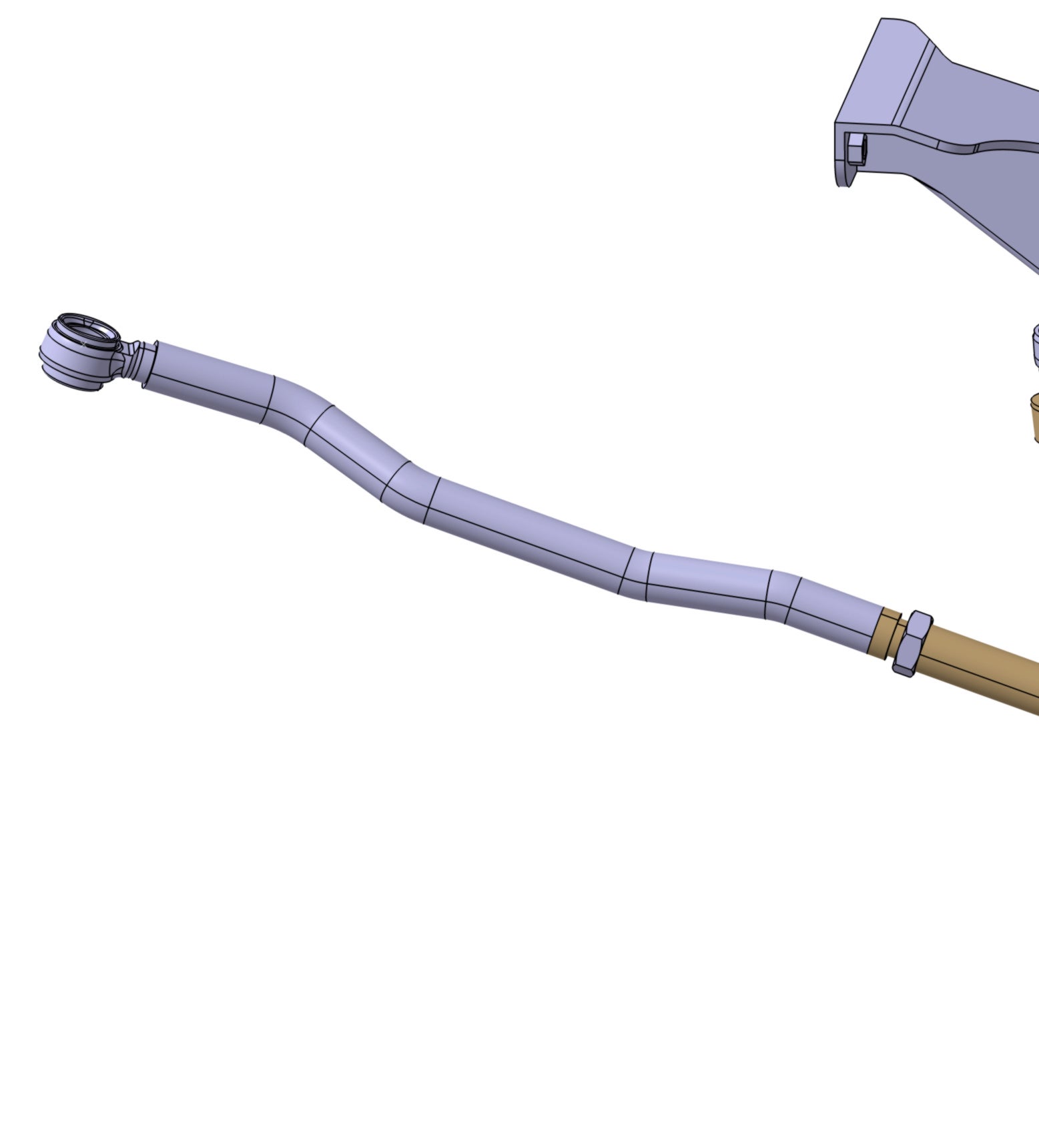

      Yes, for a test case what I’m working on is a double wishbone suspension.  In our case I’ve redesigned the steering system in a novel manner which allows for 18″ of wheel travel with zero bump steer.  That may not sound ideal but for our application it’s essential.  I’m not overly concerned with testing the steering knuckle or a-arms at this point but I am testing the force inputs to the steering system in different positions… so suspension up, down, neutral and then wheels turned right, left, straight.  Those photos above are the end of the tierod where they would connect to the steering arm on the knuckle.
      At this point I have had some limited success by setting stops in the joints, “configuring” the joints by moving them to the extremes and hitting the “set” button.  Then suppressing and unsuppressing different joints and “fix”s before running the solver.  This works to an extent but does not give me fine control.  It does, however, work for both the suspension and steering conditions.  It is slightly more complicated because I have a component in the system where I am applying a bearing preload to a spindle using all “connections” so I need to enable revolute joints to move the steering system and then disable those joints before solving.
      It appears to be working but it’s cumbersome and not as precise as I would like.
