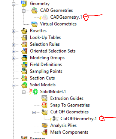

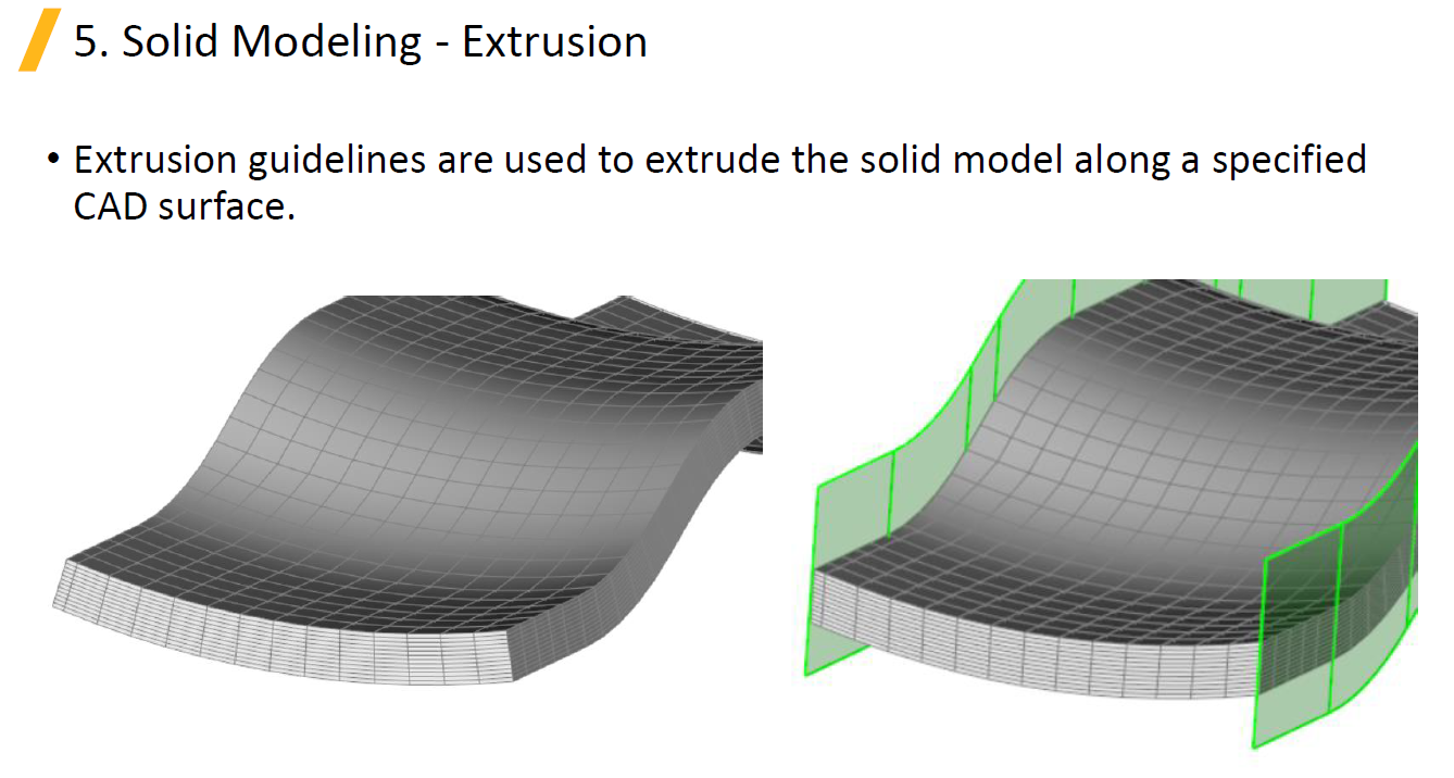

      You may be able to create the V cut-outs using extrusion guides when doing the solid extrusion:
      You can also import geometries to use as cut-outs:
      You will find more information in the ACP help:
      https://ansyshelp.ansys.com/account/secured?returnurl=/Views/Secured/corp/v231/en/acp_ug/acp_solid-model.html

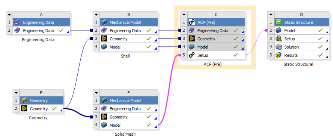

    • Reno Genest
      Hello Sankar,
      An alternative is to build the composite layup on a surface like you have been doing, but instead of extruding the solid model, you can import a solid mesh of the finished part (with cut-outs and everything) and then map the composite layup on the solid mesh. You will find more information about this technique along with an example model in the help:
      https://ansyshelp.ansys.com/account/secured?returnurl=/Views/Secured/corp/v231/en/acp_ug/acp_ex_mapped_composite_solid.html
      Let me know how it goes.
      Reno.
    • Reno Genest
      Hello Sankar,
      The WB workflow to map the composite layup directly on an existing solid mesh can look as follows:
      Reno.

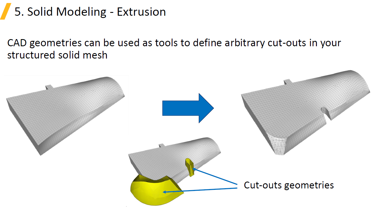

    • Reno Genest
      Hello Sankar,
      Sounds good. You can import CAD to use in the solid extrusion as guides or cut-offs as follows:
      Reno.
