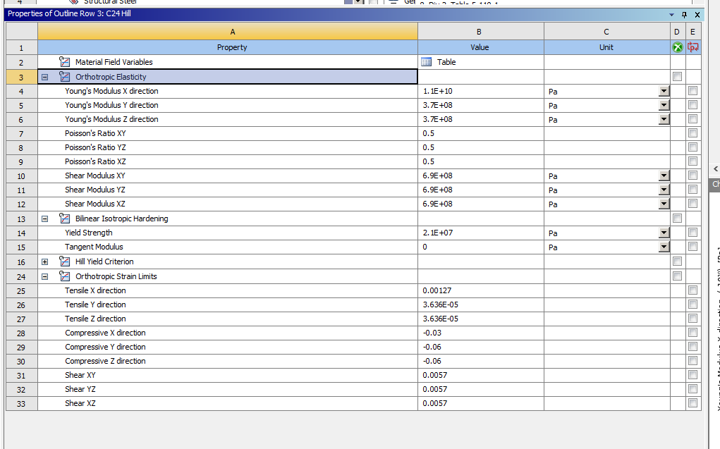

      I'm trying to do an analysis of timber in workbench.
      I would like use a material model as shown below. However this is not possible to do in a Static Structural model as it does not account for the strain limits.
      When I try to run it in Explicit Dynamics instead I get a problem because Hill yield criterion is not supported.
      Do I have any other options?

      Hill yield criteria is for mapdl, and can not thus be used with Explicit dynamics that uses the autodyn Explicit solver (autodyn does not have a Hill Yield Criterion).
      As mentioned in previous post, I would recommend the mat_143 (*MAT_WOOD) model in ls dyna for modelling timber/wood. See the LS-DYNA_Keywords_Manual_Volume_volume_II, for more info on that. This model includes the softening you tried to illustrate in your last image (first original post), and is introduced via the material damage model that is included in this material model.

      As wood is an orthotropic material, which direction have you considered for defining the yield strength for the bilinear isotropic hardening model? And the reason?
    • MFN
      The orthotropic strengths are very important in my model. Therefore I have used a static structural model where it is possible to define Hill yield criterion. This allows me to specify orthogonal strength parameters. However it is not possible to specify different strengths for compression and tension.
      My main reason for trying an explicit model was to include strain limits. I have chosen to omit this from my model as it was more important to include the Hill criterion.

      As yield strength can be defined for each principal directions, I'm interested in knowing which yield strength (2.1*e7 Pa) have entered while defining bilinear isotropic hardening and the reason why you have choose that value?
      Regards
    • MFN
      2.1e7 Pa corresponds to the compressive strength in the axial direction (parallel to grain) of my material.
      In Hill criterion I have set the yield stress ratio in x-direction to 1. I have then inserted local coordinate systems in my model to align the x-direction with my grain direction.
