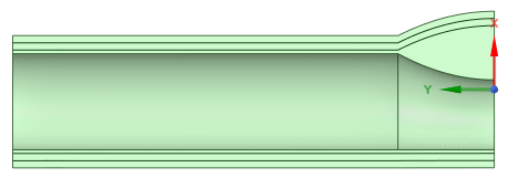

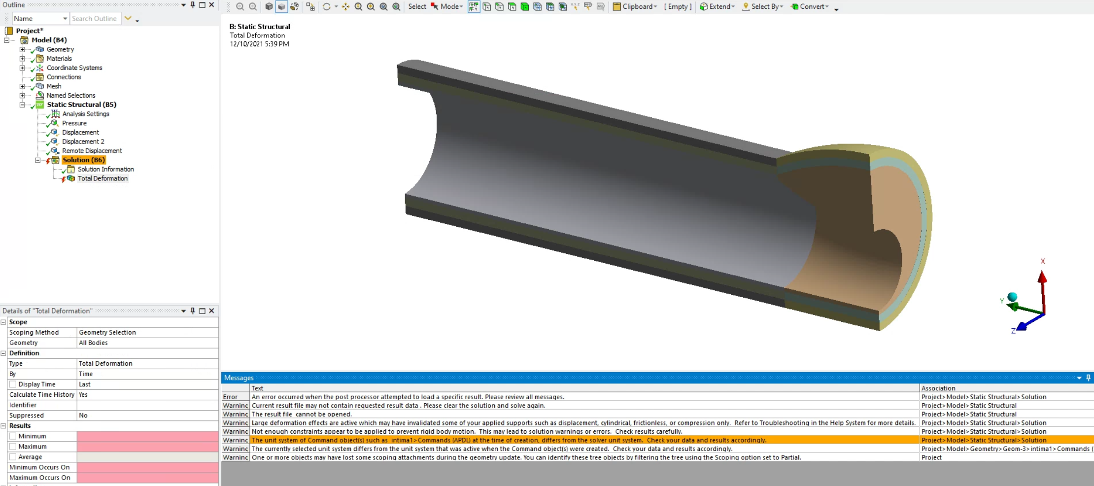

      I have an issue with the FEA modelling of an artery with three layers. I tried to make it as simplified as possible. However, I got a couple of errors.
      This is the list of errors that I got:
      • An error occurred when the post processor attempted to load a specific result. Please review all messages.
      • Current result file may not contain requested result data . Please clear the solution and solve again.
      • The result file cannot be opened.
      • Not enough constraints appear to be applied to prevent rigid body motion. This may lead to solution warnings or errors. Check results carefully.

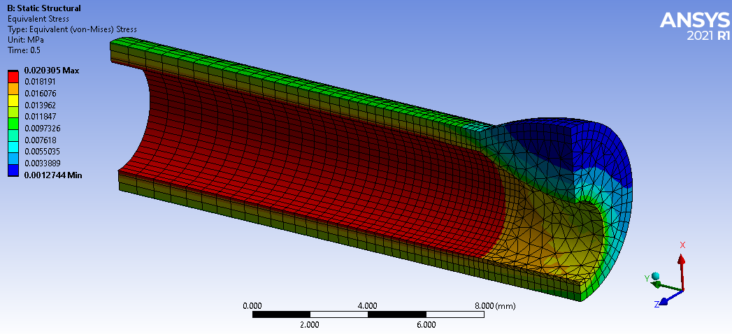

      Artery tissue is generally modelled using a Hyperelastic material model. Using Linear Elasticity is not going to represent reality very well.
      Materials with a high Poisson's Ratio often benefit by using a mixed u-P element formulation, which is enabled by setting Keyopt(6) = 1.
      To get the model solving faster, you could use two planes of symmetry and cut the geometry down to 1/4 of the size.
      You have a pressure ramp up and then down over 1 second, but since the material is linear, there is no new information on the ramp down, so I only simulated 0.5 seconds.
      This mesh has less than 25k nodes, your model had 871k nodes, which means you spend a lot of time waiting for the solver to finish.

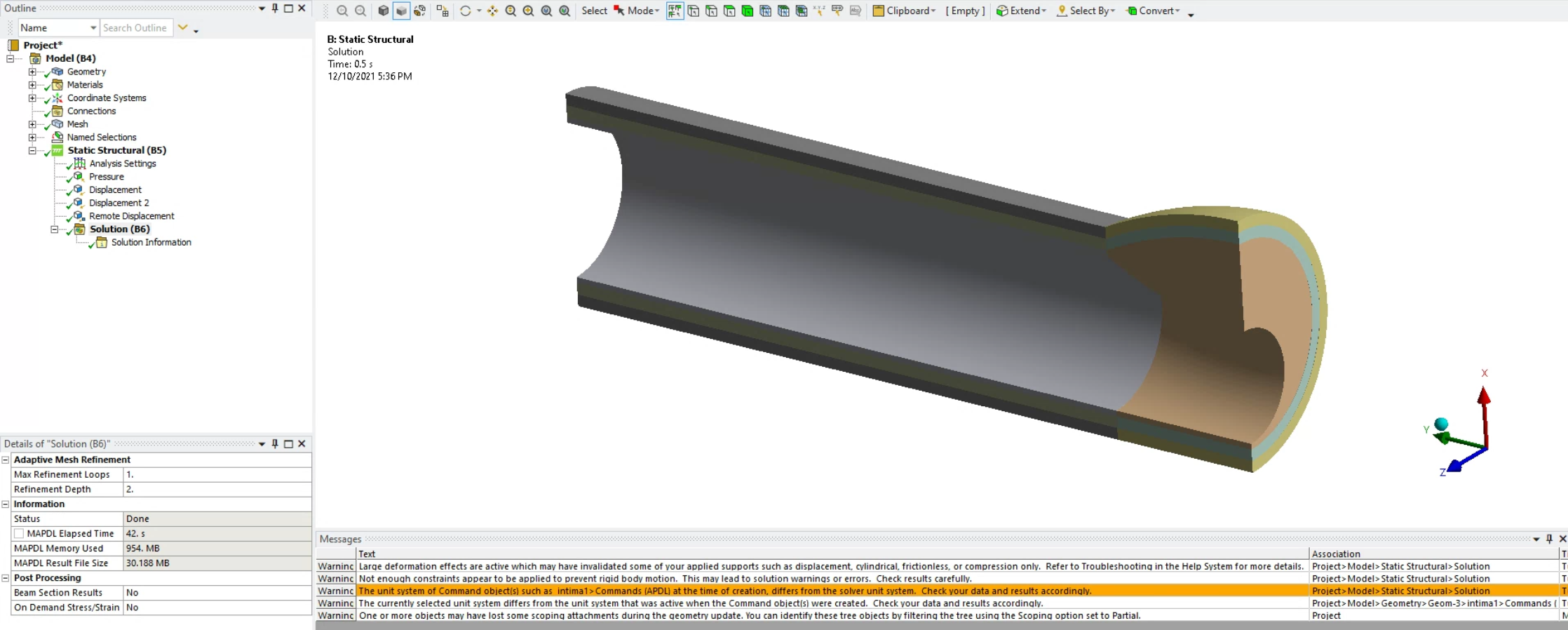

      Thanks for your reply. Here are some snapshots of the model:
      Thanks for the help.
      Cheers
      Navid
    • ErKo
      Hi
      See that error - something with the post processor - so it has solved.
      First of all save the archive wbpz as a wbpj somewhere on your C drive. Then:
      delete all of the result objects, resolve and add new results when it has solved.
      Thank you
      Erik

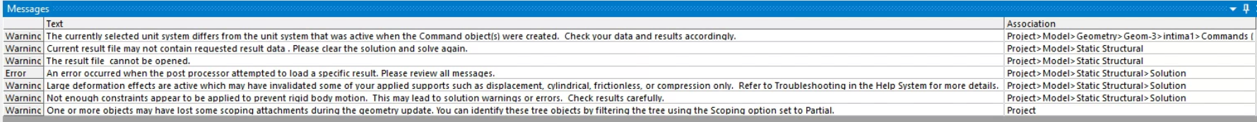

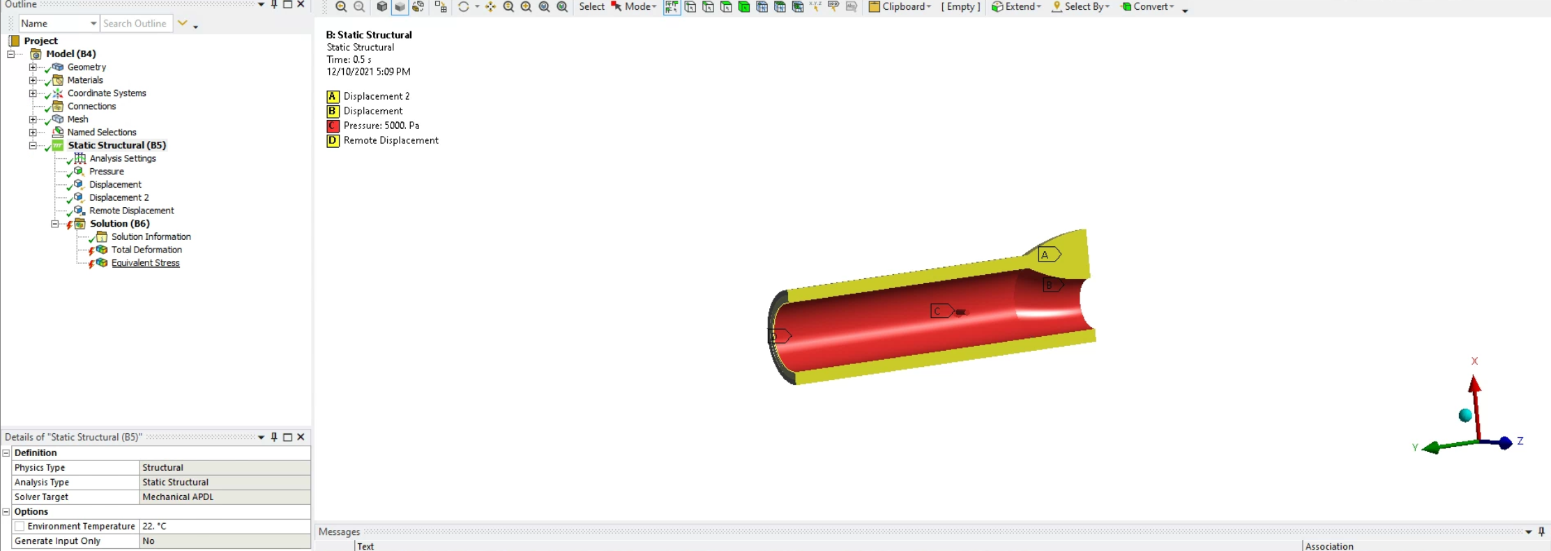

    • navidvd
      I've done what you suggested.
      Here is the model without asking for any results to calculate:
      Which looks fine. However, once I add a result and press Evaluate, the same thing as previous happened:
      Thanks again for possible suggestions
    • ErKo
      Hi
      Firstly did you save the wbpz archive locally as a wbpj project?
      If that is the case and the same error occurs the:
      The error is that it can not open the results file. We do not know exactly why so I would just start from scratch and follow that model (same geometry (import it from), same loads, boundary conditions, I would initially skip the commands since it will probably solve without them,...).
      Hope this helps
      Erik
    • navidvd
      Thanks, Erik for your help. I installed Ansys 2021R2 and rerun the archive file, and it worked well.
