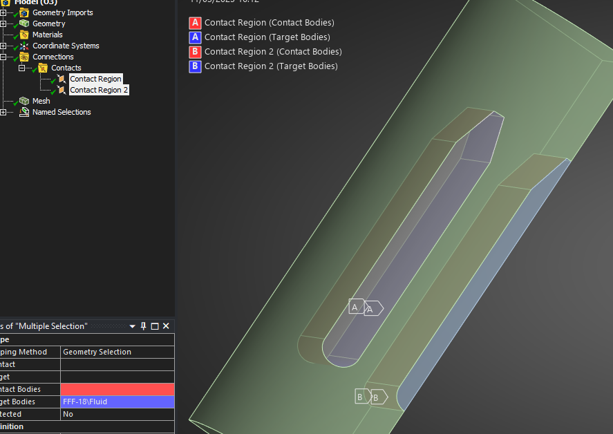

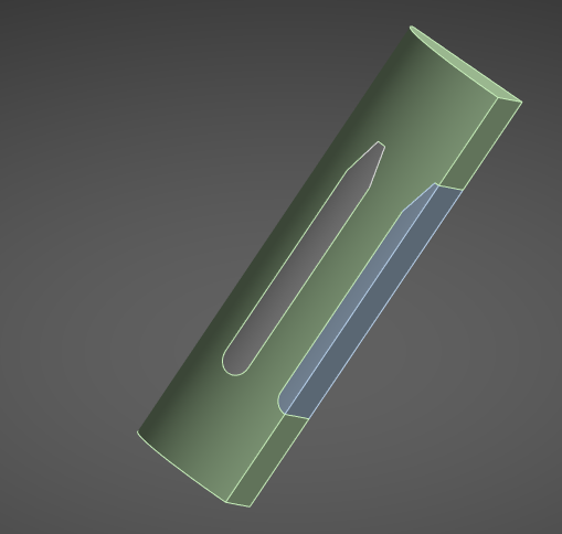

SubscriberI have the geometry below, the larger body is the fluid volume and the other bodies are the baffles. Being seperate bodies, they all have their own walls but take the contact region between the baffles and the fluid, there are two walls which are the exact same, one being part of the fluid volume, the other being part of the baffle volume. What I am assuming is I would make these walls velocity inlets with velocities of 0m/s to then make them impedance boundary conditions to model the perforated panel, what is the best way to set this up? I assume the boundaries will be related to these contact regions but what would be the simplest method to set this up? Also this is a follow up to my previous question about the source?

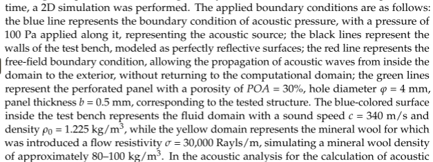

SubscriberI am also wondering how the mineral wool properties described in the first screenshot (density and flow resistivity) I showed translate to viscous resistance and inertial resistance in Fluent?
