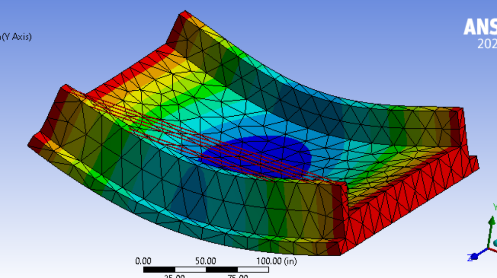

I am trying to model a bridge in Workbench static structural mode. The bridge is made of Reinforced concrete. I believe I assigned the appropriate materials and commands to connect the steel and concrete together. However when I run my analysis the rebar seems to only be connected at the 2 end nodes as shown in the picture below.
I would greatly appreciate the help!

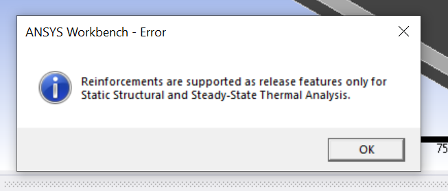

Using the reinforcement option works great however I want to apply a modal analysis on my bridge which doesn't work with reinforcement.

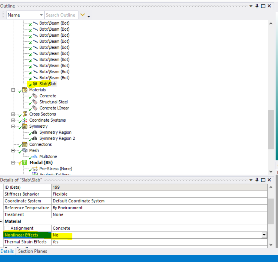

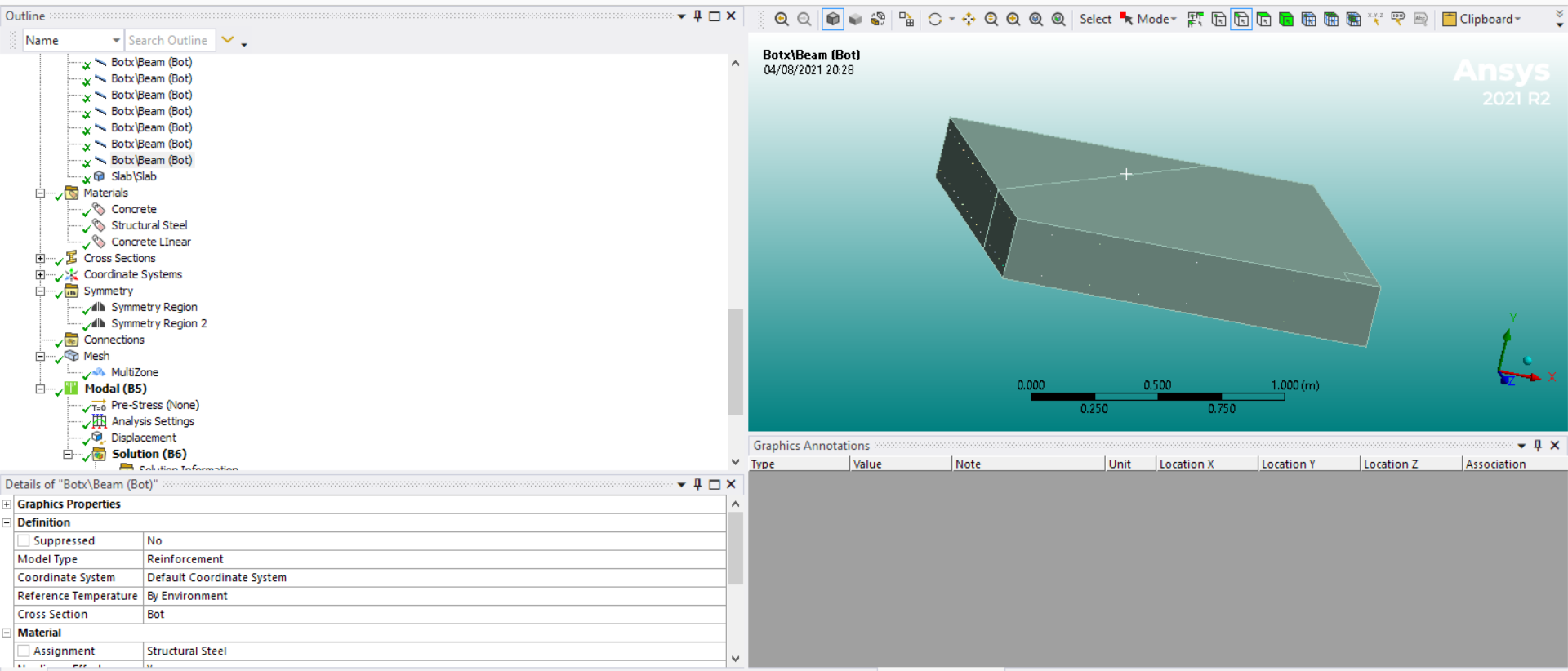

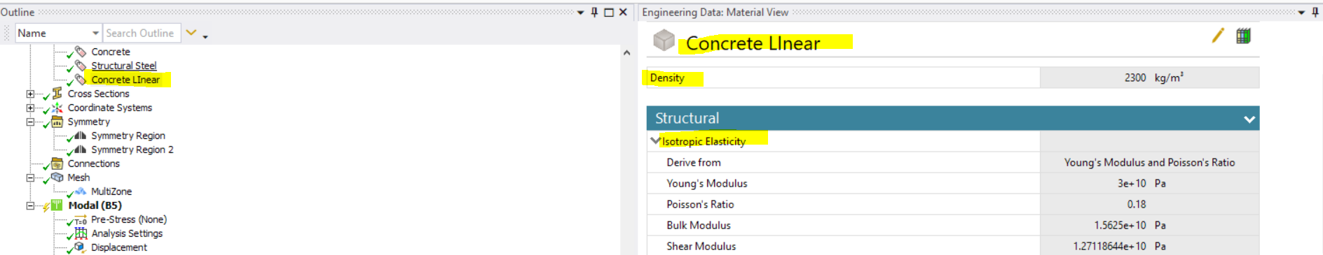

Reinforcement works with modal also - see below (same model as in link, but modal this time using reinf. on line bodies - of course we can only use linear concrete and steel properties, so only Young's modulus and Density should only be defined in eng. data, since modal analysis is a linear analysis). Also turn material nonlinear effects off (see last image) for all parts in order to avoid the error if you are using nonlinear materials in engineering data.
August 4, 2021 at 9:57 pmAugust 5, 2021 at 2:24 amAugust 5, 2021 at 6:04 amerik.kostson
As you see from the images posted above in previous post we used the latest release 2021 R2 - then it worked as shown above. You are using an older release - so you would need to download the latest student version.
