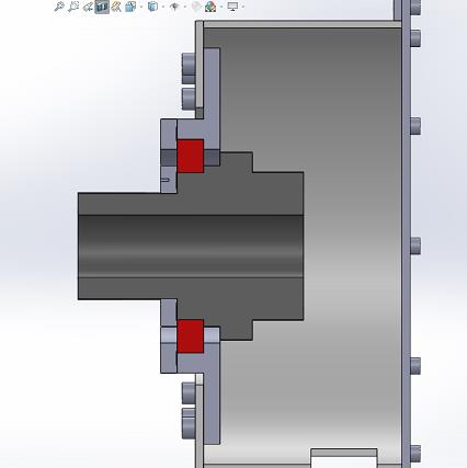

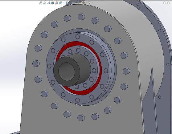

      I just want a static analysis, This is what I have:
      The red one is a bearing, a cross roller bearing, I modeled it as a flexible disk and assigned steel material, but since it is flexible, it deforms and produce too much stress. I just don't know how to solve this model.
      A solid red ring of steel would have higher stiffness than a cross roller bearing.

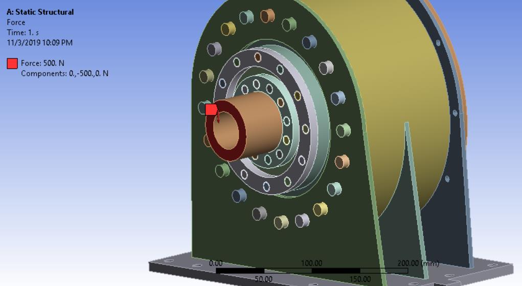

      Show an image of the stress and an image showing the mesh and an image showing the load.

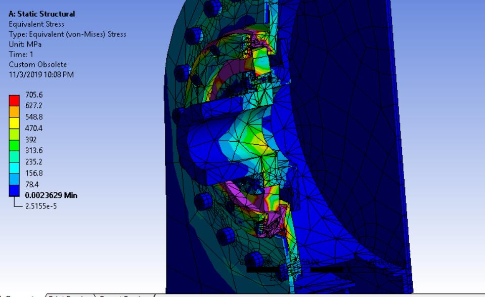

      I have applied pretension for bolts but it took too long so I omitted it, but when I use frictional contacts it shows me weird results, like 700 Mpa for equivalent stress only for 500 N force!!! Why is that? I have applied bonded only for welded parts and those that have thread for bolts (I don't remember what you call it ), I tried different friction coefficient but had no luck, here are some pics:

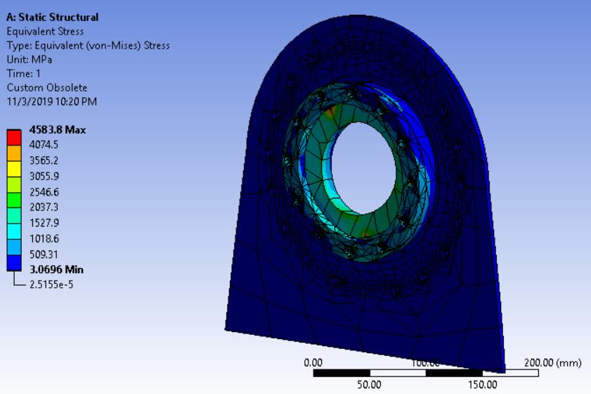

      I simplified the model, this is when all of them are bonded:
      And this is when I change bearing contacts to frictional:
      The light source in those views is on the right so surfaces of the model that face to the left are in shadow making it difficult to see detail. You could rotate the model to face to the right and they will have more light on them. Also if you change the color dark blue to light grey, that also makes it easier to see detail.
      You should use smaller elements around the locations where the high stress is observed by using sizing mesh controls on faces, edges, or Sphere of Influence to get more accuracy in the stress results after solving the model again.

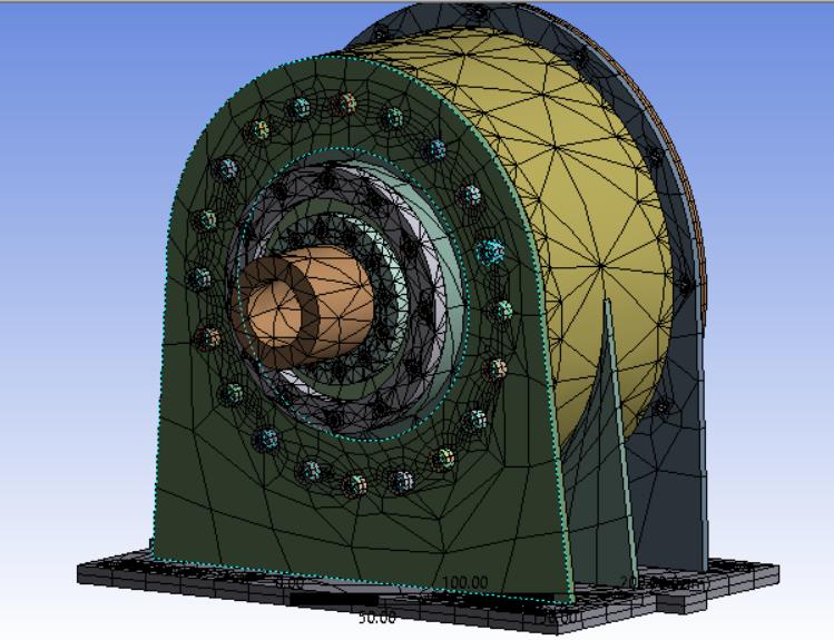

      Thanks for the tips, here is another image for the simplified model:
      But why is it 4813 Mpa when I use frictional, I tried smaller meshes but it's still too big, What am I missing?
      You still have a very coarse mesh. Look at the size of the elements around this bolt.
      You should continue to reduce the element size, but that could be a problem on the limited Student license.
      Do you have Student license or an unlimited license?
      Large elements and bonded contact can create artificial "hot spots" of stress.  This can be eliminated by using small elements and frictional contact.
