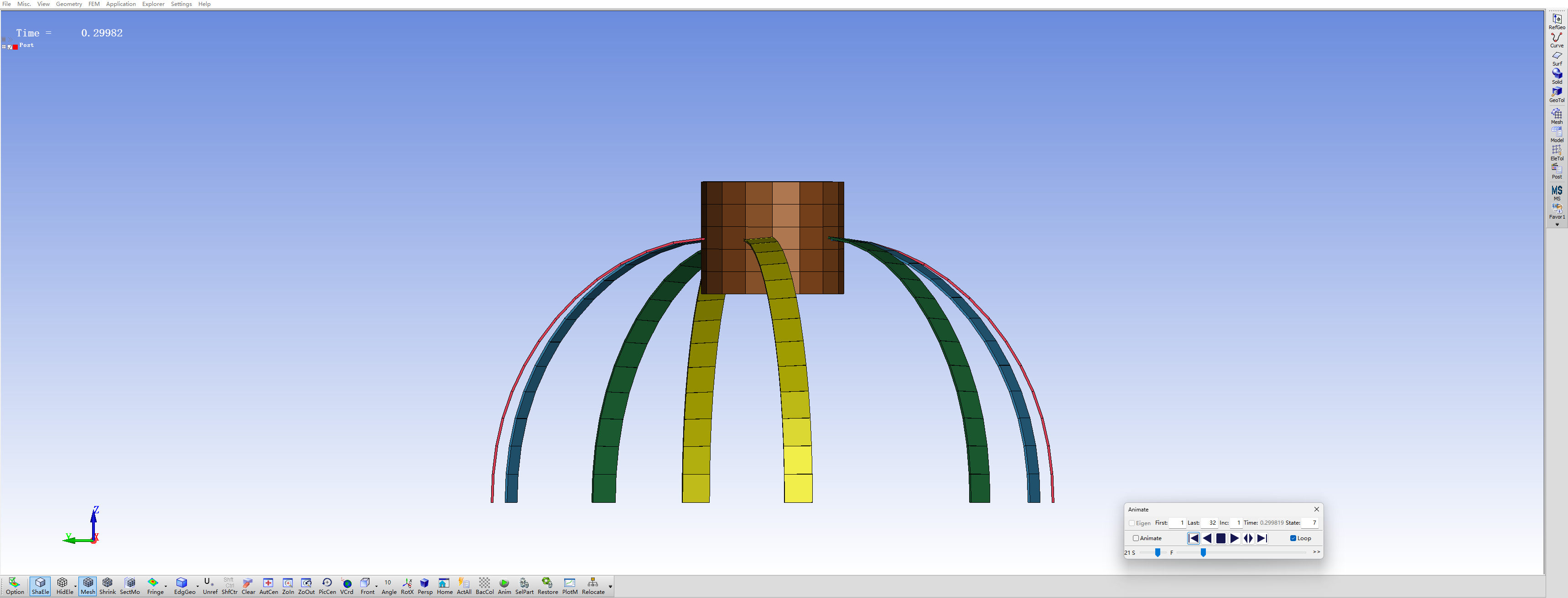

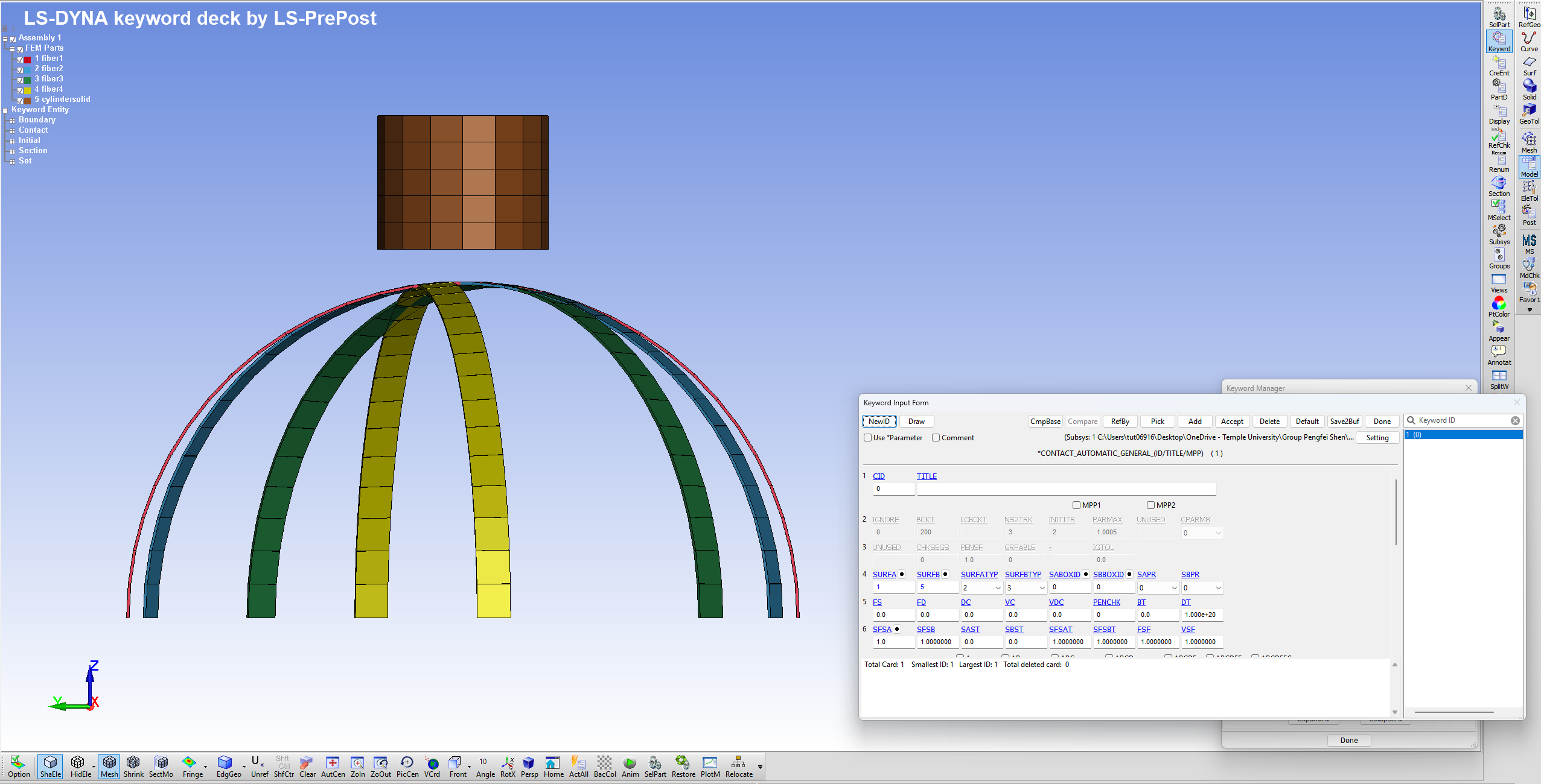

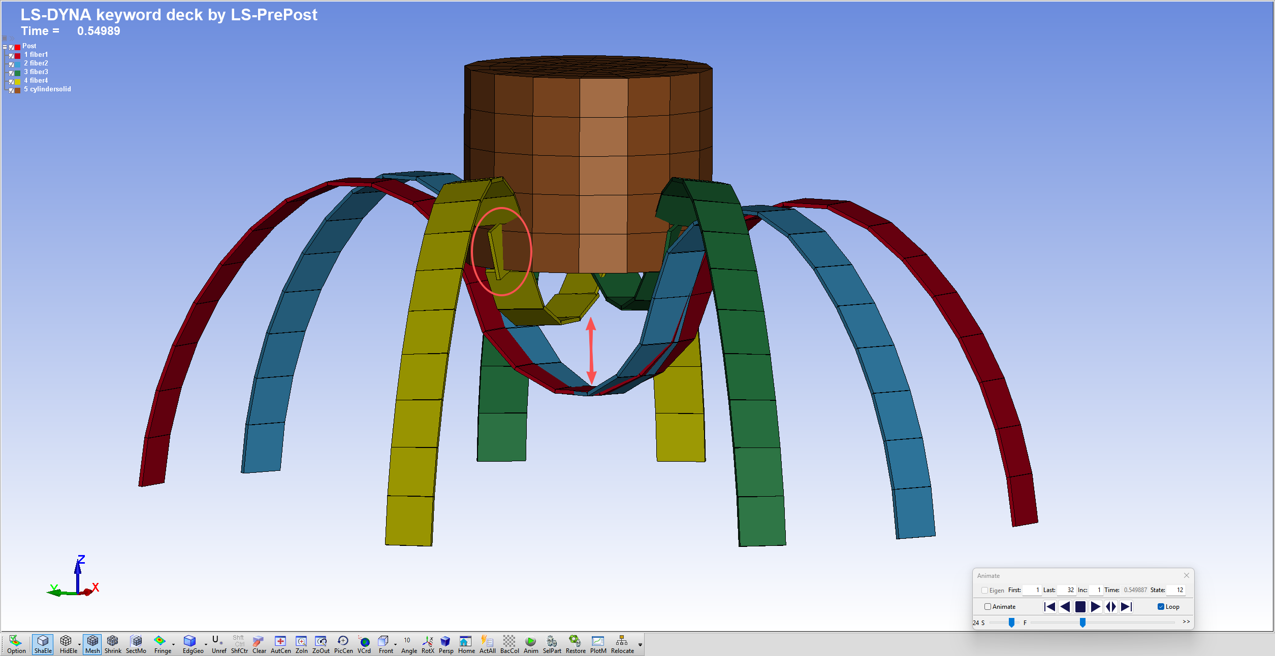

I created a dome composed of many beams and made a cylinder crash the dome. When I set the initial velocity as -30, the result looks good. But if I change the velocity to -60, there will be penetration between the parts. Does anybody know how to fix it? Thanks.
This is my .k file: https://drive.google.com/file/d/1gcOm7990HbWrbmrTTb4MAMjXJa-HI0xn/view?usp=sharing

I would use also 1 AUTOMATIC GENERAL for all contacts (works well between beams and solids and between beams)
All the bestErko

SubscriberI tried CONTACT_AUTOMATIC_GENERAL between beams. But it doesn't work. There still is model penetration if I make the velocity bigger. I posted my .k file. Could you please take a look. Thank you so much.

February 27, 2026 at 3:25 pm
ErKo
Ansys EmployeeAs I said Ansys empl. can not download or run models . Perhaps others can run the model.
I would suggest to just take away all contacts you have above and use only this one (so you should have only one contact card):
*CONTACT_AUTOMATIC_GENERAL
$# cid title
$# surfa surfb surfatyp surfbtyp saboxid sbboxid sapr sbpr
0 0 5 5 0 0 0 0
$# fs fd dc vc vdc penchk bt dt
0.1 0.0 0.0 0.0 0.0 0 0.01.00000E20
$# sfsa sfsb sast sbst sfsat sfsbt fsf vsf
1.0 1.0 0.0 0.0 1.0 1.0 1.0 1.0Also perhaps reduce the time step a bit:
*CONTROL_TIMESTEP
tssfac
All the bestErko
PS: See here for more info on general contact:
https://innovationspace.ansys.com/forum/forums/topic/ls-dyna-beam-nodes-contact/-
February 27, 2026 at 3:59 pm
February 27, 2026 at 4:05 pm
ErKo
Ansys EmployeeI hope my respond was very clear. Again below:
I would suggest to just take away all contacts you have above and use only this one below (so you should have only one contact card):
(see the surfatyp surfbtyp = 5)
$# cid title
0 0 5 5 0 0 0 0
Here is anyways some general posts on contact between beams and solids:
Also reduce the time step a bit – insert this this card:
*CONTROL_TIMESTEP
tssfac set to 0.9 perhaps
Perhaps other forum members can run this and let you know if they have some feedback.
All the best
Erko-
