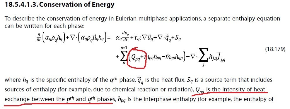

March 2, 2022 at 3:14 pmkhbang1958
The above is a screen shot of the energy equation for Euler multiphase model (Ansys v. 2019)
I marked a red circle on Q_pq, which is heat transfer between phase p and q.
Q_pq can be written as a form like Q_pq = H_pq * (T_p -T_q). It is given in the Theory doc., but I can not locate it at the moment.
Here H_pq is overall heat transfer coefficient between p and q phases.
Without mass transfer, H_pq can be simply defined by two-resistance model.
With mass transfer, however, the phase change rate can be determined by the net heat transfer rate to the interface of p and q.
And H_pq must be defined with consideration of mass transfer at the interface.
My question was that the Fluent manual does not provide the expression for H_pq for the case of mass transfer.
Thank you very much for your kind support and hope to hear more from you.

SubscriberDear Rob:
Thank you very much for your advise. I looked at the recent Fluent Theory Guide of 2022/R1, but still the answer to my question is up air.
Let me please summarize my question based on the 2022/R1 Theory Guide.
My task is that I have a pool containing a mixture of 120C liquid and 110C steam at 1 atmospheric pressure (T_sat = 100C).
I want to calculate transient behavior of this pool using Fluent's Eulerian multiphase flow model. The energy equation is
Here, my question is what is the model for Q_pq (red circle) when mass transfer is modelled.

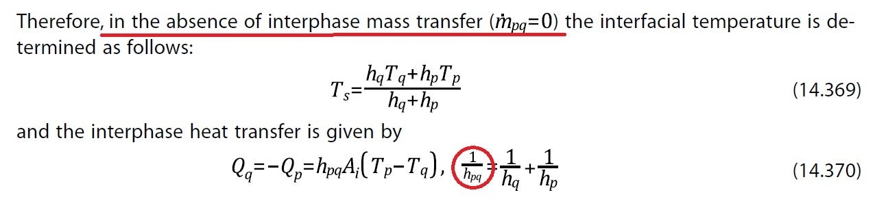

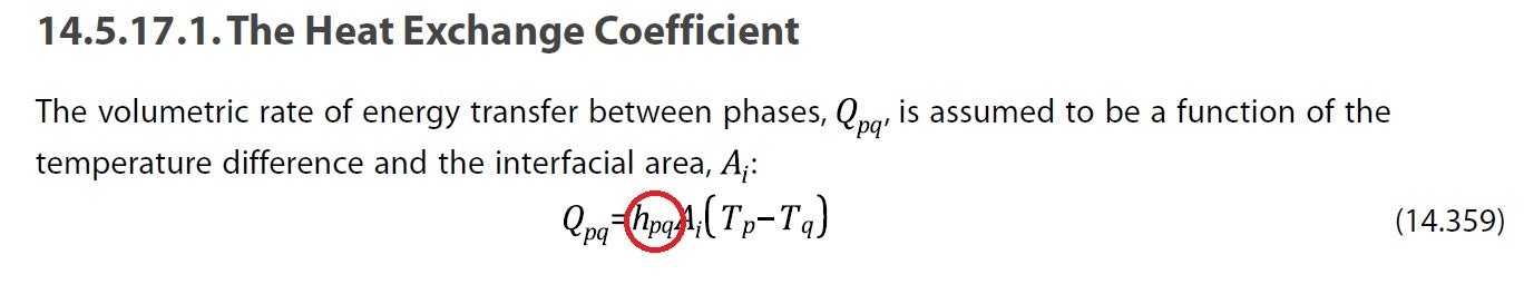

In the 14.5.17 Description of Heat Transfer, the Q_pq is defined as
I chose thermal phase change model.
So I must select two-resistance model for h_l and h_v for heat transfer to work with thermal phase change model.
Now I am interested in how h_pq is calculated in this case. The Theory Guide only tells the case for no mass transfer as below.
My question is how to model h_pq when there is mass transfer.
Thank you.

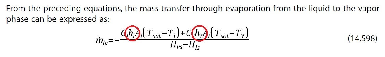

SubscriberThank you for the comments. Let me take a simple example with a hope to clarify my question.
If I have a mixture of 120C water and 90C steam (metastable) at one atmospheric pressure, the heat transfers from liquid to interface (100C) and also from interface to steam.
(I think the Eulerian multiphase model should allow the metastable state of any phase.)
If I choose two-resistance model and thermal phase change model, the evaporation rate is computed by the net energy (heat from liquid to interface minus heat from interface to steam).
Then, what should be the heat transfer coefficient "between the liquid and vapor," h_pq, which is included in the energy equation of Eulerian model?
I think the zero-resistance of one phase or fixted-to-sat-temp model can be an option but it violates energy conservation because it forces to set the phase temperature to saturation temperature.
As Rob said, if my question is beyond the matter that can be discussed in this public domain, I will stop, but hope to continue to exchange comments on this matter in alternative way if possible.
Thank you.

SubscriberThank you for your kind comments.
Now let's say I choose h_p for p phase and h_q for q phase as you suggested.
Then what is the expression for h_pq, which appears in the energy equation.
As you know, 1/h_pq = 1/h_p + 1/h_q is valid only for no mass transfer.
You mentioned earlier that h_pq is not used, but I think it should be defined if T_p, T_q, T_sat are different each other.
Thank you.
March 9, 2022 at 8:22 amDrAmine
Ansys EmployeeSometimes writing documentations one should stick to very general/multipurpose formulation is not always simple to fulfil all model variants.
For every phase energy Equation we have a Q_alpha which is the heat transfer to that phase. That Q_alpha is equal to Gamma*Latent_Heat+h_alpha(T_alpha-T_sat) when using Thermal Phase Change Model.
March 9, 2022 at 10:25 amkhbang1958
SubscriberThank you very much for the comment. I guess this is what I have been looking for.
My original question arose when I was wondering about the expression of h_pq in case of phase change.
Sometimes it is easier way to write h_p*(T_p - T_sat) instead of h_pq*(T_p - T_q) when thermal phase change must be considered.
But the solution procedure could be quite different because the earlier has only one unknown T_p in the source term part, but the later has two unknown, T_p and T_q.
I think I get the answer so I will stop hear.
I greatly appreciate your kind comments for many days.
