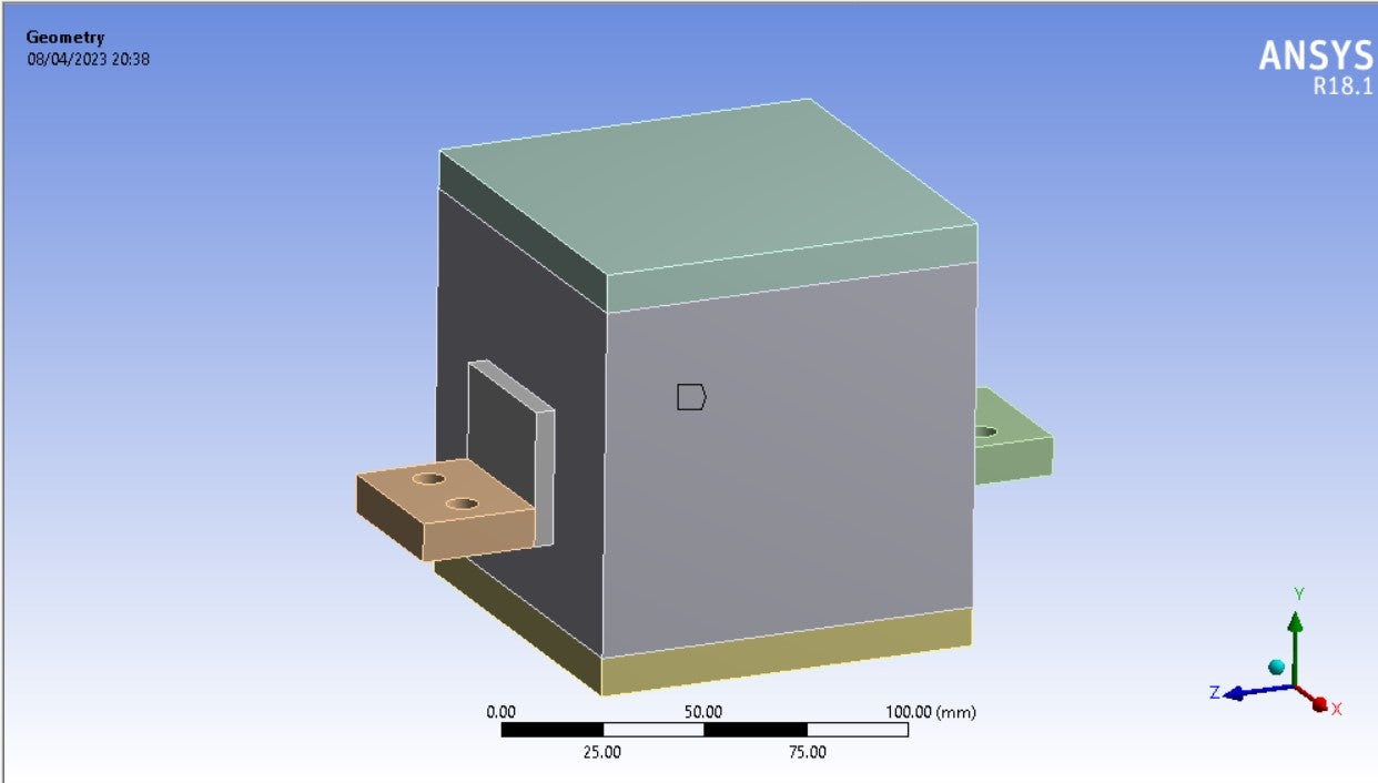

      I have done a modal analysis of a container in which a fluid is considered as a point mass. This point mass is defined using free standing remote point. Free-free modal case is considered. After calculation for 20 modes, I find out that 6 modes are zero and additional 7th, 8th and 9th mode frequencies are almost zero. Why the 7th, 8th and 9th modes are also zero when first six modes capture rigid body motion? Following are the snapshots of the analysis.
      1) Geometry

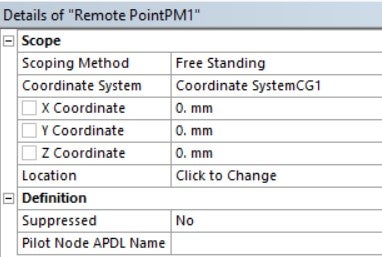

      2) Remote point

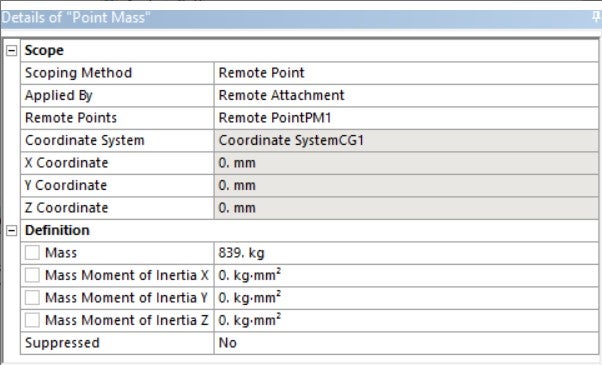

      3) Point mass

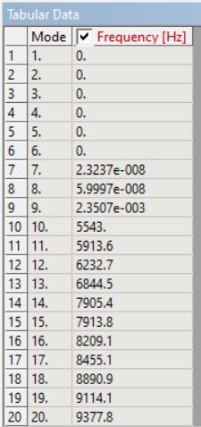

      4) Mode and frequency

      The first six modes are for the solid body assembly, the next three modes are for the free standing remote point. The free standing remote point has only 3 modes because it has only mass and no moment of inertia. If you add moments of inertia, there will be a total of 12 zero modes.
      A free standing remote point is not adding a fluid mass to the structure.

      Thank you for your prompt reply. The liquid is enclosed within the container and not submerged in liquid. So, can you suggest any solution to model fluid as point mass? Also had a doubt regarding point mass. Point mass with no mass moment of inertia and only mass has 3 modes zero, while point mass with MMI has 6 modes zero. Can you elaborate on this point?
      Hello Rohan,
      Add a solid body inside the container to represent the fluid. Use shared topology so the fluid is connected to the container. Assign a fluid material to the body. Mesh the fluid body. What element shape was created?  If Quadratic Tet elements, assign FLUID221 elements to that body. If Linear Hex elements, assign FLUID30 elements to that body. Solve the model using Modal Acoustics. Does the fluid completely fill the container or is there a free surface?
      A point mass with no MMI causes the node to have only 3 translational DOF while a point mass with MMI causes the node to have an additional 3 rotational DOF.
