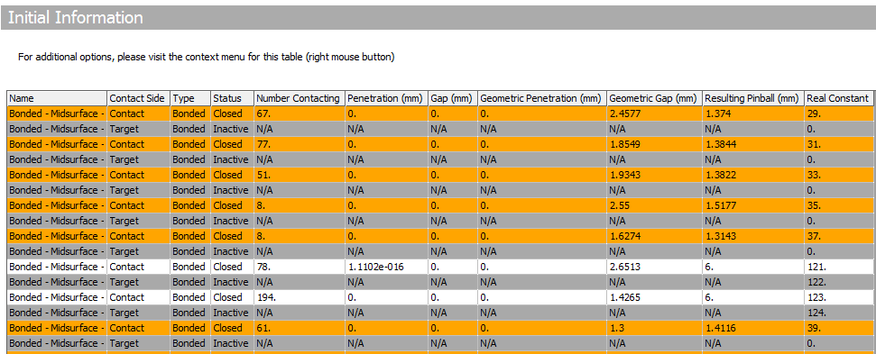

I am trying to do a modal analysis for a welded structruce by using shell elements. I have a lot of assembled bodies in my model and I defined bonded contacts for the welded sections because I will only do modal analysis. I defined each contact myself by manully, I choosed MPC method, I had zero freq problem If I choose this settings as program controlled. I let the program define pinball radius.
After first solve I saw some absurt contacts in the modal shape animation and defined the pinball radius by myself for these parts. It seems ok when I checked the information. Also I dont see any penetration in my contact tool.Â
