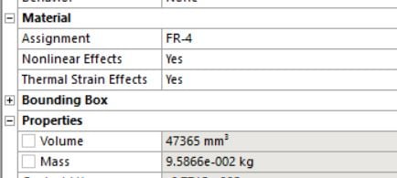

      3) What is the mass of the model reported by ANSYS in the Details window when you click the body?

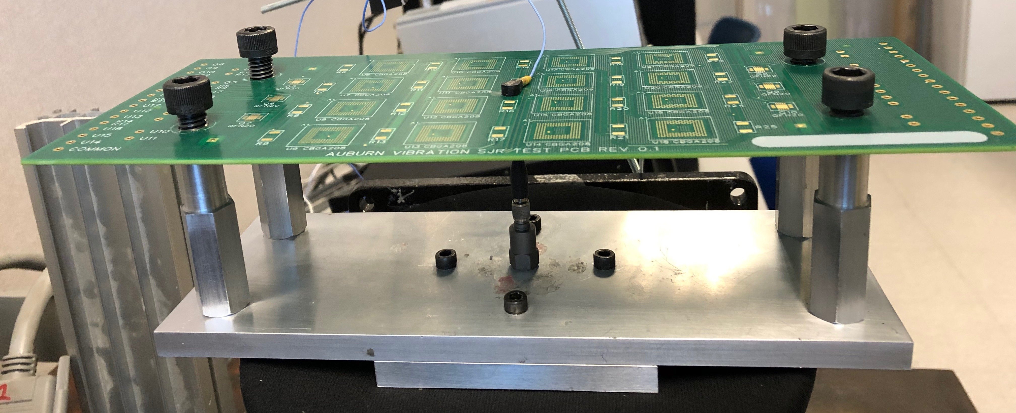

      4) What does the fixture look like that fastened the PCB to the shaker table?
      5) Make an ANSYS Modal model of the fixture without the PCB, what is its first natural frequency?

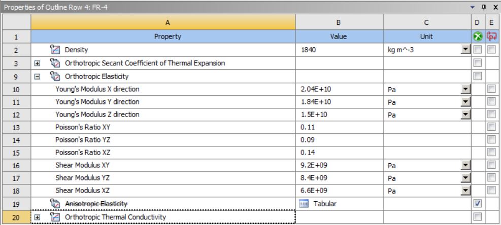

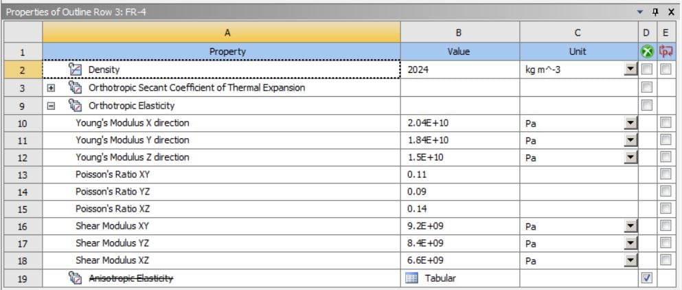

      6) Show the material properties for FR-4 and say which component is through the thickness and which is in-plane.
      7) Why anisotropic and not orthotropic material?
      7) How was the first natural frequency experimentally determined on the shaker?
      8) The geometry of the PCB should be a surface that is assigned a thickness in Mechanical, not a solid.
      9) When you use shell elements with orthotropic materials, you need to override the element coordinate system.

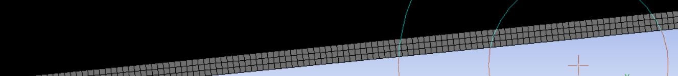

      10) If you used a solid model, please show the mesh. There should be at least 2 elements through the thickness.

      2. 97.3 g.
      3. 88.09 g.
      4. Please find attached image. The board is normally rigidly fastened on the vibration platform. (Image only for reference)
       Board mounted on fixture
      5. Previous studies have considered only the board for modal analysis, and not the fixture. Should I still go ahead and analyze the fixture?
      6. Please find attached.
      FR4 Material Properties

      10. Please find attached.

      2) If the model mass is 88 g but the part mass is 97.3 g you should multiply the density of the material by 97.3/88 to get the model mass to match the physical part.  What is the mass of the accelerometer?  You can add a point mass at the center if you slice your model with two planes to make an edge through the thickness to attach the point mass to the center of the board.
      6) Do the material axes correctly correspond with the orientation of the sheet in the global coordinate system?

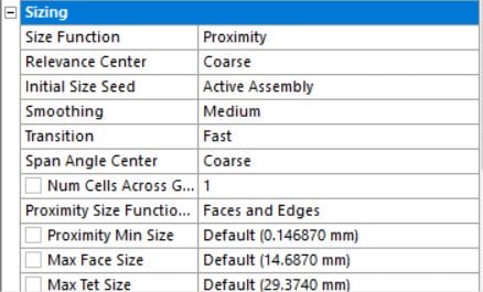

      7) We used a laser vibrometer to measure the response signals and the first 4 natural frequencies were at 118 Hz, 326 Hz, 491 Hz and 627 Hz whereas with FEA, the first natural frequencies are at 110 Hz, 160 Hz, 299Hz, 369 Hz, 394 Hz and 399 Hz. The displacement at 118 Hz from experimental technique was at 0.103 mm whereas the displacement at 110 Hz from FEA technique is 6.41 m which is extremely high. I'm not sure the software gives a Q value but we did a search and dwell test to find the natural frequency with a Q factor of 10.
      I wasn't able to compute the data with Num Cells Across Gap = 2, instead I used a value of 1. With the former value, I was receiving an error message due to long time duration taken to process the data.

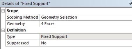

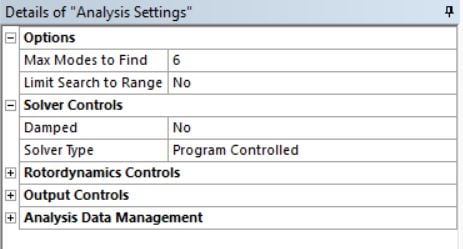

      I have a query regarding the analysis results (please refer attachment – analysis results). The first 4 natural frequencies obtained on FEA technique was 112, 162, 305 and 374 Hz, whereas the experimental technique produced 118, 326, 491, 627 Hz as the first few natural frequencies. All the properties considered – material properties, analysis settings, fixed support, mesh sizing have been attached for your reference. In order to get the values closer to the experimental technique, what properties do you reckon I can try modifying?
      Analysis resultsAnalysis settingsFoxed support constraintMaterial propertiesMesh sizingPart properties in modal analysis tool
      The first mode has good agreement, but the second mode does not.  The reason may be because the second mode has a vibration node at the center of the board where the accelerometer is mounted, so that cannot see the second mode.  The third mode has some displacement at the center so the modal result of 305 Hz is compared with the experimental 326 Hz.
      The modal frequencies are a little low, so you could increase the thickness of the board in the model slightly to increase the stiffness and raise the modal frequencies. Another way to add some stiffness to raise the modal frequencies is to increase the size of the circle where the fixed supports connect the PCB to the shaker table. If the PCB geometry has the hole the fastener passes through as the fixed support, increase the hole diameter to equal the standoff or the washer or screw head on the top.

      Per your suggestion, I increased the hole diameter to match the screw head along with slight increase in the thickness of the board. During this process, density of the board was modified accordingly to match the mass of the PCB. Results obtained are attached:
      Also, to obtain the Frequency Response Function, an accelerometer wasn't used in the test, instead a laser vibrometer was used. Hence, I am able to comprehend why there would be difference starting second mode of the structure. Is there any other factor that is required to be incorporated?
      It looks like you have fairly close agreement between the experimental and modal frequencies now.
