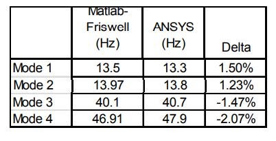

      I am performing a Modal analysis of a Rotor Bearing system.
      I did the stability analysis by writing my own fem formulation code in Matlab and got the eigenfrequencies and the mode shapes.
      Then I performed the Modal analysis using APDL, and the results were in close agreement screenshot attached below.

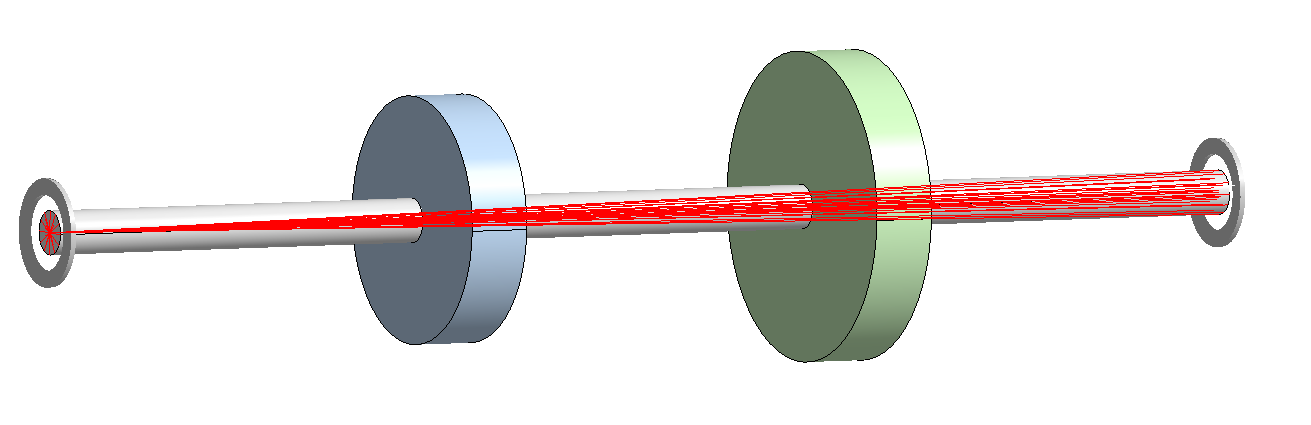

      Finally, I did the simulation in Workbench for the same setup and boundary conditions by assuming the solid shaft as a beam element, but the results didn't match.
      The problem is that my main setup is quite complex, so that I will be using Workbench; therefore, I was first validating the result for a simple setup, but it did not match at all.
      I request ANSYS staff and the users who have worked on such a setup to look into this.

      Not sure about the comment above regarding beam elements, there is no command snippet required to use beam elements.
      It appears you have a connections folder with contacts populated in it. I would not model the connection between the solid rotors and the beam elements using contact (if that is what has been done), but in general connecting beam elements directly to solid elements is not ideal. I would recommend using a solid shaft if you are using solid rotors.
      Assuming your boundary conditions are correct, this is the only thing that is different between the models.

      - I again performed the simulation considering the shaft as a solid. I got the following results.
      I don't know where things are going wrong. In the case of Beam formulation, I think you are right contacts are the real problem.
      But why considering the shaft as a solid body not giving similar results.
      I am attaching the workbench files.
      - I tried doing that, but it is giving some weird modes, and the answers are also not matching.
      Simulation Files:
    • BenjaminStarling
      You have a remote displacement scoped to two faces. A remote displacement, as it's name implies, creates a remote point which is constrained to it's scoping. In this instance this constraint is changing the stiffness of your structure. You can either apply two remote displacements, one on each face, ensuring the remote point is in the centre of each face (I did this and got 14 Hz for the first two modes), or use the displacement and fixed rotation boundary conditions.
      You can visualise spiders/constraints by selecting solution information, then changing to the geometry tab at the bottom of the main window
      You also still have contacts to connect the shaft to the rotors. I would recommend using a conformal mesh, contacts introduce additional stiffness that can be difficult to account for.

      same issue with your beam model
    • shubhamop20
      Thanks a lot, sir problem is solved. Also, I slightly reduced the contact stiffness and got accurate values, as you said.
