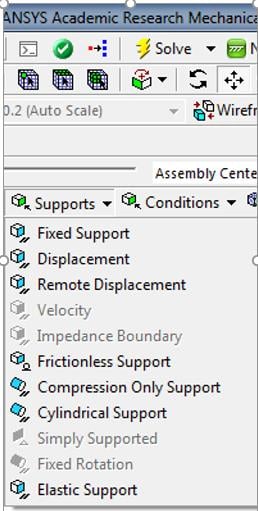

And I'm using workbench 19.1. The type of support that I see here are as follows.Â
 I'm afraid I won't be able to share the archived project at this moment.Â
Thanks for your time again !Â

Actually, a Bearing is created under the Connections folder, like Joints and Springs. I misspoke when I said it was a support.

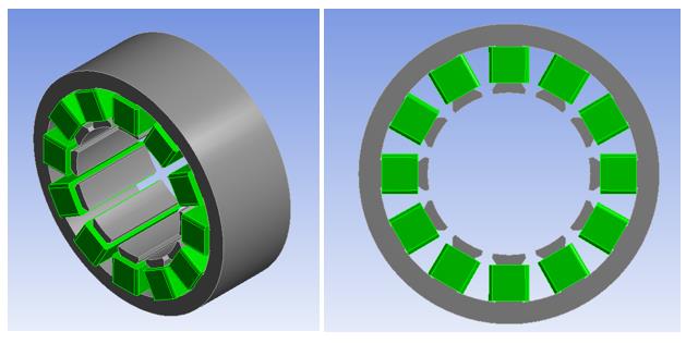

How did you model the windings of the stator? Would that introduce more stiffness than reality? Sorry, you mention it is 160 grams but it doesn't help my understanding given I don't know the mass of your stator.Â
Removing the sheet metal around it would affect the modes but depending on the contributing effective mass, the error should be small. What is the mass of the housing and stator? I would suggest first testing only the stator with it's windings free-free and compare it to your model. Please see this paper on discussion on experimental supports. In simulation, free-free means no fixed boundary condition yielding six rigid body modes with natural frequencies close to 0Hz.

This is how the winding (Green part) is modeled. the stator is around 600 g. Housing is about 650 g.
Thanks for the paper. I'll start going through it right away. and will do the free-free simulation as well. Once I've the results I'll reply to the same discussion thread and will let you know.Â
