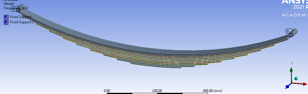

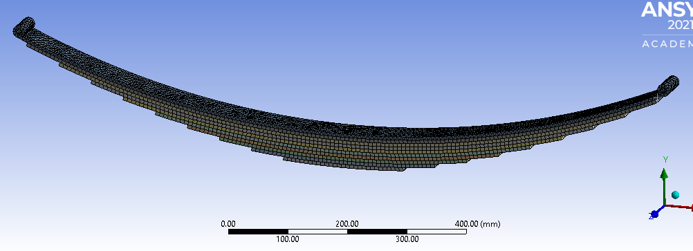

      i am doing my project using a multi leaf spring. I have done modal analysis to obtain the natural frequency, and i also have done an accurate theoretical calculation to find the natural frequency for first four modes. my issue is that the percentage of difference is very high when i compare theoretical results to FEM ansys results. I am not sure what causes the high percentage difference. i have followed the boundary conditions exactly. but cant get less than 10% percentage of difference most is 30% and more. what might affect my FEM simulation results. for meshing i have done sizing only at 7.5mm

      1) source is based on an article where they did theoretical/ ansys simulation for leaf spring. and the percentage of difference is less than 10% for first 3 natural frequency (fixed ends)
      2) using Euler's equation to find the natural frequency

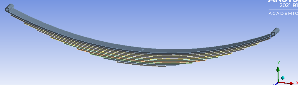

      3) i have modeled the leaf spring using solidworks my leaf spring consists of 10 leaves so i modeled each leaf separately and then did assembly, then saved as .IGES
      4) the connections are bonded between each leaf
      5) solid elements
      6) neither
      7) i dont know how many elements
      i am using ansys student version and i am not that advanced when it comes to meshing
      below is the formula used, model, meshing, results
      based on theoretical calculation results of natural frequency is f1 = 90.9Hz, f2 = 250.4 Hz, f3 = 491 Hz
      thank you

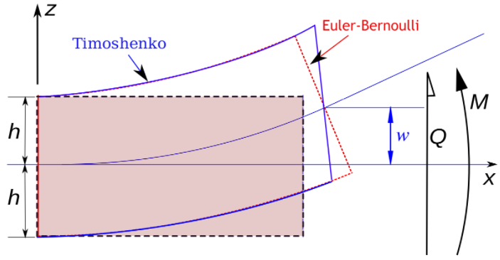

      Comparing a theoretical equation result with an FEA result is useful, but you have to consider the fact that the equation contains simplifying assumptions. For example, an FEA solid model is computing shear deformation while an Euler-Bernoulli Beam equation ignores shear deformation. A physical beam in an experiment has shear deformation but for long slender beams in bending, the shear deformation is negligible.

      , Euler-Bernoulli beam theory also has an assumption that the cross-sections along the beam always remain perpendicular to the neutral axis. But in reality, there are no cross-sections of any beam. So what is the importance of this assumption?
      Cross sections perpendicular to the neutral axis can be physically drawn on the side of a straight beam with a pencil. The more modern approach would be to spray a pattern of dots on the side surface. When a short stubby beam has a load applied, it can be observed and measured that the lines that used to be perpendicular are no longer perpendicular due to the deformation of material in the beam.
      In an FEA model with nice square hex elements, the nodes can be arrayed along the neutral axis and along lines perpendicular to that. When the deformed shape is plotted in a nonlinear analysis with large deflection on, it can be observed and measured that the lines that used to be perpendicular are no longer perpendicular.
