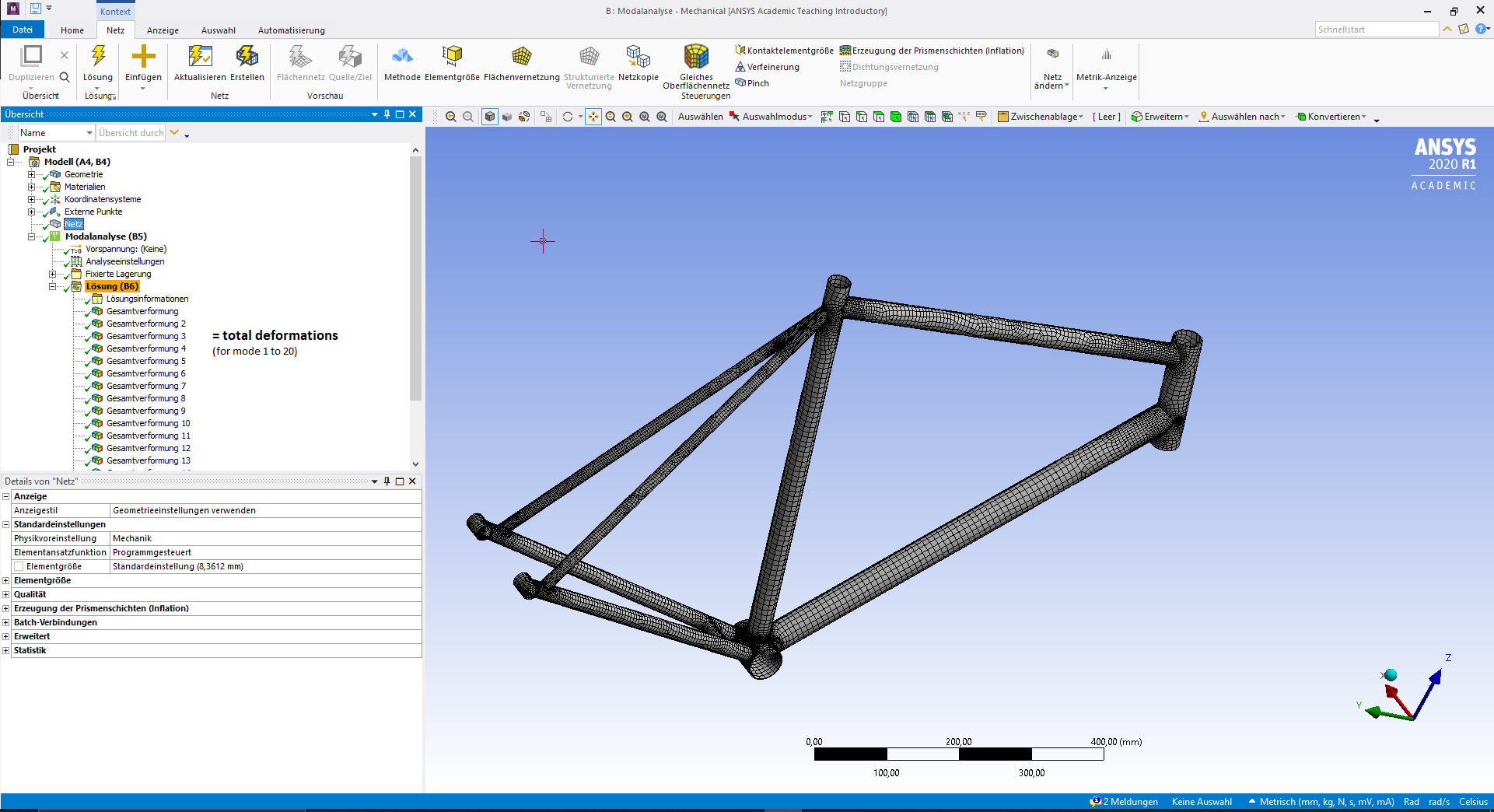

August 9, 2020 at 11:01 am
ReneSe
n
nHere are some pictures. I hope they help.nIn the second picture you can see the additional command I set. Also tried it in the ds-file.nnHow can I use a command to normalize the deformation to a unit value? (I think you mean like for the thid picture where there is shown the deformation of the first mode? Isn't this in milimeters?)n
August 9, 2020 at 12:29 pm
August 9, 2020 at 1:22 pm
ReneSe
SubscriberThank you, that definetly changed the outcome.nBut where do I find the eigenvector-matrix now?n -
August 9, 2020 at 4:58 pm
peteroznewman
SubscriberTotal Deformation plot is the eigenvector for mode 1 frequency.nTotal Deformation 2 plot is the eigenvector for mode 2 frequency, etc.nYou can export the X,Y,Z deformation of every node from the plot, that is your matrix.nYou will also want to export the X,Y,Z coordinates of every node also.nn -
